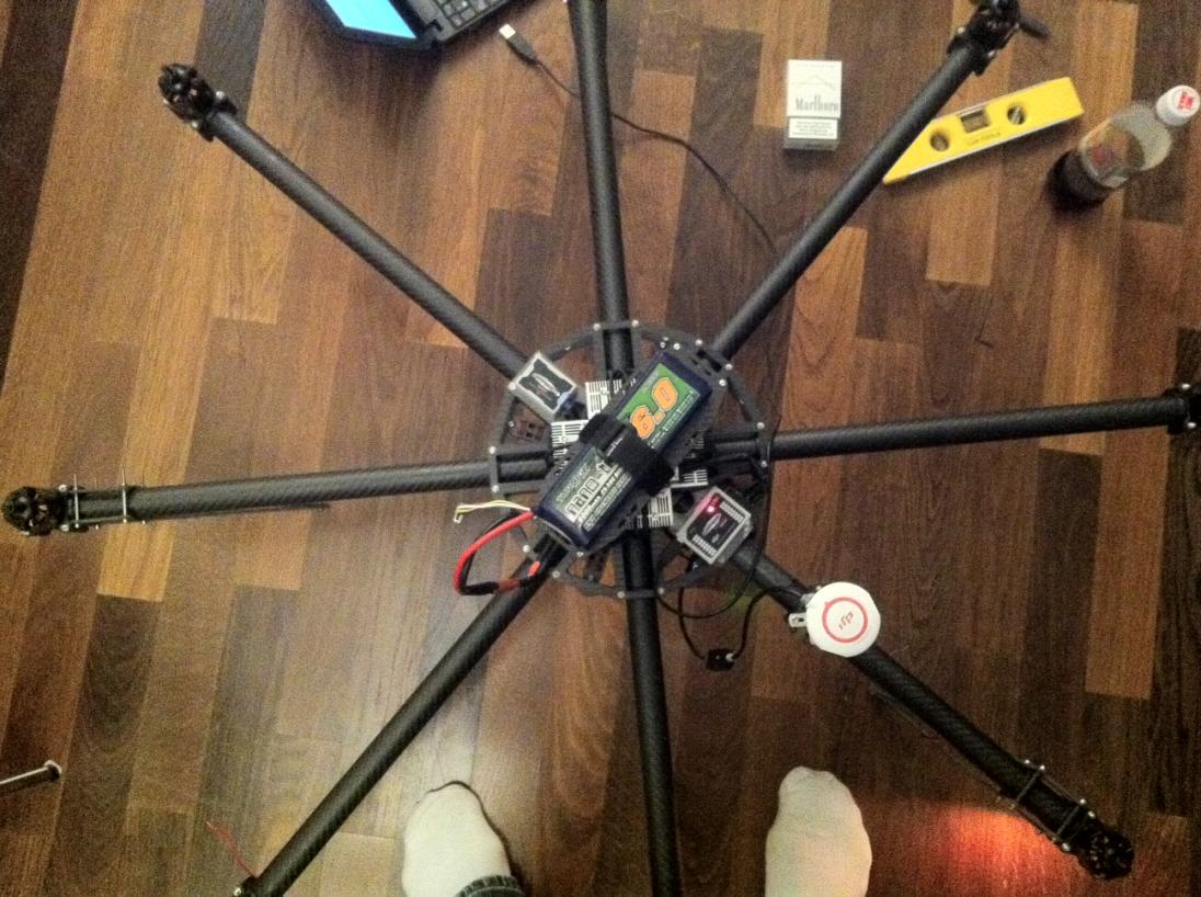

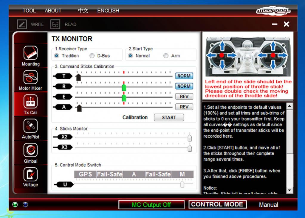

BorisS
first test hover of in the flat, well second test hover. First the bird nearly crashed into me since i didnt have the foward back ward stick set to norm nut rev in the tx setup. Nearly sheided in my pants.
Getting fast yellow flashed on the LED but dosent look like the voltage warning or i am mistaking. Gotta check that.

BorisS
more stable than the HEXA WKM flying inside in its own turbulences. Lets see how good i hope this gets.
