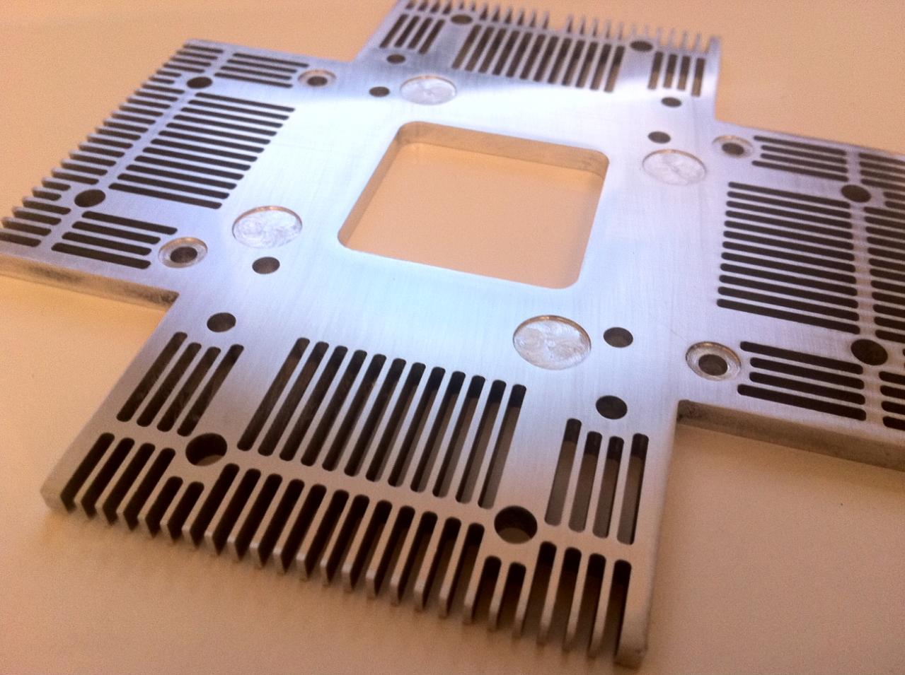

now we are talking shiny and smooth and no more finger tip :)

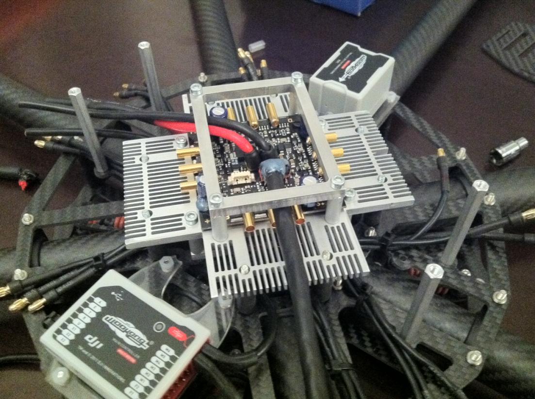

spend the whole day to fix up the herkules ESCs to finally get them on the heatsink and get the Lipo cables soldered on, rethinking it a thousand times.
Tomorrow the ESCs cables have to be finished and connected to the MC and than its good for a test spin up.

Im also planning on building cs8, got all the parts and frame... but your build log is far most best i have seen, very inspirational, to bad i won't be able to make one just like yours...

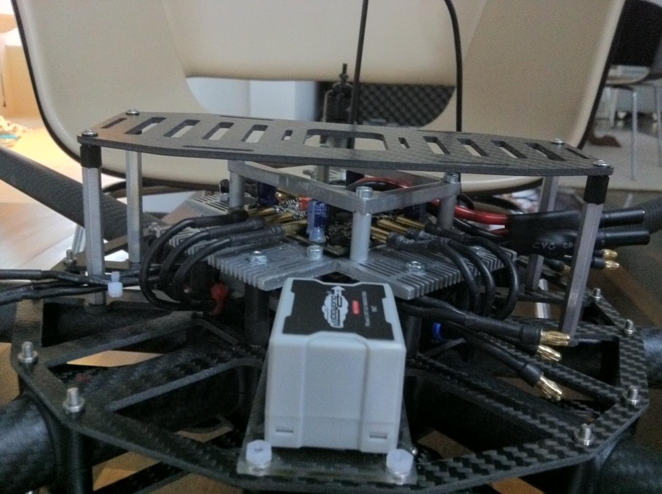

Boris, how close to the battery plate is the top of your electronics stack? Is the clearance fine? I had to buy longer aluminum hex standoffs to accommodate the total height of the MK FC/NAV & SE OSD boards.
With the heat sink and that roll bar you have very good protection for the ESC's. Nice.

Same thing here i used some plastic spacers, for the moment. I want to have a different solution though not sure yet what i am going to do.

Looks good Boris, I am sure the lapping will make a couple of degrees difference. Have you flown it yet? How does the Herkules board handles?

@rrhood japp i have a good feeling with this and final feeling back in my fingertips after having applied the lapping to the whole plate :)
