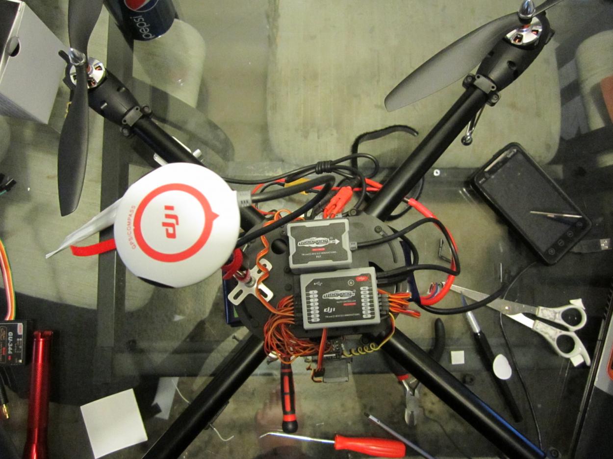

Awesome build Boris. Any chance at you making more of the mounts for the wkm IMU and main unit? Cinestar needs to sell a wkm and a mk version with the mounting options.
BorisS
Twister I can make you some free of charge, since these parts really don't cost anything. You have to consider though that these parts only make sense if you centralize the ESCs like it did with the herkules. Otherswise you would probably mount the single ESCs there were I mounted the IMU and MC.
Its going to be 1 to 2 weeks since am just starting to make a ground station box and than i will get pieces cut again were i can add these plates to the queue.
Boris
