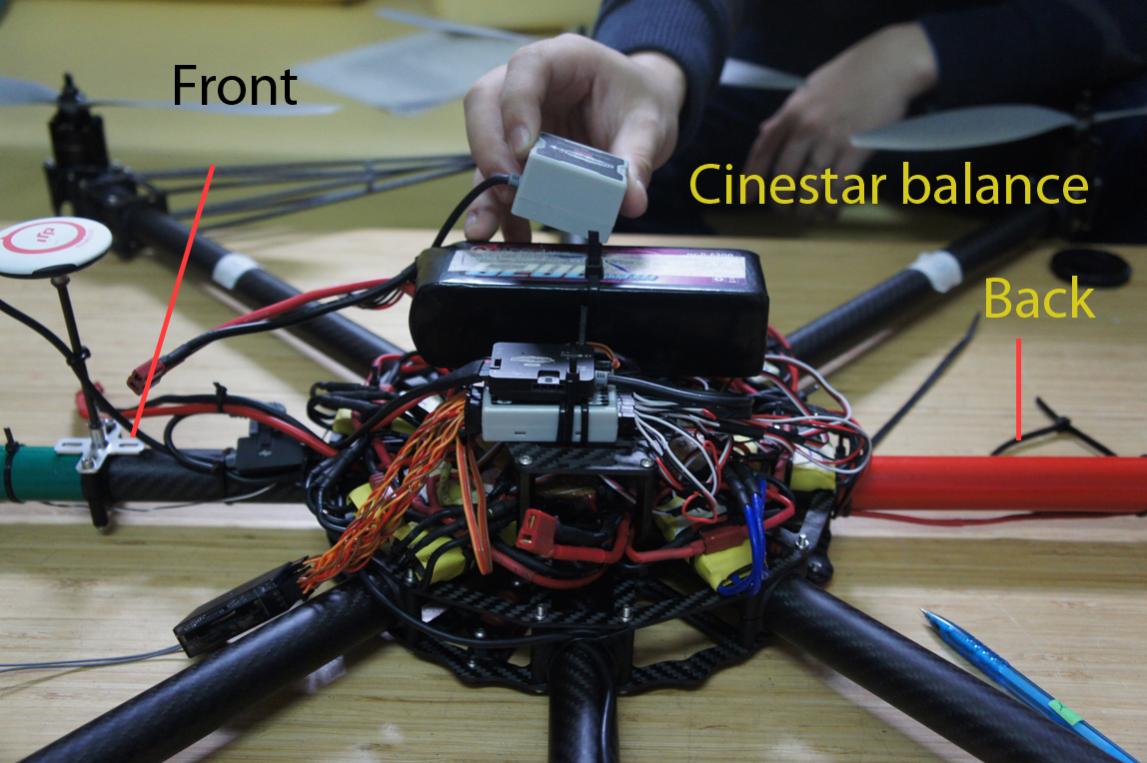

Hi Boris,
I now done with the wiring and setting up my Futaba 8 and sb6028 with Cinestar8 however I just can't fly because when I start the motor the Cinestar will pitch/nick backward strongly and make the cinestar to turn up side down :(
I have checked my wiring: ESC to MC, RX to MC; spinning of motors; propellers set up; and my TX channel however everything is fine and execute correctly.
I myself think that if the motor has spinned correctly, the cinestar must balance and if it is not in my case, it must related to the setting of channel in my TX so I tried to reverse the elevator channel in my TX several times however the problem still persists. I notice that only when I push the elevator stick forward to maximum the cinestar front & back boom will balance with each other and if I move the IMU and make it tilt back, cinestar will balance :(
Have you got similar experience and what was your solution ? Am I right to conclude that this is due to the wrong calculation of COG ? or it is just the wrong setting in TX ?
Before I post the question, I have spent hours and keep searching in the forum to find out the problem however may be I not type the right key word or my knowledge on this field is limited so I would like to seek support from you guys.
I am really looking forward to hearing from you.
Cuong
View attachment 3315View attachment 3316
I have remounted the IMU to center and recalculated the COG however it still does not solve my problem. The cinestar still nick backward :(
Also double and triple check your motor allocations and make sure your TX channels are going in the correct direction
Hi All,
Thanks to Munk topic, I have rechecked my ESC and divided it into 2 batchs (4 ESCs each batch), then I assembly each part to Cinestar to make a quadrocopter. Then I start the motor to see whether the problem still there ? The first batch, the problem still persist; the second batch, it has all gone and cinestar excecute correctly.
It must be the ESCs that makes my cinestar unbalance :(
Thanks alot for your support, it makes my life more easier :))
