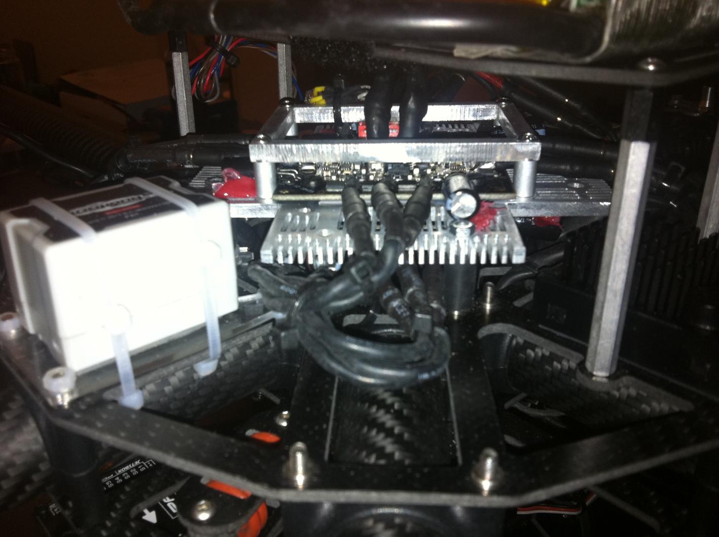

Okay date is set. This friday we are going to do some testing in Regensburg with Andreas ! Andreas is setting up some equipment to take a closer look at what WKM is putting out over its ESCs ports.
Everything is ready to go hope the weather will be with us and nothing stupid happens until friday with the CS8. Just like two days again when my cleaning lady knocked my hexa from the table :) Luckily with not gear on only frame and motors :)View attachment 2577View attachment 2578
