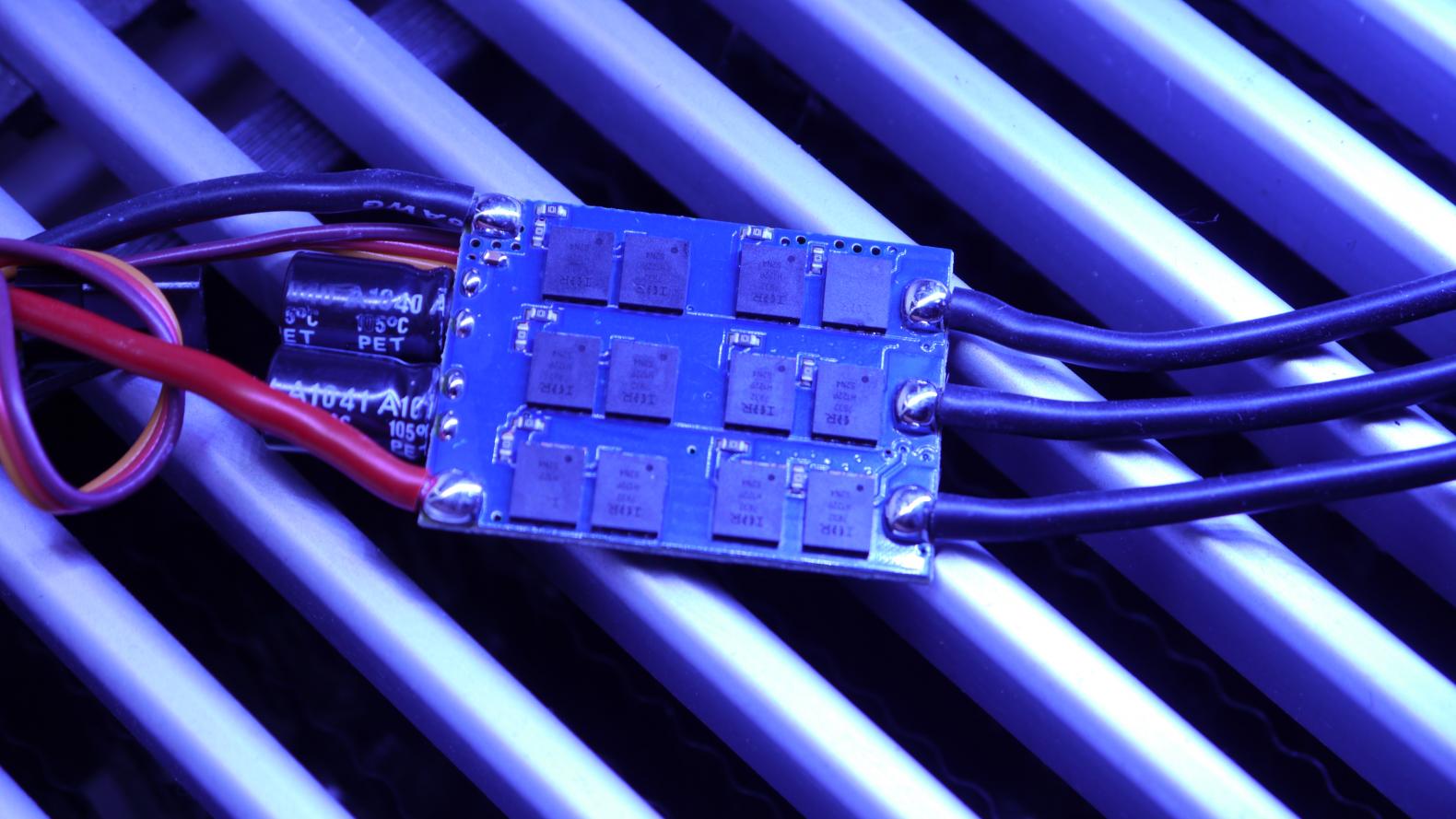

Japp thats what I also considered. Now i have a set of 6 shady axi 2820 loving it :( And smelling is not all they did one started to smoke for a couple secs ;(
Just wonder what an am going to do now, there has to be something wrong with the ESCs I have, cant be that no matter to which timing i set them they smack up the motors !
Its not like i had them under load just starting them up !

Japp i had these motors on my hexa for quite a while now. Never had any issue with tunirgy plush running them !
The maytech v2 dont have the option of changing the switching frequence and more, i guess they come standard with 8 Khz

This whole approach was just for test reasons to check out the maytech v2 since they seems to have some higher grade fets on them. Turned out to be an expensive test ! I think from now on its only herks for me !!!

little probs with the maytech, Motors without load so no props on just runnig dry for test no matter which timing are jumping arround like crazy. Like an old motor that needs an addtional push to get running hmm. Maybe startup settings ?

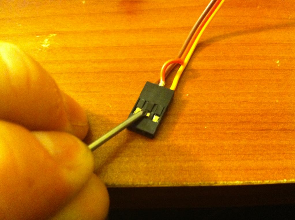

Hello, I just soldered up my Maytech 30amps V1's to my power board. Did you guys cut the small red wires on your Maytech's for your DJI WK? I can't seem to find a straight answer if it's the right way to go...
Kari
I haven't cut my opto versions, but if bec version it should be cut regarding to manual. You can also take pin out of connector with needle so no need to cut the wire.

Yep, I have the BEC versions. Pulling the pin out is a much more dignified solution for sure! Grab something pointy, push up the small plastic tab and work the wire out the top of the connector. QUESTION: I probably should have programmed them before I pulled the reds out? or..hopefully...I can program without the red? Thanks Kari!

Shouldn't be problem programming without red. But you need to power receiver with separate bec when programming. I soldered a harness to program all esc:s at same time. Saves a lot of time.

Had to push the red pins back in to program with maytech programming card. Good thing I didn't cut them! :nevreness:
