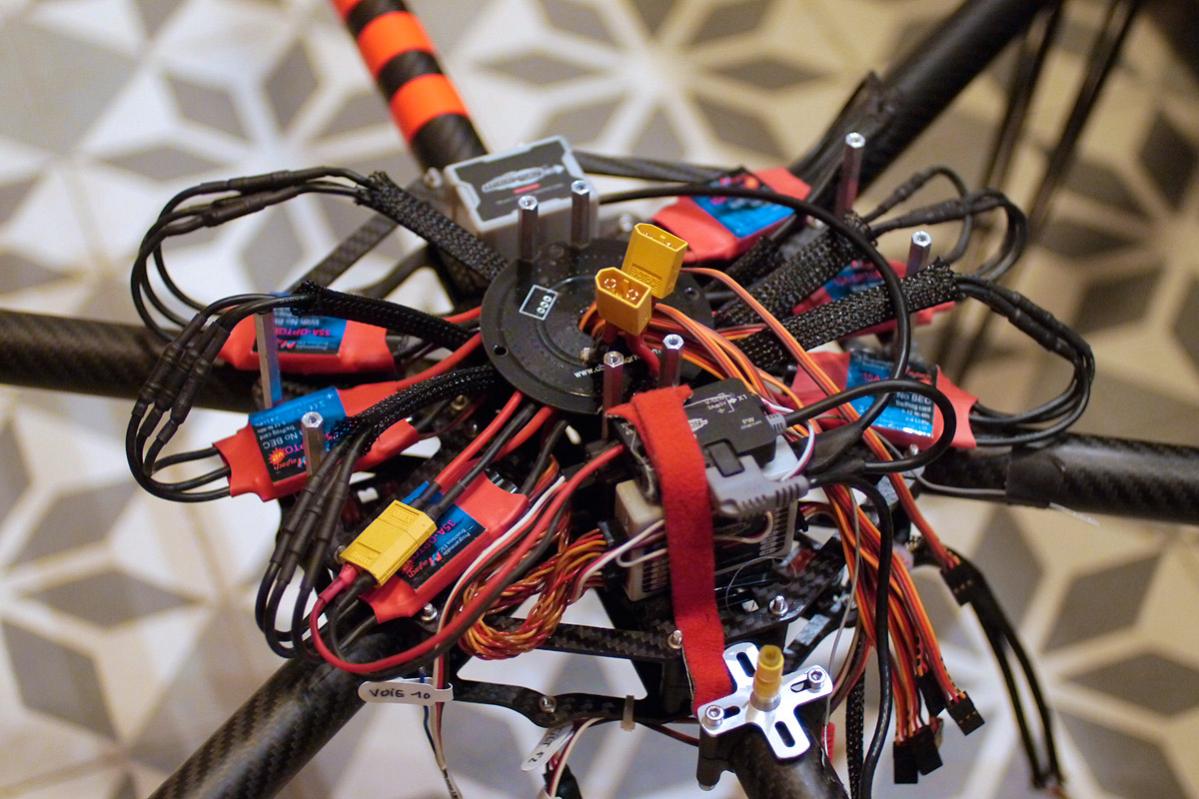

Opto 35A V2's are installed since yesterday on an AbuseMark powerboard on the CS6. I just need to configure them all this evening for a first flight test. Answers on saturday and sunday I think. Anyway, on the manual that was provided with the ESC, I can't see any switching from 8 to 16Khz to test that. Does anybody found the programming function by transmitter on those V2?
View attachment 2425View attachment 2426

Minsoo doesn't spec the board unfortunately but there's a hefty strip of copper under the epoxy so I'd guess it can handle anything I'm likely to put through it, especially considering the other PDB I had was much smaller with thinner traces for the power connections. I wouldn't try running more than 8 2814 AXIs on one, shouldn't be a problem with the 6 I have hooked up.

What will not handle what your planning is the switch that comes with the Minsoo PDB!
Ken
The board is OK but his switch wont take it.
