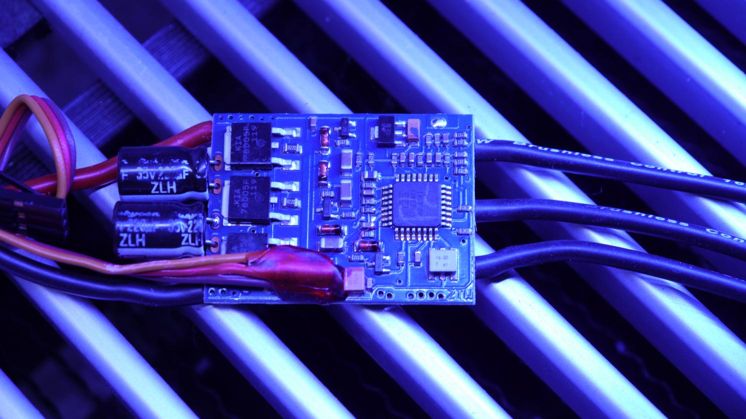

plingboot
Well, i received a tracking number, but the package arrived yesterday - before i had time to try tracking it (!) Shipping took around 4 days.
The supplied programming card is V2 and has a digital display - i thought it was going to be a card with jumpers.
I've had a read through the supplied info sheet (single sheet not a booklet) and there's no info about changing switching speed.
Can anyone offer info on how to do this please?

plingboot
Just had a google for a v1 manual - which i found.
It details how to change switching from 8khz to 16khz - which is at programming option 10
Looking at the instructions for v2 esc's - programming option 10 is the low voltage cut off type.
Comparing the two programming option lists shows some new options for the v2 esc's, with the apparent loss of the switching option. :upset:
I've ping'd an email to maytech, but had a "we're on holiday" reply, so don't expect to know more before early feb.

plingboot
v2 esc options (the ones i've received)
1. brake type
2. battery type
3. cut off voltage
4. restore default
5. motor timing
6. Sbec voltage output
7. governor mode
8. motor rotation (fwd/reverse)
9. start up strength
10. low voltage cut off
v1 esc options (from found pdf)
1. throttle calibration
2. brake type
3. battery type
4. low voltage cut off
5. restore default
6. timing setup
7. soft acceleration start up
8. governor mode
9. motor rotation (fwd/reverse)
10. SWITCHING FREQUENCY
11. low voltage cut off
BorisS
ah okay now i understand its not present at all :( hmm lets see, please keep us updated what maytech replies !
BorisS
lets see, as far the website goes they are only mentioning different firmware and different fets and they are listed as plane heli ESCs.

GGoodrum
No, not out of stock on the ESCs but on the programming card. I was under the impression that I needed the programming card for all of the functions and that the TX could program certain functions but not all of them. Like changing from 16 to 8 mhz. I may be mistaken:
http://modelaero.com/Merchant5/merc...re_Code=M&Product_Code=PCARD&Category_Code=SC
You can program everything you need to from the transmitter. I think it is the programming card that doesn't have some functions, like changing from 8 to 16kHz. In any case, I don't have the card, and I had zero problems. It takes awhile, because you have to wait for the right tones to cycle through, but it works. :)
-- Gary
