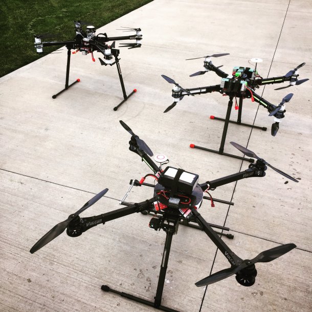

4 more flights today, I dropped my gains by 10 points and it's locked it.
Stupid smooth. I'm not 100% confident yet but it's pretty dar good!
Even descending it was rock solid. And I'm flying a pretty big machine with it.
The rig on the bottom of the shot!
