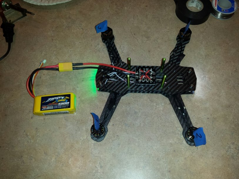

Well not a great start. Looks like th 5V side of my PMU is dead. I pulled out a 5V reg I had and plugged it into the main FC and it powered up. BUT only after I removed all of my receiver inputs. I spoke to my friend and he had NONE of these issues... so I guess my luck continues! :(

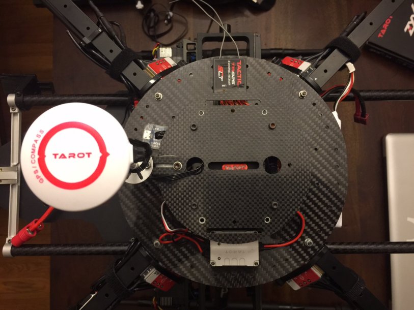

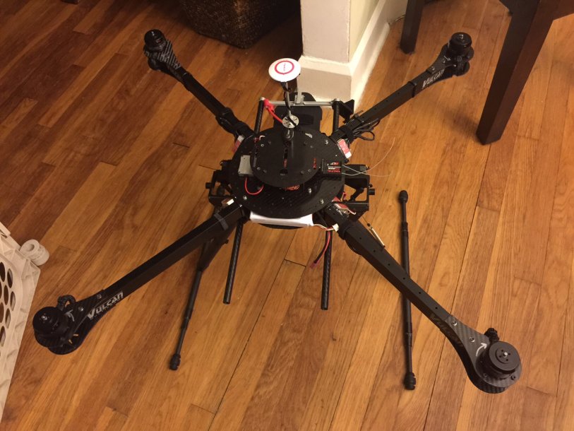

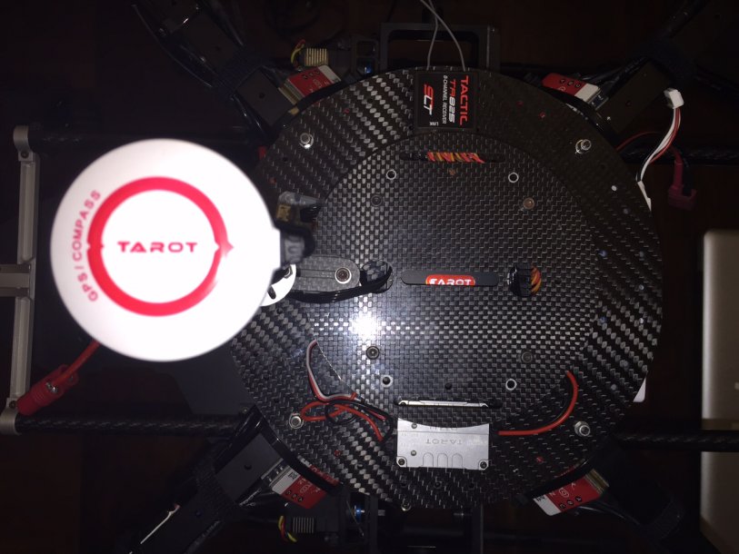

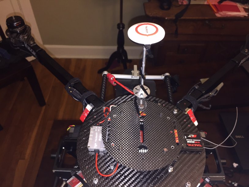

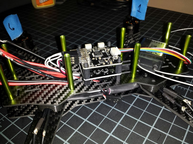

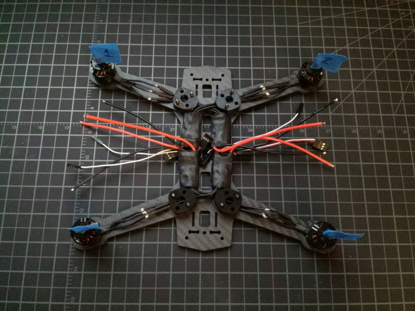

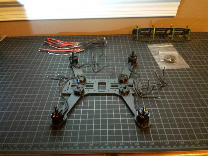

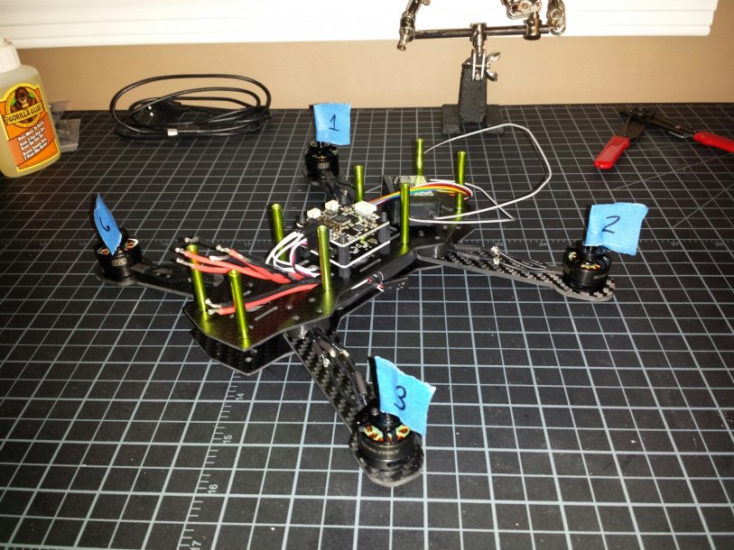

Ok guys.. thanks to our friends at GotHeliRC I'm back on track. I'll be sending them my bad unit and I received a new unit today. And BAM, it worked just as it should! Set up was completely easy, and if you have used the DJi Naza /WKM/A2 GUI then the Tarot will be very familiar. I'm starting with the recommended settings for the Tarot X4 quad as this one should be around the same weight. If the weather cooperates, i'll be trying to fly tomorrow!

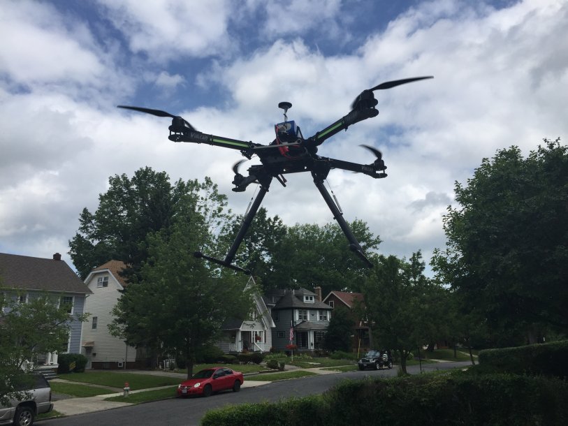

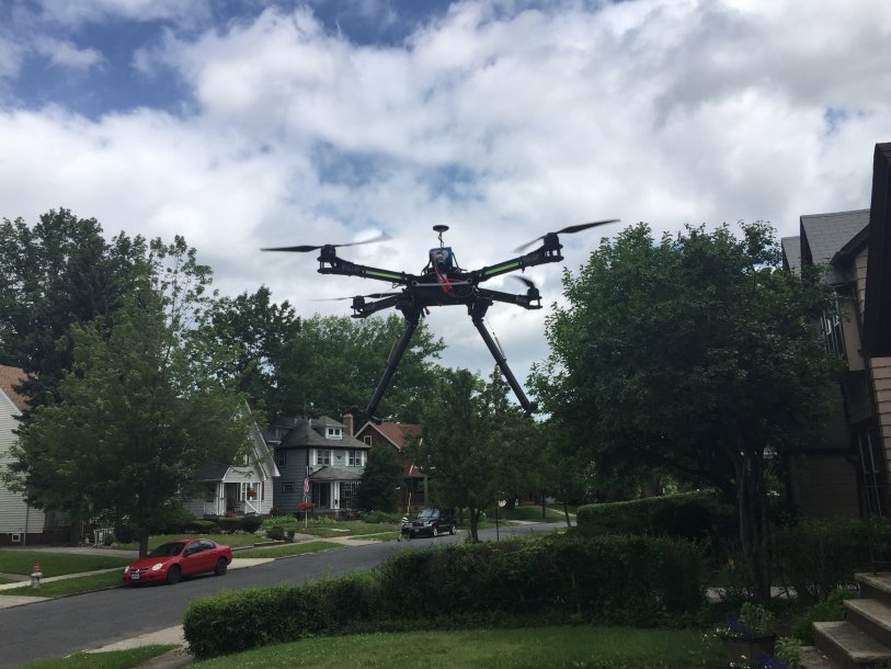

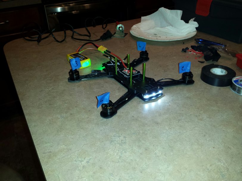

Ok it has flown. Just a hover small flight in my front yard, but it flew! And it's NOT BAD AT ALL. I think my gains are a little high as it was a slight bit twitchy, but I simply plugged in some "test gains" so I expected some tuning.
The GPS hold is spot on. I did not expect this. It indeed feels like a WKM-ish FC. And I think with a little tuning this guy could be pretty awesome! I'm going to read the manual again and see which direction I need to go with the gains to smooth it out some... But man... For $125 my first impressions are WOW!
Thanks to GotHeliRC for sending the new unit and getting this testing back up and running!
Few pics... (Sorry it's just me, no camera man and my main cameras are all packed up for a job later today so you guys get cell phone shots and video...)
