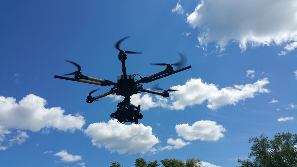

2 more flights today. Building confidence in this machine. In the video you will see my "wood box of rocks" which connects by the movi toad in the hole and replicates the center of gravity and exact weight of my movi, camera and lens.
I was playing with my atti gains today and checking performance and temps with 16" props. Everything was so cool considering it was 90F here today. I check and read temps at the end of the video....
Mojave
Nice flight. Did you discuss your leading gear anywhere here? Where did you get them - that seem to make a good tripod and they fit up nice and inline with the arms.
Pumpkinguy
They are the Tarot actuators, 25mm x 520mm tubes and the hexacrafter mounts.
The tripod is sooooo stable. No tipping
