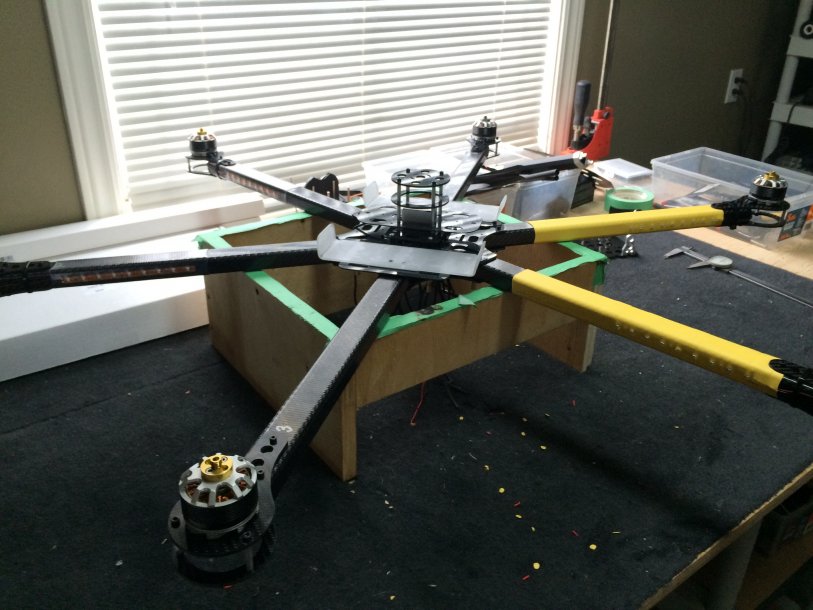

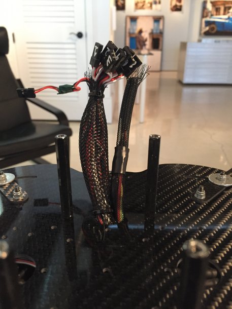

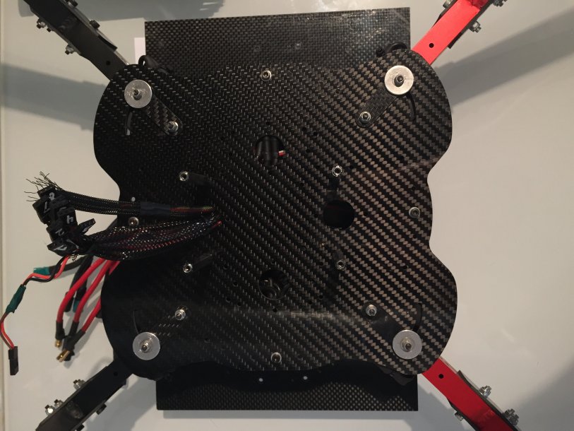

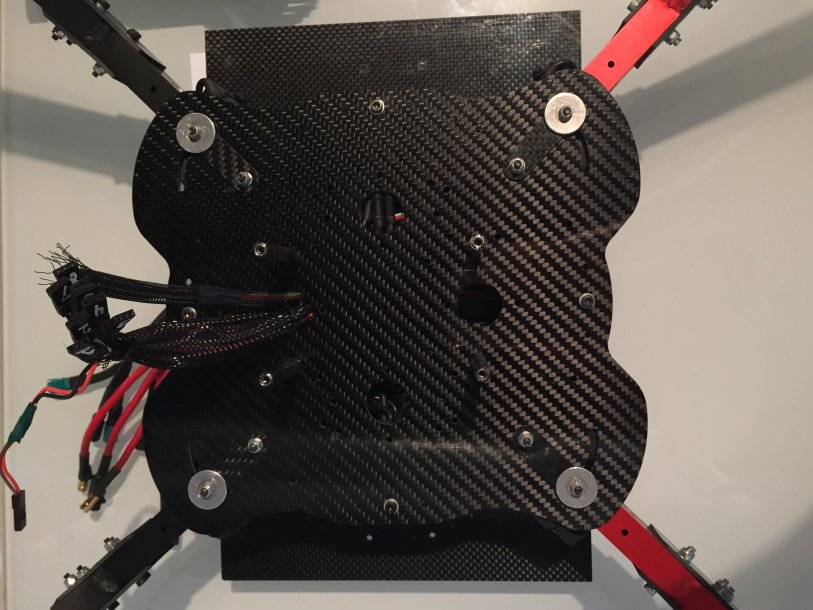

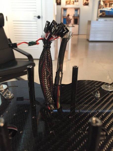

Here is the assembled frame. Yellow heat shrinked arms will be the rear of the aircraft.

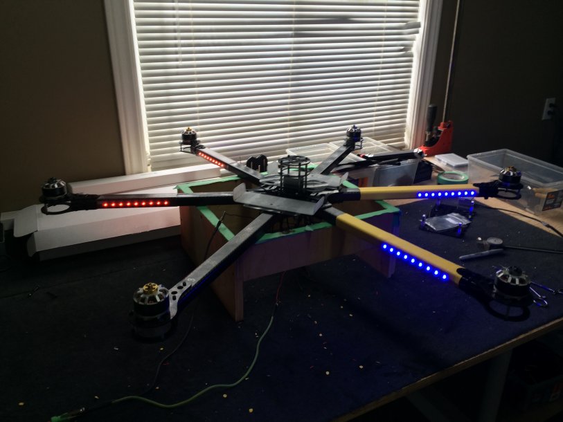

Here is a pic of my lights. Red for front, blue for back. They will be on a reciever controlled switch. View attachment 23587

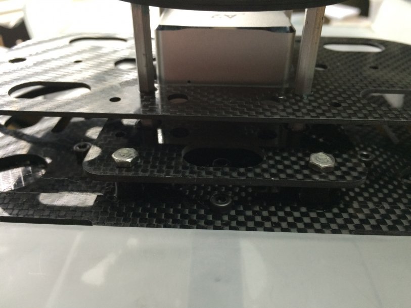

A shot of the A2 imu on the isolation mount
A shot of my battery mounts. Just 3/32" lexan sanded to a frost look. I learned on my last build that no matter how tight the Velcro straps are the batteries can slide.

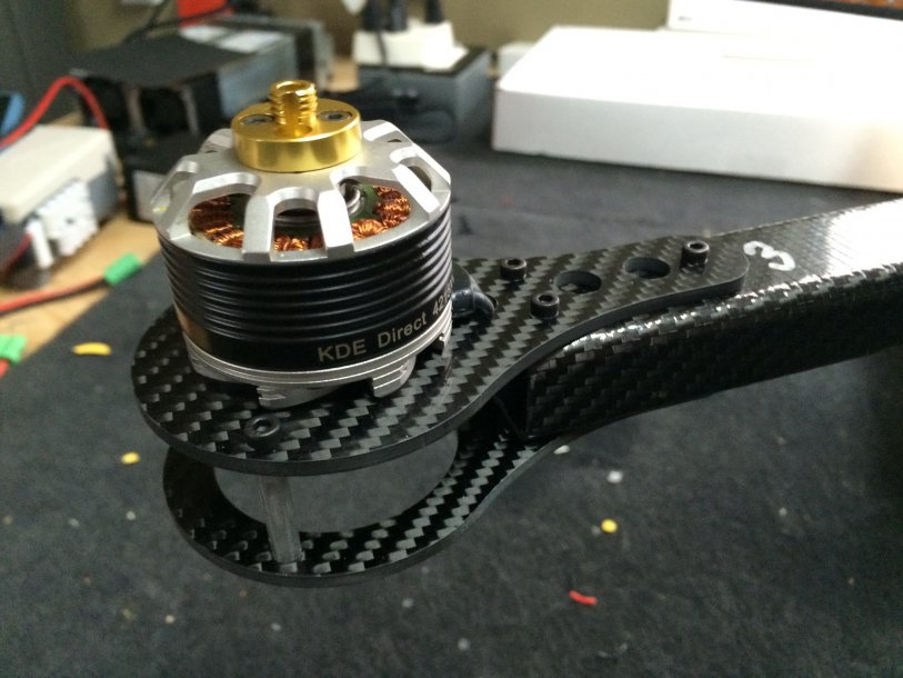

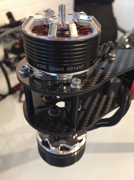

And a pic of the motor mounts. It's hard to tell by the pics but both the top and bottom plate are 3mm. These are rock solid.
Tanks for looking guys. Once my esc's arrive I will post some pics of the hexacrafter power distribution. It's sweeeeeet.

Do you have a link for those self-tightening adapters? Are they good quality? I've been looking for something like that for my heavy lifter, but I'm worried about how they would effect balance, and god forbid even a marginal chance of slipping off in flight... especially since I'm flying coaxial?
Cool thanks I'll check them out - have you ever tried with coaxial? I'm mostly worried about a situation where heavy thrust from a top prop manages to unscrew the prop below it...
What prop sizes can you fit on this hex?
Pumpkinguy
Buddy if you tighten those props by hand you will need to grasp the motor with pliers to get them off.
I know a guy that uses the same ones on a large coax. 18" max prop
Pumpkinguy
Btw. I have them on wrong in the picture. They were already installed on the motors and I didn't take note of direction when mounting motors. Motor #1 spins ccw. It needs a titanimum adapter. Odd number titanium, even number gold. (Cw)
