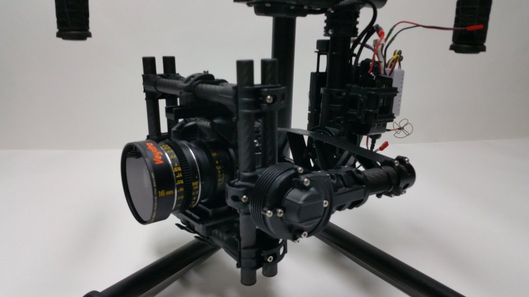

This is what I'm currently using for fpv. Yes, I would like a connex and I intend to get one but I buy stuff as income from this hobby comes in. It's on the list for sure.
A kopterworx converter, immersion rx and 3s1300 for power. Hyperthin hdmi cable. View attachment 25872
Another shot of the movi View attachment 25873
And my ground station. I'm using 2 monitors. One for fpv and one for osd data. 2 separate vtx's. 2 different channels, one with right hand and the other left hand polerized. View attachment 25874

Nice, get that antenna straight down on the tx and remove the elbow. Null spots are facing front and back. Up on the receivers.;)

On the REC I'd have the mushroom facing straight UP... on the TX straight down. That way the null spots are facing straight up on the RX and straight down on the TX... and if you are directly over yourself... well you don;t need fpv. :D
