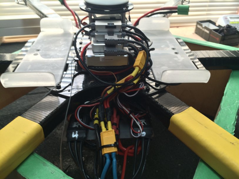

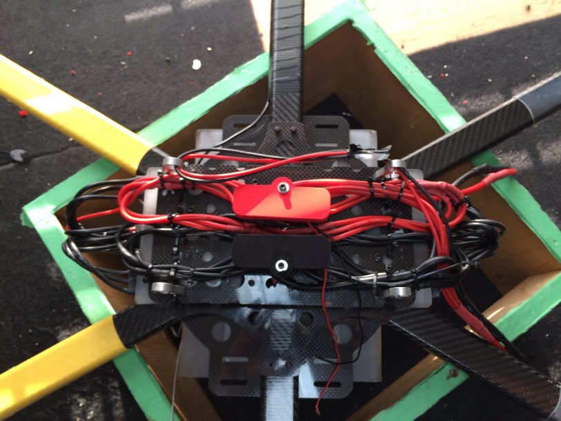

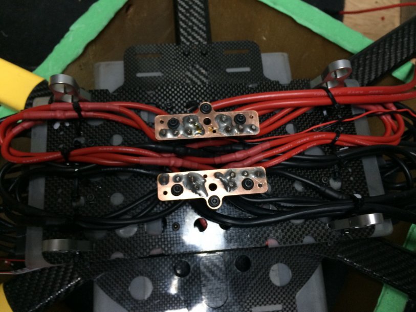

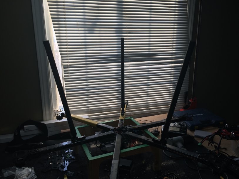

Hexacrafters bus bar system. I mounted on the underside of the esc plate vs the traditional way of beside the esc's. This gave me more room and less crowding. Those are gryphon 12mm load rail mounts I adapted from my crashed gryphon frame. View attachment 23769View attachment 23770

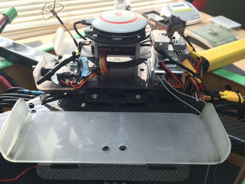

Even on awesome frames like this the real estate gets used up quickly. I spend lots of time planning and trying to fit everything in as neatly as possible. You can see my iosd mark ii is between the gps and the imu. I like it here because it's close to everything and easy to plug in the usb cable. View attachment 23771View attachment 23772

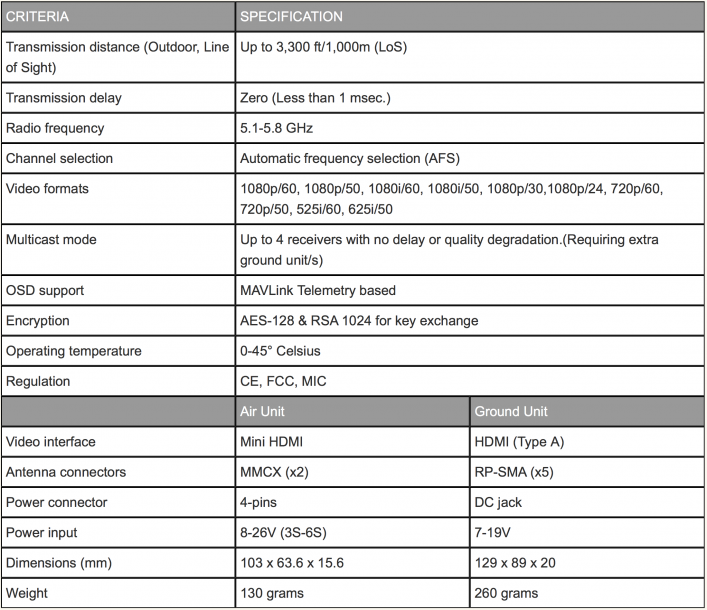

I was thinking it might be more of a difference. I thought I saw $1000 off on the aerial version of their larger unit vs the handheld. Be interesting to see how it works for you.
$1995 is the official price for the ecofly version. Same price as the complete kit on presale.

nice to see you're making progress and keeping everything neat in the process!
only suggestion would be to get the head of the video antenna away from the stuff around it. if you can mount it down below somewhere so it will be able to transmit in all directions that would be better. 5.8ghz will be blocked by just about anything around it. on one of my heli's the camera gets in the way when it's pointed in a certain direction and the video drops out.
