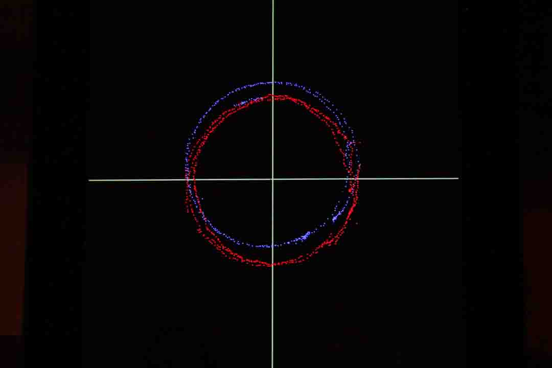

Jim, when you do a Compass Cal how good is the end result? I have never managed to do one that is perfect i.e. no gaps, complete overlap I have never got it as its pictured in the manual I even made up a stand on casters and that gave me a bit better result. I can keep the LED on in horizontal but vertical no way and they say when the led goes out keep moving but I dont know.I just have to wait for parts for mine which will be a couple of weeks I suppose. cheers. john,
socratic
Hi John, the last time I did a calibration with the installed on the Steadi470, I got the two circles pretty close. This time I updated the firmware to the most recent release (this month) and didn't get as good a calibration. I will try again and see if I can actually get the circles to be on top of one another. Right now they are off set a bit but both pretty close to centered. Took me a while to figure out that "many seconds" to save the data then display should read "many minutes" as it takes a while for the circles to show up at all. I was too quick on my first tries and re calibrated - probably had it right on! By the time I realized my mistake, I was woosise from all the spinning! BYW - forgot to mention, I was flying in auto hover mode for my test. Jim

John, This is about as good as I seem to be able to get it. Just did this one since I was having some issues with toilet bowl effect. Haven't tried the quad since resetting compass though. I'll let you know how it goes. Jim
johnno
Hi Jim, I have manganed to get them closer togther but mine have had more gaps in them, Its got to work there are to many of them out there I bought an X4 and just about to start a build on a new frame so when it gets up and running it will be interesting to do a compass cal on it. The Aust rep is over at Zero at the moment so just waiting for him to get me my parts for the Steadi and we will have another go but your machine looks good dont know about the reduced aileron control in GPS Mode certailt looks ok in the atti modes.john.
socratic
I think the gaps are probably caused by the light turning off - not holding the quad steady enough? I was having a lot of trouble pointing the quad down (vertical alignment) and turning and keeping the light on, so I just placed it on a swivel chair so that the blue light came on and stayed on. I was able to hold it and sit in the chair for the horizontal alignment.

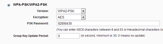

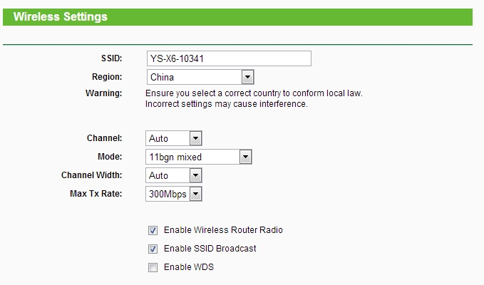

maikpa
Hello robone
Iuse the system in greece and olso with the ather,i use the same router TP-Link WR941ND with you,and my phone is ASUS PADFONE and i try to condakt with wifi (i use the old one)and nathink hapen it is poseble to send my the seting in the router,step bay step
thenks Maik
robone
Hello robone
thenks Maik
Here are the settings for my Router
