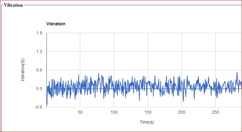

Here you go - 5 mins long enough? Take into consideration, wind was about 15-20km/h

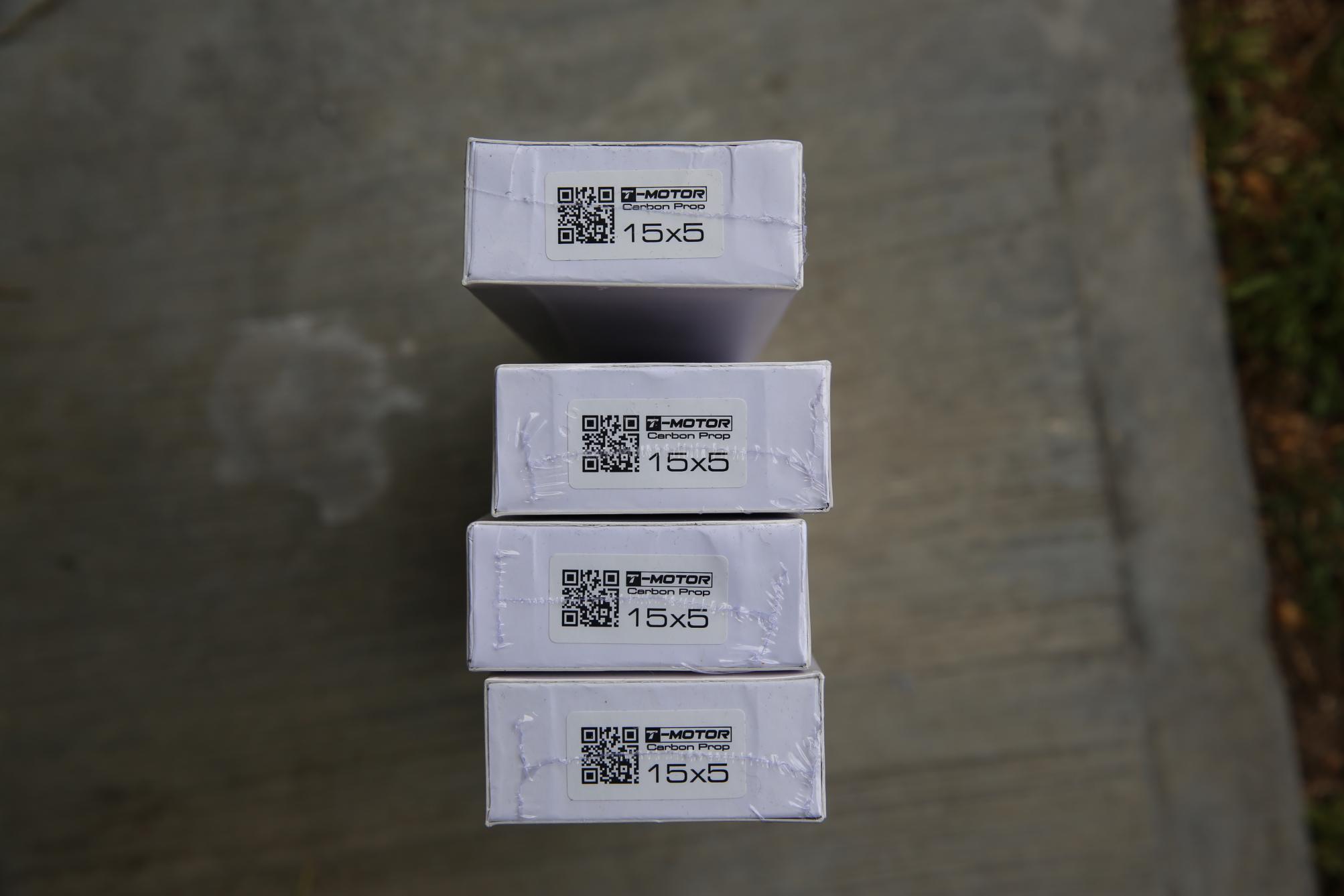

Very good I'd estimate an average vibration of about 0.4 - 0.5 here is mine for today, same time frame, my average is 0.08 direct result of T-Motor props. Not a competition just an example of why the cost.
In the event you want to see the full flight up to about 90 meters, here is the relevant BB http://log.xaircraft.com/report.htm#2014_05_24_190445.250_219.2.04.56
