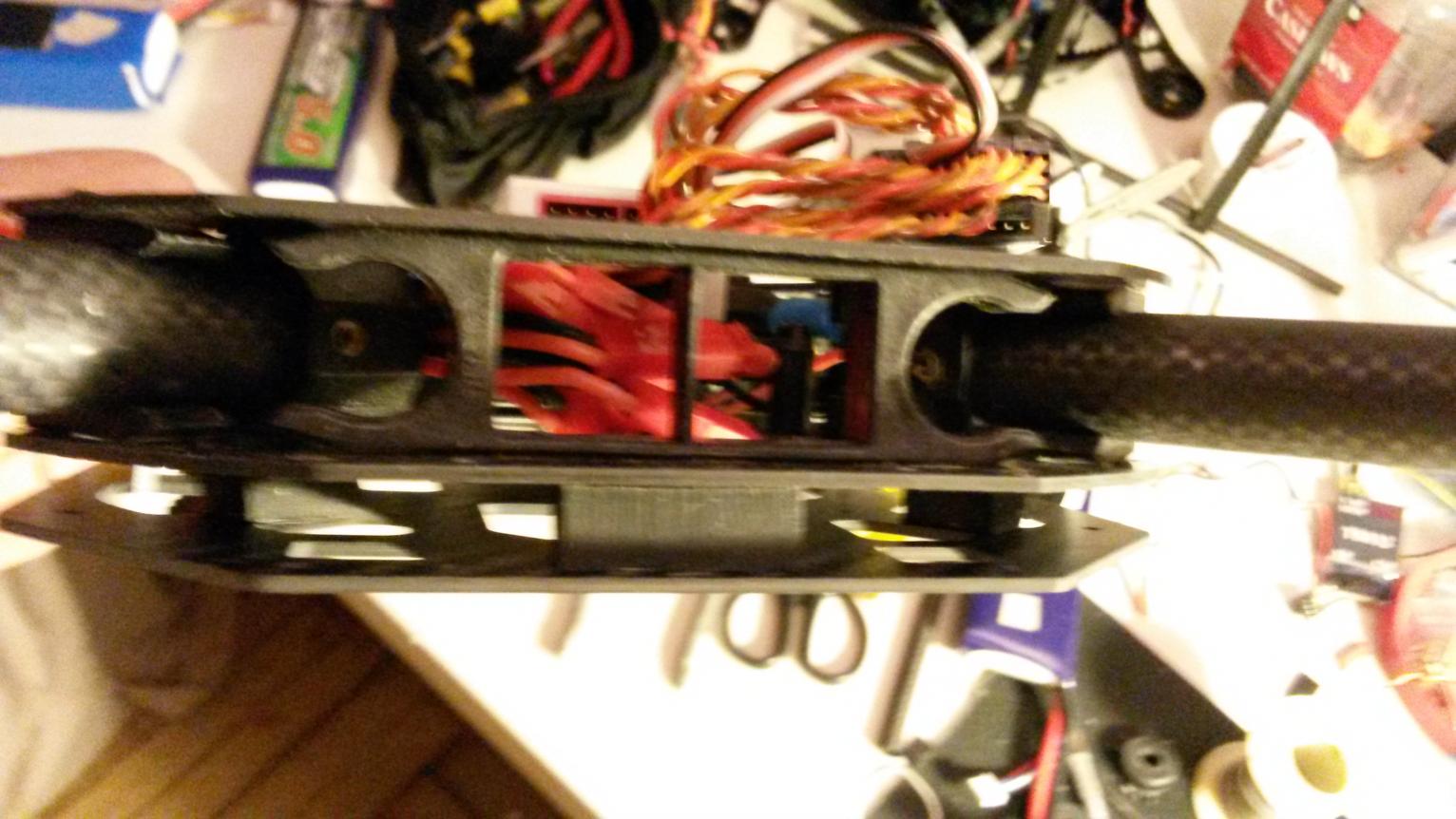

I got finally got to experiment with my 650 v4 i wanted to separate the bottom plate from motor so i bought extra bottom plate use rubber mount from xpro helli. I use sunnsky 1216 900kv and 10 inch sigma carbon props i change the motor mount to the 650 pro motor plate and use my old ARRIS 2000 which when i first try it on my 650 pro gave me micro vibration. Now it does not completely remove every micro vibe and it has a bid up and down motion when going fast maybe due to softer rubber dampener i used for arris 2000 here the video there's no stabilizer used raw footage it;'s in wide 30p.
I will also try the bobbin's from my qav 400 they have nut's and bolt's so it's more secure 6 will do .
