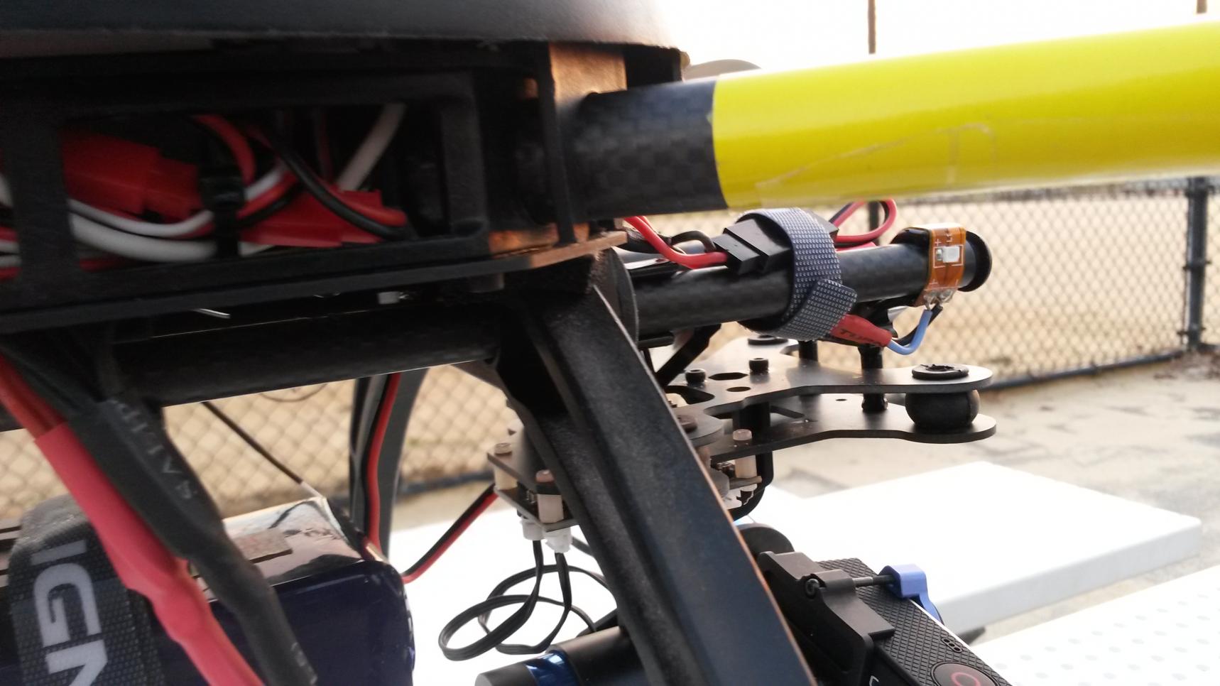

Yesterday itry the 4 only softer dampener with the hook mount method i think it a little better but still have those vibrition after one battery i notice when i lift of it would go side way and tilt over it was my props nut loose after 9 battery run i did not check so check those nuts. here a video of the under carriage of the gimbal

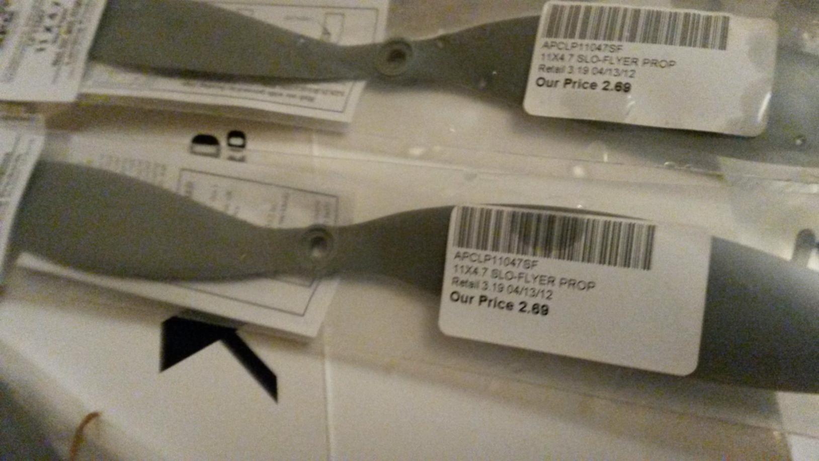

windy day yesterday 1 guy flying a plane got his stuck on a tree. Here some thing i found out those props are made in USA and i order from china for the sf 8 doll and 6 doll for other i went to Bruckner hobby i they have them for 2.89 wow i ask him to order more. Today i will fly with the tarot let see how it can handle the vibriation. View attachment 15331View attachment 15332
