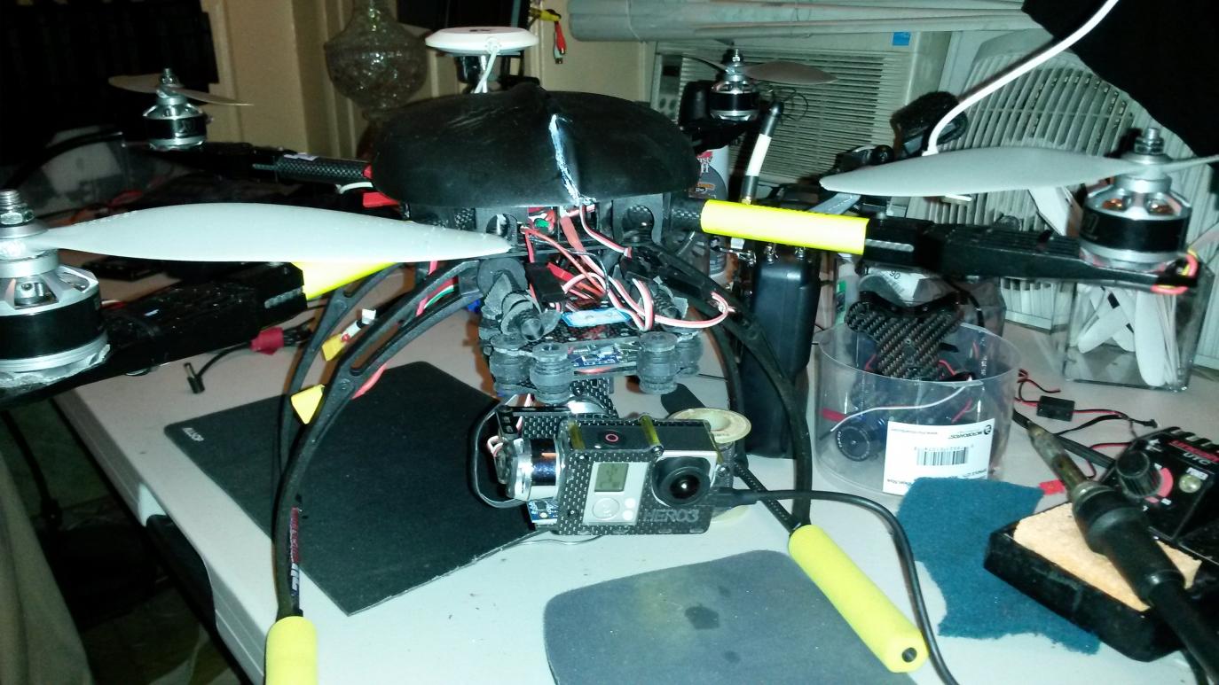

Happy Holiday to all i finish fix on quad i try the gimbal with out the hooks like vquad but i added a mouse padding View attachment 15317
Here a video of it in my messy work room i going to Randal island to see out door shots today Christmas day.

That's seems a lot better. Its hard to see if there are any vibrations indoors like that, without far away objects. I would be curious to see it outside. But that does seem to be better.
Have you balanced your props?...what method are you using to do so...
