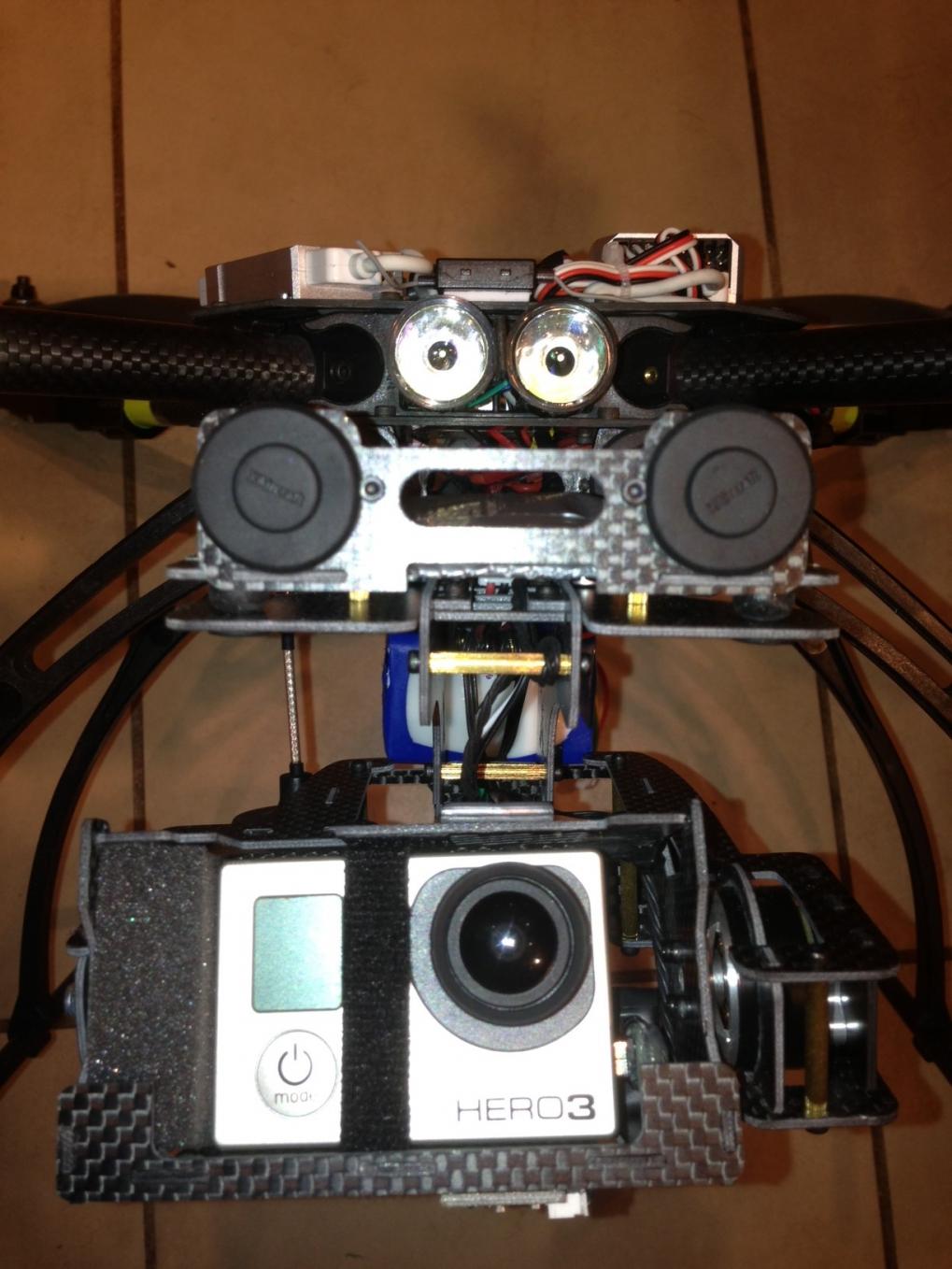

Ok i came back from Randall Island here the conclusion of what i did last night i have 2 video 1 raw 1 post stabilize 1080 30 p the ican stadium shot was medium focal the rest is in wide focal
Video 2 stabilizer on
I have a ND FILTER but did not use it might help get some jello effect out.

Great post Daniel, thanks for taking the time to post this today. These results are similar to the points I've been talking about. I don't see any "jello" (wavy distorted video lines) I see more shakes, stutters and tiny micro vibration in your video. So I'm not sure what an ND would do for that...hmmm.
From looking at your black box file, the vibrations seem normal for the flights. And the wind looks very very light if any at all. So with knowing all that, I'm curious to know what is causing all the shaking. Sometimes in the video its worse than others. The stabilized footage you show looks very much like the RAW footage that comes out of a phantom H3-2D setup. So I refuse to believe that the X650 Pro cant deliver better than what your getting here.
I'd like to see someone's black box file that shows significantly less vibration than what Daniel is showing on his black box file here with the same flying characteristics as his flight. You can get less vibration with just hoovering. But he is flying around in his videos. Its doesn't even appear to be aggressive either. He does have some spikes to .5 and .7 but not the whole flight. In some of his flights he's around .3 - .5 which I think should be acceptable to acheive better video results. I see Phantoms fly aggressively in high winds and the video is rock solid. How do you explain that compared to the "higher end" X650 Pro?
I'm not saying you cant or shouldn't stabilize the video after a flight. I'm just saying I feel like we should be getting a better result right out of the camera as other platforms often do...or at least claim. I think the frame design in the X650 is weak and allows for or creates some "flexing".

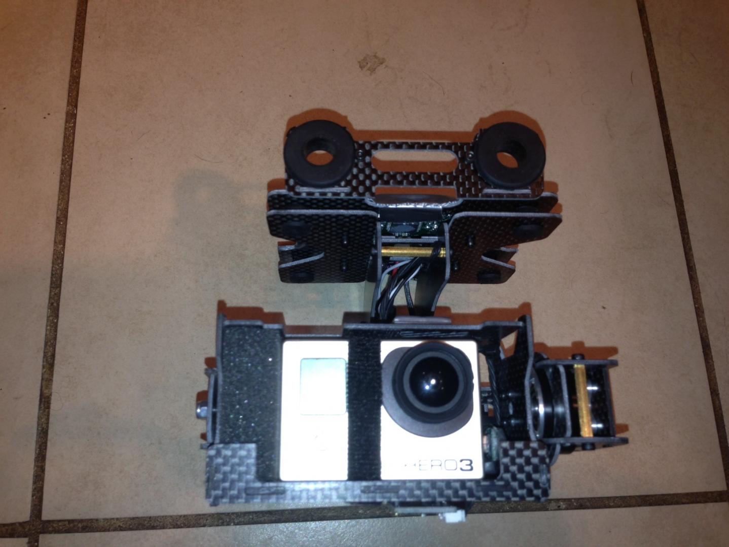

Daniel - have you tried swapping out the balls on your gimbal for a different configuration?...perhaps one hard and one soft? or all soft?...or all hard?
Dhardjono
Yes Amy said soft one are good for more vibrations but i only have 3 soft dampner so i will order more now i am chatting with her but she on a lunch brake i also order 12 inch carbon fiber prop and new gps puck and tomorrow my board come in for the broken tarot board which i will try with the hooks. Andrew i email him he said he will look at the report i also send him videos of it he isfrom xair US. So far i am getting use to the 650 pro it better in flying controlling yaw ect,,, than Arris 650 but the vibriation kills me other wise it will be top ten this 650 pro with super x.
1- question when you first fly do you have to wait for the lite to signal to go fly like the dji i wait for 3 greens what i did just wait 1 min look at the monitor see how many satellite i have evan the gps is not working it still see's the satellite.

I'm not sure switching out the balls will make a difference, But its worth a try I suppose.
I still think its in the frame design and the fact that the gimbal is hanging out in front of the quad, rather than under it(centered) like other MR set ups use.(S800, Phantom, Other Hex rotos, etc.)

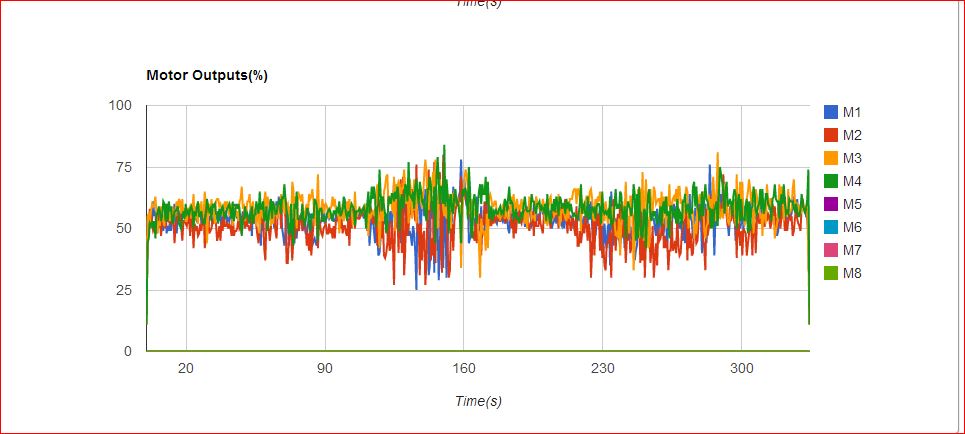

A thought, I think Daniel's motors are still the problem there appears to be too much separation in the power graph when looking at the motor numbers and thrust, could be the wind he talks about but then you would expect the motors to be in unison, left/Right/Front/back depending on wind direction, but they are not.
By example here is mine from this morning climbing to 100 meters, much more together

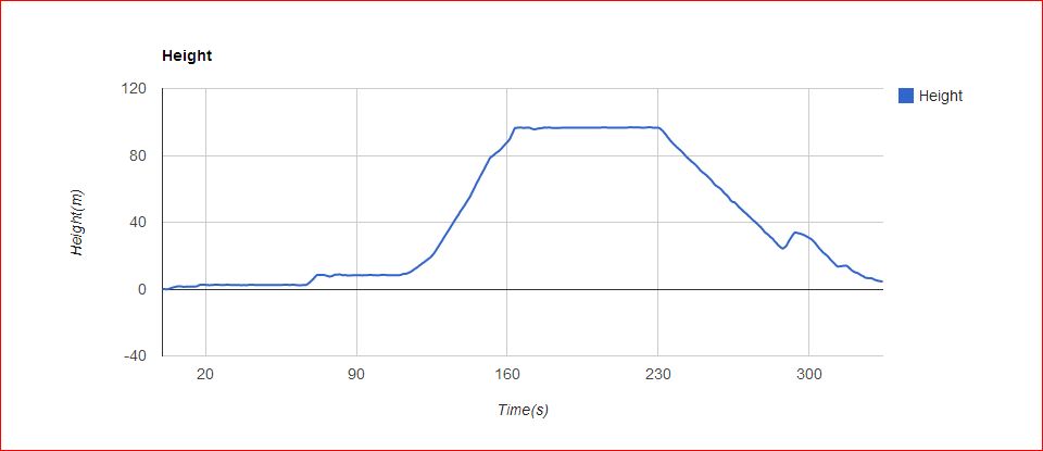

Normal! not sure there is such a thing, but your answer needs to come in 2 parts, firstly flight and secondly motor thrust, in my opinion and from what I have been told by XAircraft the motors should be very close together in thrust, they will vary due to wind attitude and how the body itself is set up.
These are from a flight yesterday firstly the height so you can see the vehicle climbing and hovering, secondly the power required by all motors to achieve the lift and hover together with reduction in altitude which also requires the motors to behave in a certain manner.
View attachment 15328View attachment 15329
I hope this helps.
