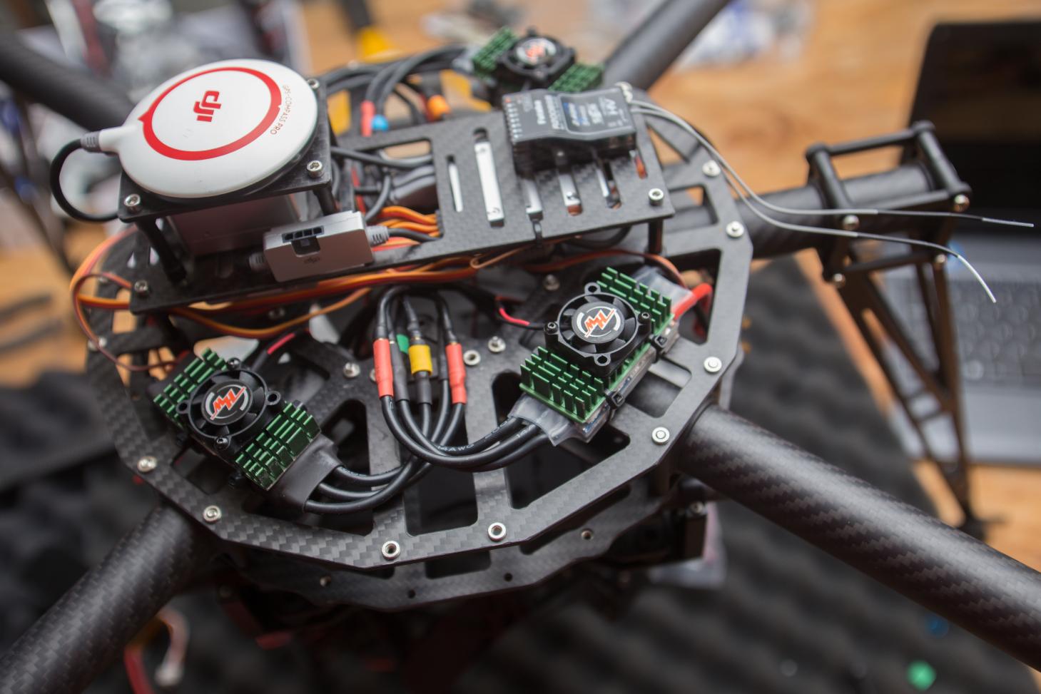

I have a X8 and X4 Mega lifter with U7's, Maytech 65A ESC's modded with heatsinks and fans. The X8 is running a WKM and flys very nice at 26 lbs. The X4 is on a A2 controller. The X4 crashed yesterday and I think the problem is the U7's with the SimonK Maytech 65A-opto ESC. I have removed my FC stack and flown mulitple batteries after the crash on a stock dji F550 frame/esc/motor combo and flew it incredibly hard with no issues today.

here is the ESC mod that keeps the temps around 105f, stock with no modding they were running 145f
simonK maytec had a problem..... take everything off but one prop and fire it up, rap the throttle on and off with different timing between none and full,,,,, does it do this kinda stuff?

I was taking it up fast just for tests, The motors are cool and have never gotten past slight warm. As you can see from the photo, the esc's have been modded with heatsinks and fans which keep them under 105f. T-motors also at first recommended just the T40A esc for these motors and after many problems they now recommend the T70A for the 420kv and T80A for the 490kv U7's. But as usual T-motors states that those speed controllers wont be available for 30-45 days which prolly means 75-100 days until they can deliver them
