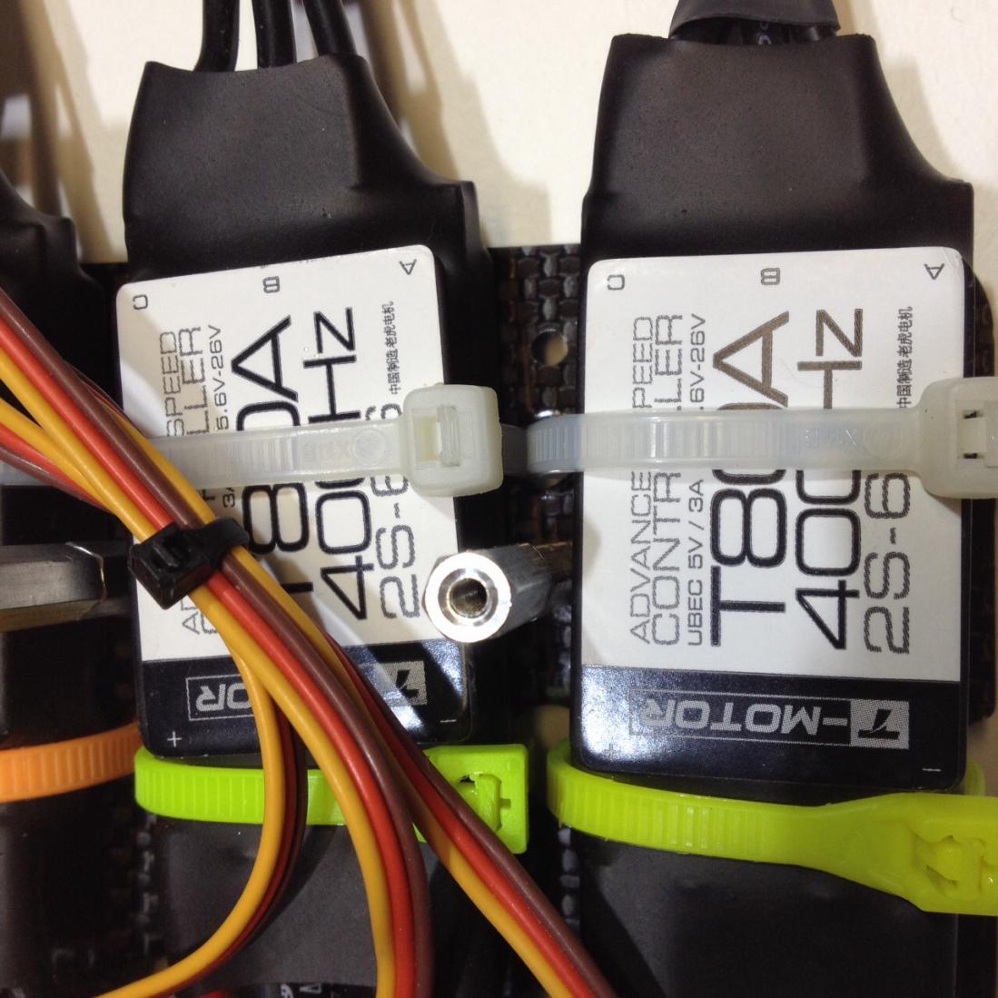

HexaCrafter supplied me with the Tiger T80As as soon as they found there was a problem. Here is a photo of the ESCs that I have -

Forum/ tahoejmfc,
The distribution system shown in the photos is the HexaCrafter Bus Bar System. We provide an assembly service for our clients who wish it pre-assembled with their kits.
http://www.hexacrafter.com/136-asse...nd-t-motor-80-amp-esc-soldered-assembled.html
The T-motor T80a are now back in stock for our clients.
They can be purchased retail at: http://montorc.com/T-motor_T80A.aspx as well as many other T-Motor dealers.

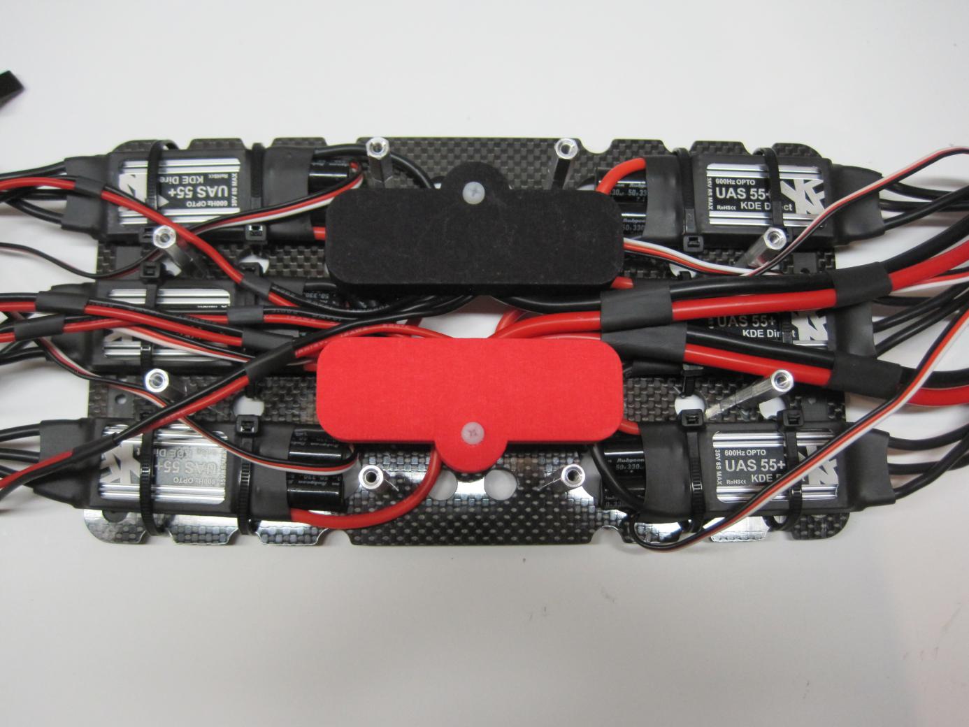

At Kloner's request, we assembled his Bus Bars with the new KDE 55a ESC. for his testing.
We currently are following the T-Motor approved direction of the T80a ESC for all of our other clients, until other proven ESC combinations are available.

I picked up 4 escs to test with the U7. Castle Edge Lite 75, Castle Edge HV 60, Castle 35 multi(cant handle it), and the KDE UAS 55A.
Did you happen to test those KDE 55 with the U7?
Also with castle do you know what pwm timing to set them to? I used default and they work with no sync issue
