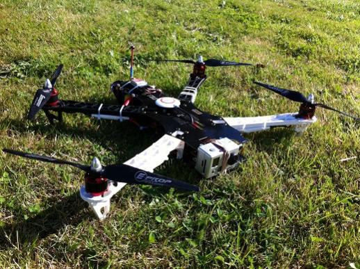

Nothing special, just to show how great the Discovery flies with the T-Motor MT2216;
Thanks to Boris for help to find out!
meme
nice meme, zero vibs to be seen ! What props do you have on ? 10 x 5 graupner ?
Thanks, well balanced 9" Graups, Gel Pad and some foam between Plate and Gopro.
