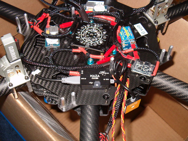

Kratos- I just finished an 810 build using Naza and DJI E800 motors. I have been able to get
19 minutes of flight time and the esc will get very warm. They need some airflow. The final
weight is 4600gr.
Alwil
Do a search for Tarot 810 images- lots of pictures of different wiring schemes.

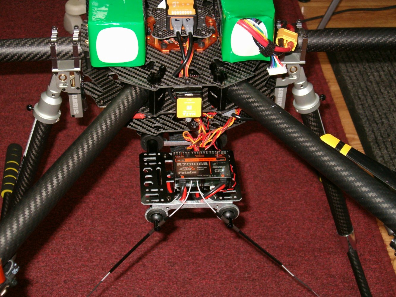

My build list-----
Tarot 810 frame plus extra bottom plate
Arris landing gear
Naza V2
Dual PSB 200 amp capacity
DJI E800 Motors & ESC
DJI mini osd
Futaba R7018SB 18ch receiver
Futaba 14 SGH radio
Dual Multistar 6s 6600mah
Go Pro 3 Camera
ImmersionRC 600mW 5.8GHz A/V Transmitter
Walkera G-2D 2 Axis Brushless Gimbal
View attachment 27667 View attachment 27668 View attachment 27669 View attachment 27673View attachment 27674

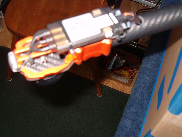

One thing I did was drill a small hole in the booms for the power wires. I debated this as I
thought it may weaken the booms. I ordered a piece carbon fiber tube that would just fit
inside the booms (3 in long) and epoxied in place to strengthen that area. The wires are
covered with flex weave and just would reach the PSB. The arms fold up nicely with no
strain on the wires.

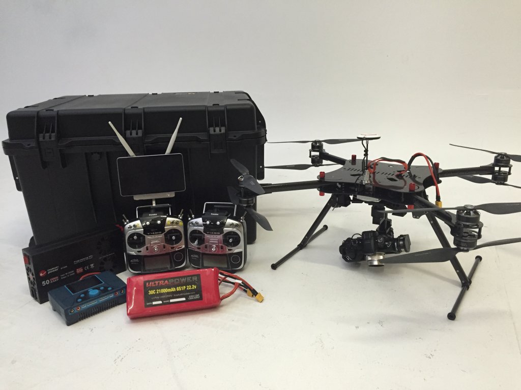

So, in the grand scheme of things I realized that I would need to finally use the second remote that I purchased. I took yesterday and reconfigured my Taranis to act as a buddy box to the second radio that I have that was originally intended for gimbal control. This was somewhat of a challenge as the channels that I was wanting to share control of were not the standard 1,2,3,4 channels that are typical of buddy box operation. So, thankfully the Taranis is such a GREAT radio and the OpenTX software allows for the customization that it does. Now, what my original goal was, was to have a setup that I could use either in a one man operation, or a two man operation, retain the same button, switch etc configuration for gimbal control, and allowing for a second radio to assume the role of those gimbal controls with minimal reconfiguration (if any) of the Taranis when switching to 2 man operation. So, in coming up with the configuration for this setup I stumbled across a nice little piece called a Linker. This allows the second radio to wirelessly transmit its signals to the Linker box (which has a separate receiver in it). The linker box is designed to be a wireless buddy box setup. This will allow me to get rid of the connecting wire between radios and have wireless operation between the two radios. The setup I have now completely disables the master radio control of the gimbal controls while the buddy system is in operation, as to prevent interference with the camera operator, yet it gives me the flexibility to simply turn off the second transmitter and still use the Taranis as the main controller if I want to grab a shot and I don't have a dedicated second operator available.
I know that the Inspire is out there, which is all well and good, but honestly I REALLY like the 810 and cant justify spending $3k on another setup when I have this one ready to go. Plus, with this I can put ANY camera on it, and not the one that DJI says I have to have on it. Anyway, as soon as this thing is configured and ready to go, I plan on posting a video on how I setup the radios and how I have the gimbal setup. At this point, I still have parts coming. Anyway, that is what I have. Everyone have a safe and joyous 4th (if you live in the states that is). If you don't, well have a glorious weekend and fly safe!
