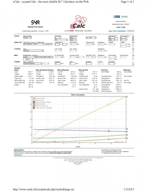

Yeah, the 3520-400 T Motors aren't gonna work. I ran the avrotos through ecalc and they have plenty of torque to get it up in the air.
http://montorc.com/avrotolift3520400kv.aspx
They call for an AUW for a hex of 15-20 lbs and an Octo of 20-30 lbs.
Here is what my rough ecalc said...

I thought avroto and tmotor were effectively the same motor. I highly doubt if you compared thrust between the 2 brands there would be a difference. You need to be aware that some companies test and rate their motors differently. Testing equipment varies. I am not an expert by any stretch but I think you will be under powered with them.
talunceford
I think that avroto and Tmotors are completely different motors. I don't know, I am basing my determination off of what ecalc is telling me. The results are quite different from each other. I have looked at both motors, but who knows right? I know that my build WITHOUT the gimbal is almost spot on to what ecalc says. Actually I am only 2 10ths of a minute off of what ecalc says it would be, with my Tarot 4114 motors. Mind you, there is not a chance that I would fly this rig with those motors. The one thing that I DO know is that the 4114s I have now won't cut the mustard. Gotta find something that works better than they do.

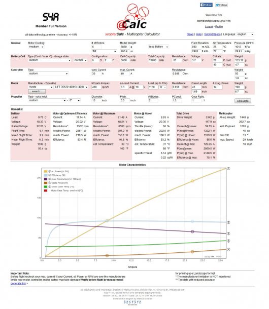

I am confused. You are showing the chart for the AVL3520-520kva motor. This is a much different motor than the AVL-3520-400 kva motor. Your proposed build is much like our HC-800 series.
We use this aircraft up to 7200 grams with AVL-3520- 400kva with 15x5 CF props for many clients. It will hover at about 50-55% throttle in heavy air..... 60% in light air at higher altitudes. Motors and ESC always come down cool.
This aircraft works, but is clearly at it's MAX. weight and has less headroom to react to wind. I strongly suggest 60a. ESC for this motor.
The AVL-3520-520 kva motor is much more aggressive and less efficient. It will do much better at or above 7000 grams, but at the expense of flight time. This motor will require an 80a esc.
At this weight, you are on the line between an 800mm and the larger 1100mm aircraft. We would push our client to go to the 1000mm with U7 motors and 18" props at this weight..... much better weight to thrust ratio, reactivity to wind & large gains in flight time.
Here is the Calc for the HC-800.

Yeah I was aware of the stats. I was trying to show that the motor specs were a bit different than that of the t motors. Yes the 3520 520s are much more agressive for sure. I am still leaning towards the 3520 400s. Which speed controls would you suggest for them?
