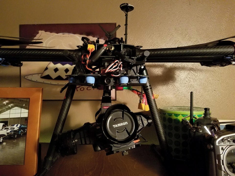

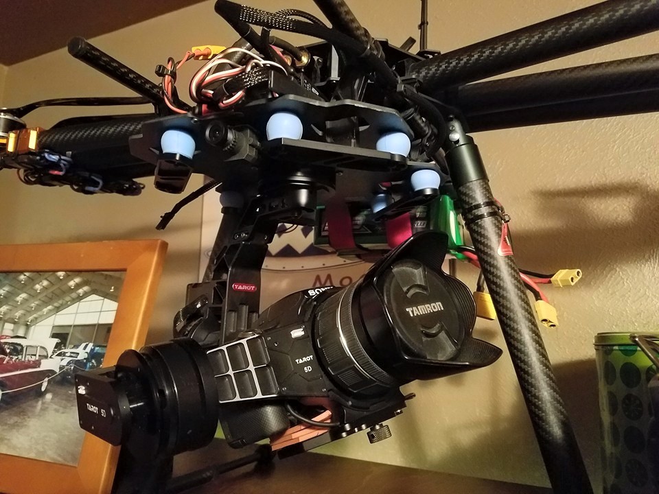

Yeah, once I get the setup done, I will post a video of the completed system. It will somewhat similar to that. Right now, I've got 2 receivers bound to my Taranis and are using it to control the flight and gimbal controls. No external module.

That would be easy to add in the second module once your ready. That was kind of the path I took
Look forward to pictures :)

Essentially the way that the Linker works is that you have a FrSky module on the back of the second radio. The Linker has a 16 channel receiver within it. You mount it to the back of the Taranis and by doing that, you now have a wireless link between the two radios. I can keep the transmitter module in the second transmitter and only use it when its turned on being that my Taranis is bound to the two receivers anyway. Having the Taranis bound to the two receivers on the 810, the only thing I have to worry about is turning on the second transmitter when I need it. No moving modules from one transmitter to another or anything like that. At least that is how it is SUPPOSED to work LOL! The linker can be found on Alofthobbies.com
violetwolf
Interesting indeed. It sounds like you need to have both radios going in order to operate the gimbal from the second radio I'd think. I've seen this referred to as a "buddy box" or trainer module. This sounds fine for many applications. In my case though I have my gimbal on a quick release and all the radios and links are self-contained on the gimbal, so that I can simply detach the gimbal from the copter and slap on the handlebars, or throw it on a jib etc and use the Cam-Op radio. With a buddy box I would need both radios in these scenarios.
But honestly I think it would be fine either way. Both have their advantages.
