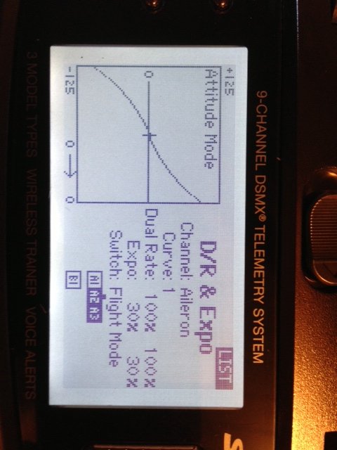

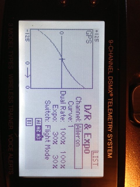

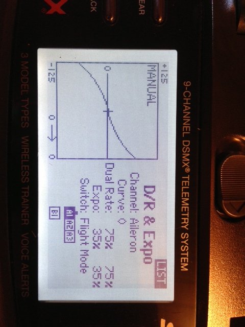

Sorry for thread drift. Good info Earl. Definitely aware of expo/DR in transmitter. But you bring up such an interesting point - tuning in manual. Essentially, we have found that the different flight characteristics between manual and ATTI is a flight controlled D/R and expo. In manual the bird is super hot and sensitive on the sticks compared to ATTI/GPS. With the DX9, it looks like you can change D/R/expo as you change the flight mode - for each channel (aileron, elev, etc). I posted some pics below. I haven't flown on those numbers! I just punched them in to demonstrate. Does that look something like what you mean by switch in Expo, Earl?
Still, I am perplexed about the throttle issue. If you are more than say 10% away from 50% throttle in manual to takeoff, whether it be below 40%(overpowered) or above 60%(underpowered), the heli will sharply ascend/descend when switching between flight manual and atti/gps.

when they jump flipping into or out of manual means your not propped to run 50% throttle hovers. say if it hovers at 40% manual, if you hit the atti switch it'll go into a certain drop in m/s instead of in motor speed. same the other way, flying in atti and the rig is propped for 40% hover, if you drop it into manual it'll go up most likely fast cause your not at 40% stick position, you were in 50% for the atti hover......
it's two different way to control a heli, one being a metered rise and drop in m/s, other being through grunt going for it.... i like the atti
rocjock
Hey Kloner. Yeah, thanks. That's what I am getting at. Lots of people aren't at 50%. Especially if switching between cameras for example. Are you saying there isn't a work around?
Yeah, kloner really has the best advice. Tuning expo in manual is just something I do in case all heck breaks loose. I practice switching over in tall grass once in awhile and I have found I have to be right on the throttle to "catch" it. You really do need to practice it if you expect to actually respond quickly and correctly in a panic. It's just a personal thing but flying DJI has taught me to expect the unexpected. I just recently figured out that a too-close-to-the-gps battery minder of all things was affecting the GPS - causing toilet bowl and other anomalies. Move the thing away from the GPS and all is well. If I had been flying fpv with that little mistake, and it started toilet bowling a half mile out, I would have felt comfortable switching into manual.
