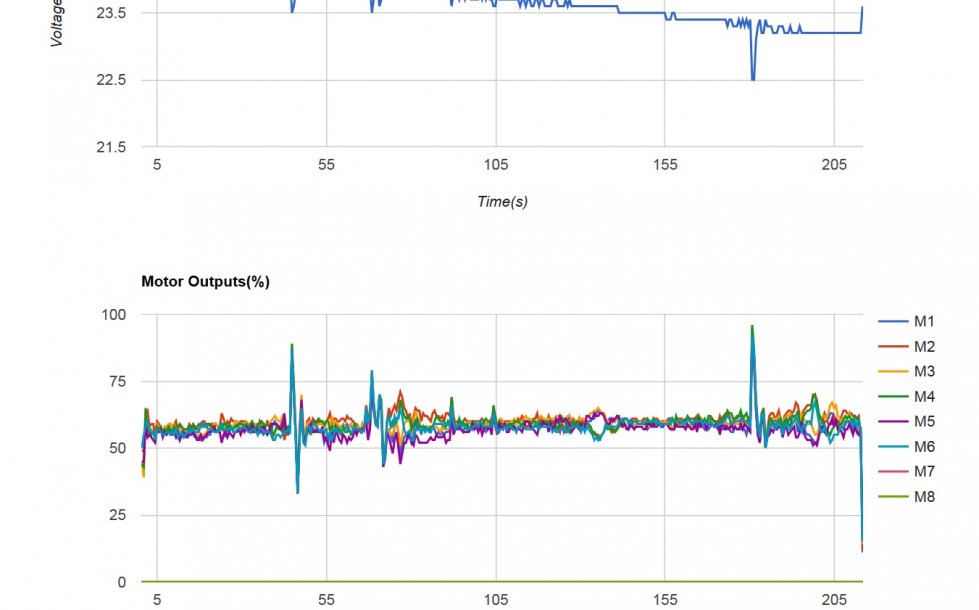

Last time I'll bore you with log results since I think they're dialed in good enough to move to the next point of getting some test flights with some more dummy weight added to simulate having a gimbal and camera on. I went out yesterday for three short, 3 minute, flights and tested hover in GPS and Atti to see how the motor outputs and vibrations levels were after concerns the day before that the output levels were higher than I expected due to fast foward flight tests. The last three logs show very good, imo, motor output and vibration levels. First flight - 134.1.03.33 - was in GPS, hovering about 15-20 ft up and doing a couple steep climb outs as Moto described Kloner recommending. Motor output well matched with a couple spikes at climb outs. Second - 135.1.02.59 - was in Atti, same hover with minimal stick input to correct position with same result, third - 136.1.02.23 - GPS and a couple ff moves and return to home since batts were near LVCO. Very pleased with results, thanks for working through this with me, I was almost ready to throw in the towel...
http://log.xaircraft.com/#2015_08_20_054631.000_136.1.02.23
fltundra
Your getting a little close to 100% without your camera and gimbal. Do you have a current sensor on board? Your going to want to know what it was on those climb outs. Because I think you probably need a higher c rated lipo. I am not for sure, but that was a pretty good voltage drop. Your max climb was 5.03 m/s, and if there's enough power it will do 6 m/s.

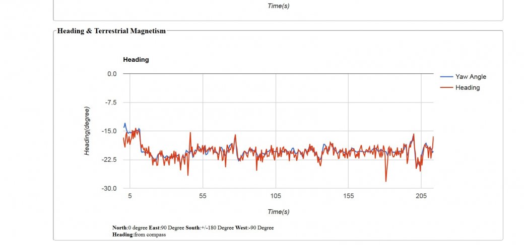

Something going on also with your compass and heading. Lines should be perfectly parallel. Do another compass calibration by itself, and you don't have to go through the full routine. Anything mounted close to it?:)

fltundra
Ahh,.... Gps is to close to the batts
Raise it,;) just the current flowing through those wires creates a magnetic field. As far as the batts go. Do you have a charger that measures IR.
If so take a reading and lets see where they are at. Other then that, what gauge wire do you have going to the PDB and what's the total wire distance from esc's to batts?

Thanks @fltundra What do you mean don't go through the full routine?
Meaning you don't have to do stick cali again, just go directly to compass cal. Same goes if you just make receiver change you only have to do stick and neutral point cal. I haven't calibrated mine in over a year and lines are always parallel.

fltundra
Distance from batts to esc? Not near machine right now but my guess is from batt to Y tail. 6", Y tail 4", EC5 connector to provided AS150 connector 6-8", provided AS 150 power cable to PDB 12", PDB to esc 6". Hope that everything.
Need to see some pics to help you more. But right off you need each batt going directly to the pdb. You want wires as short as possible between batts and escs. What gauge wire are you using for the batt connections to the pdb?
SamaraMedia
There in lies the problem with kits like this. The PDB is mounted to the bottom center plate and has 6 female mini phono type jacks where a cable solder to the esc plugs in. The original design of the kit has the esc mounted out under the motor, I modified the arms so I could get all three motor leads through the foldable arms and move the esc inside the center plates. From the PDB are two 10 gauge wires with AS or AX150 bullets for battery connection, since I don't have those and not fond of them I made an extension with EC5 connectors to work with the batteries I have. Then to be able to run the batts in parallel I needed to make a Y plug, thus the tangled web or wires. I'll try to get you some pics tonight when I get home. Thought I was finding a cheap alternative to the S900 but winding up with a "cheap" alternative in the end. Should have just spent the money on a Hexacrafter or Vulcan hex or X8 and built it from the ground up like I normally would do. You get what you pay for...
fltundra
All you need to do is get another set of 10 gauge wires to the pdb. I think all those extra connectors and wire, plus the Y is contributing to your voltage sag. Make sure they are short as possible without creating any strain on the wires.
