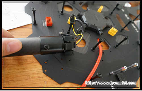

All you need to do is get another set of 10 gauge wires to the pdb. I think all those extra connectors and wire, plus the Y is contributing to your voltage sag. Make sure they are short as possible without creating any strain on the wires.
+1. The simplest solution and the straightest line is usually the best :)
SamaraMedia

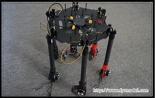

Agreed. Here's some photos from a build log on fpvmodel to give you an idea of the PDB, esc cables and battery wires coming from the PDB. I don't think there is anyway to add another set of wires so my last resort would be to run one large battery directly off the power wires provided.

Yup, after building and working on this rig I really don't think it's designed for heavy duty usage, imo. Nice and intergrated design but very limited in being able to modify, I should have looked deeper into the owners manual to see what the guts were like. It is simple to work on in some regard but limiting in others.

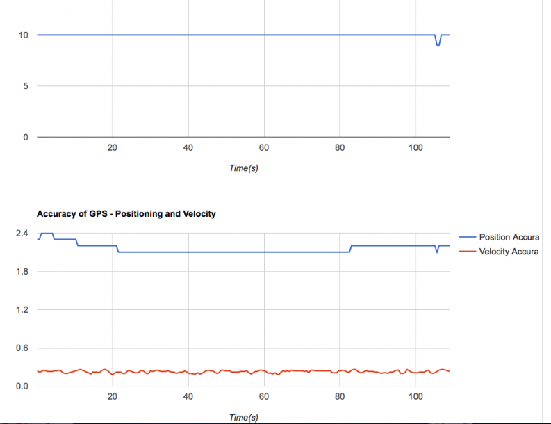

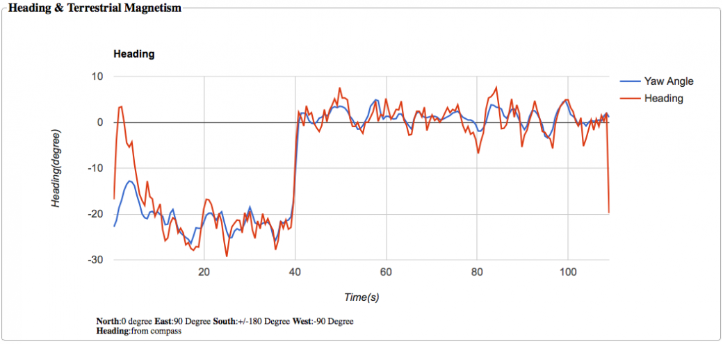

On the GPS issue, maybe it's the unit itself because looking back at older logs before I moved the batteries to the top deck the graphs were whacked too. These are from 8.5.15
