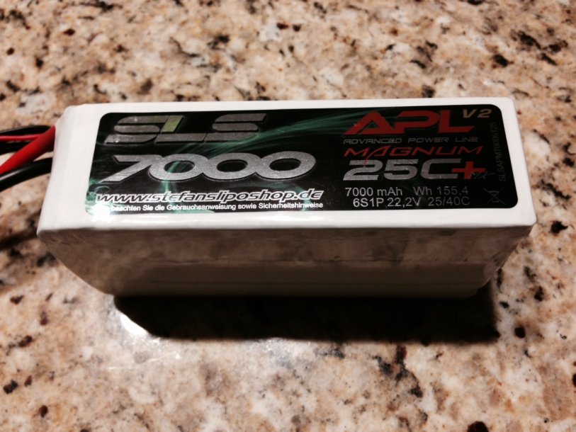

Bought a couple new batteries to replace the beat 5000 6s I was using, hopefully this will help my tuning as a few suggested. These SLS7000 batteries look pretty nice, about the same physical size as my 5000's and weigh just 100g's more each so it should be a power to weight ratio issue. Plan to run them in parallel.
