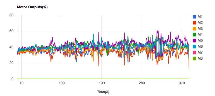

Couldn't figure out how to use the app link in Google Drive, finally uploaded in regular mode. If anyone has time please take a look and see if you can tell me what may have caused my loss of control today. Very strange behavior in GPS mode. Looking at the report things started going wacko just before the 80S point in the motor output chart. Even at the start is seems like 3 motors went to the high side and three went to the lower side of the baseline, nothing drastic but not sure why.
Thanks, John

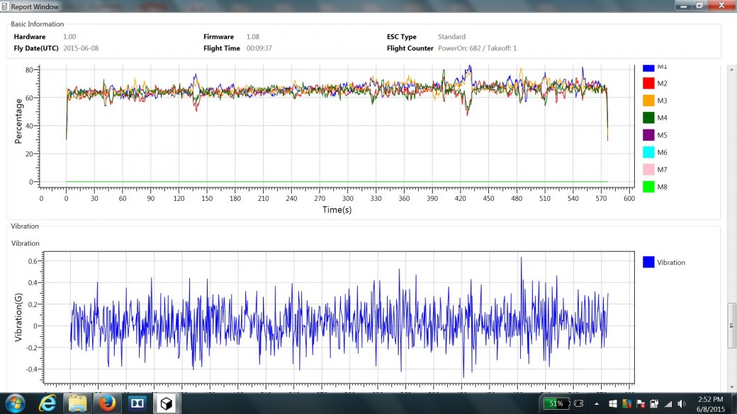

When I first built this rig I had KDE 2814 515kv motors with KDE 35 amp esc's which I had from a 800 sized UAP1 hexacopter used with a Hd3-3D and NAZA. I wanted something transportable and capable of lifting a DSLR or mirrorless camera, thus the Tarot X6. I added the KDE 4012 400kv motors and KDE 55 amp esc to allow me to do that.
After looking at some of my older logs and reports, I noticed a significant difference in the Motor Output chart for the two setups. The old setup seemed "tighter" as all motors seem to start around the same output but with the new setup it seems like 3 motors are running faster than the other three motors so I started to think what I did different on these two setups. The only thing that I didn't do to the new motors and esc's was to do a throttle calibration, not that I forgot, just after reading the KDE paperwork for the esc's and a conversation with Patrick at KDE is sounded like there was no need to do that because they were factory calibrated. On the 35 amp setup I did do the throttle calibration but it didn't seem to work like normal esc's do. Turn on the radio, move throttle all the way up plug in the motor, wait for the calibration beeps then throttle down and wait for the confirmation beeps. Well the KDE don't give the same tones we're used to with other brand esc's.
I did the mid-stick and full range throttle setup on the radio and SuperX for the new motors and esc's but I wondering if that is the reason things went haywire this morning almost causing me to have a flyaway.
Who ever is using KDE motors and or esc's with SuperX please give me your procedure for setting this up.
The first chart is from my original setup, the second chart is from this mornings troubled flight, you can see the difference from the start of the graph and on the latest one at around the 80 second mark.
Thanks all for looking,

I have KDE with superx and I didn't do a throttle calibration. I have always had a slight variation (like your old graph) between CCW and CW on every craft that ran the superx. Vibes were always low, so I never worried about it.
I think the 80 second mark shows the motors trying to compensate for the shift in the hex. Why thy shift happened is still a mystery.

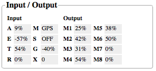

I'll have at it again tomorrow, looking at some of @kloner 's old logs my gains are way low and motor outputs are all over the lot. First logs are mine, second are kloner's.

What are your gains set at in the program? The gain knob shows at -40% also, so you could have been running on a low gain and it was getting bashed by the wind up high like that?
