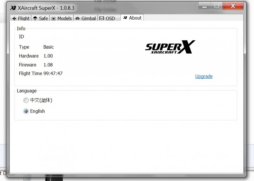

SuperX with Taranis using S-bus, after 15 months I am just one flight away from reaching the 100 hour mark.
Video I posted when I first received my SuperX.

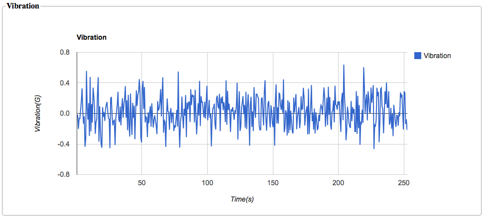

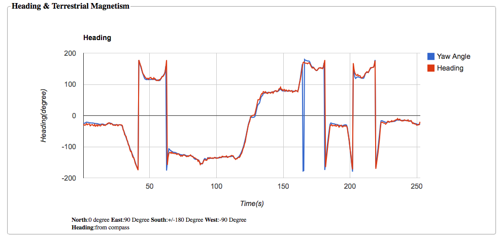

Still trying to iron out my gains and tuning for a Tarot X6, getting closer but finding the altitude hold in forward flight is not great, can someone take a look at my latest logs and see what I might do to correct this.
http://log.xaircraft.com/#2015_07_09_031955.000_109.1.04.12
http://log.xaircraft.com/report.htm#2015_07_09_031955.000_109.1.04.12
Should my Heading & Terrestrial Magnetism chart look like this? Vibration level seems acceptable.

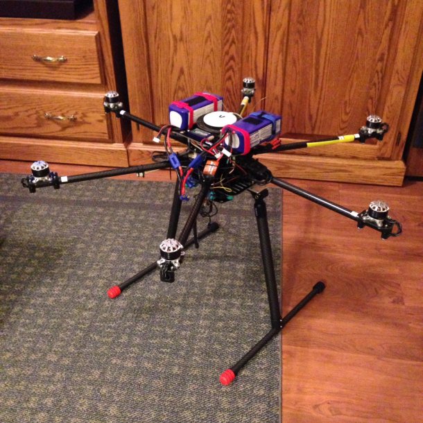

Only thing I see is your gps sat count is low on all your flights. Is this the way you have the gps now in the photo?
If so I would raise it above the lipos and recalibrate the compass.

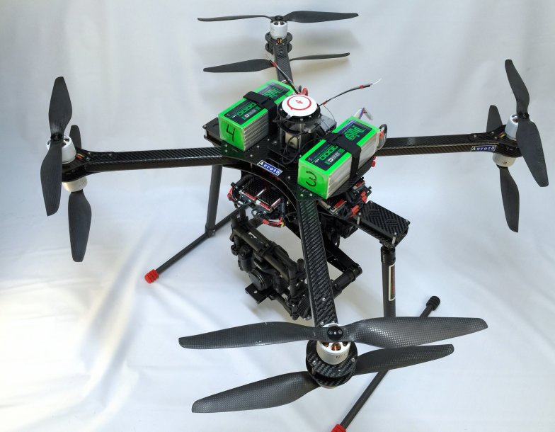

@Hexacrafter - Here's my configuration:
Tarot X6, SuperX and KDE 4012 400kvs, with KDE 15" triple props. AUW is 7659g so about 1260g needed at each motor which is right around the 1270g KDE claims for this motor at 50% throttle. Weight is with 2 5000mAh 6s batts, testing as single battery and getting about 4 minutes flight. Plan to get 10-16000mAh battery for this but for now will run them in parallel and hope for 8 minute flights.
@fltundra - Moved some things around yesterday before test flights. Took your advice and moved the rx under the top plate and away from the GPS puck. Also ran the esc leads directly into the SuperX rather than the using the integrated circuits so that I could move the IO to a parallel placement next to the IMU. That photo is from my first use of the SuperX on a UAP1 frame. Here is a shot of the SuperX and battery plate for the X6. I'm using the standard SuperX GPS puck standoff.
