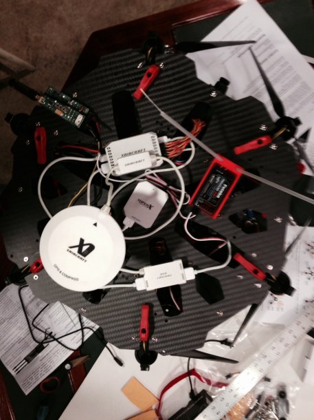

Here's a couple photos of my top plate and where things are mounted. I moved the auto pilot to the top of the IMU this morning, it was on the GPS puck pole on first few flights. Not sure if this will make a difference in my GPS interference or not, any other suggestions as to where I should move things are appreciated.

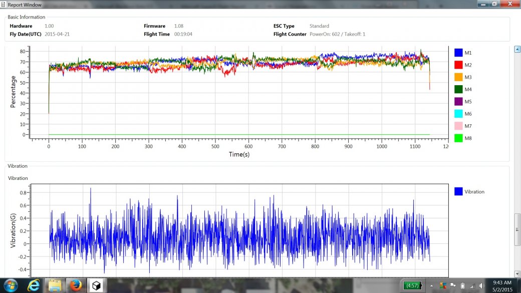

Alignment still needs to be better, motor graph plots should be bunched closer together at beginning and end of flight and clean air hover. Might be CG is a little off. :)
