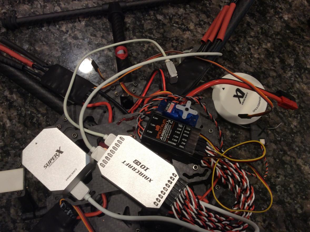

i am connecting the ESC connector to channel 1 of the Spektrum AR9020 RX with the X Aircraft controller powering the RX. The setup is not making tones/beeps to calibrate the ESC's.....the throttle is at 100 % and throttled down as the directions indicate.... I checked out a you tube video showing the process and see that there is a beep when throttled down.... I'm not getting that reaction. I will do double check tomorrow and record the process.... Tonight is nfl football time

I did the process without the SuperX, giving power to the ESC from my PDB. You should get a program beep when powering up with throttle at 100%. If you don't, then perhaps make sure to test your channel and make sure it is properly mapped in your TX. I did so by hooking up a $6 servo and making sure it moved when I moved the throttle.

They are ztw spider opto 30a... Again the XA controller is powering the receiver and I am attaching the ESC servo connector to the throtle connection on the Spektrum AR9020 port.... Not getting any response when going thru the process....
noid1037
Try a servo and make sure there's signal on that channel.
Not to ask a stupid question... I'm sure it's been asked before... How do I check for signal on a channel..... Please elaborate or point to a link to verify the information.... Thanks for the help.
mediaguru
I mentioned previously. You can attach a cheap servo to the outputs of the transmitter then move your throttle. If the servo moves, you know it is working and can eliminate the channel output as a possible problem. I found a servo for $6 at my local hobby shop.
Motopreserve
Are there any beeps at all when you power up the MR without trying to mess with the calibration? Have you fired up the rig and know that throttle is properly mapped to channel 1 of your receiver?
mediaguru"s suggestion of using a servo is an easy test to make sure you've got proper signal coming from the the rolls channel output.

Thanks to the forum here for assisting me in the process to calibrate the quad I am building. Using the a HiTec HS-55 servo to see if there is signal from the Spektrum DX9 to the AR9020.... When the servo is connected to the throttle of the ar 9020 and the XA controller is powered up the servo is making a noise... A very quick clicking sound..... The servo does not move though as the throtle is powered up or down... I do have two servos if that is needed for troubleshooting...to check another channel on the Spektrum rx.

Never mind, I'm getting very close... Had a kink that I was plugging the servo into the bind port.... Dumb momennt

Okay everyone... Ultimate thanks for the help! I have calibrated the ESC's and they came out fine from all accounts... They did a one beep and then a couple beeps....By the way the servo did work on the throttle channel on the AR 9020. Maybe a quick question.... The flight mode does switch and I did the throttle/stick calibration... One thing that is missing it seems is the four beeps of the ESC's...
from looking other videos that I see.... I tried to arm the motors as well... No dice.attached is my video when I power the quad up... Does anyone have a suggestion? Thanks again to all you all!

Seems like you should be getting some type of beeps when you power up. Was the transmitter on?

Transmitter should be on, throttle down.
