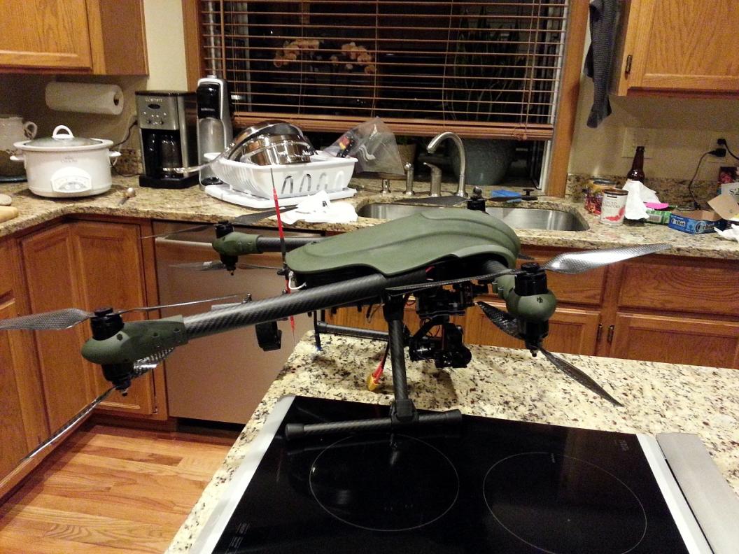

I just got a superx and installed it in a trooper Q700 in an x8 config. I'm currently running into some issues with vibrations/oscilaltions in fast forward flight. This is evident in the brushless gopro footage. I currently have the att gain set to 20% and i'm trying to dial it in by changing the basic gains in the app. I started at 1.2 and now i'm on .9. I'm not sure if the vibrations are from the wind hitting the camera during FFF. The gimbal is mounted on a clean plate and the 6s 8000 pack is mounted to an adjustable CG tube also on this clean plate. If you grab the battery and move it side to side, it does shift a bit and can see it causing the movements i'm seeing in the video. I'm hoping that dialing gains down further will reduce it.

The gopro and battery are on opposite ends. But I think part of the problem is that the battery isn't close enough to the camera and is acting like a lever, exaggerating any little movement it sees. If i'm flying slow, it's pretty smooth.
I attached some pics of the rig. The battery attaches to the cf tube that's extending off the back where the strap is. Unfortunately with this frame, the CG is pretty far aft and I need to push a lighter battery further back to get proper CG. As an experiment, I can try adding another battery. That would allow me to push the batteries further forward. I could also look into stiffer dampeners or mount it direct to replace the ones that came with the frame. Here's a different shot of the mount: http://www.rccanada.ca/rccforum/attachment.php?attachmentid=354481&dateline=1404114611

My vibe issues were solved when I centered the camera under, and put the batteries on top and got rid of the camera/battery counterbalancing gig.

I think in general you're better off centering things up if possible - instead of doing the balance fore/aft dance. The props should be working to keep the center level, not working against odd shifts on weight. Obviously this particular frame makes that a bit difficult with the canopy.
also, it it the photo, or are the booms angled down toward the back???

yeah, that's what I was thinking. Unfortunately there isn't a ton of room on top to mount any batteries. I'll try mounting two packs to shift the batteries more forward to see if it helps.

lol That's because the skids are angled and causing the rear to droop. It's not like that now. The skids are straight now. I can only imagine the amount of prop strikes I might get if I flew it like that.
