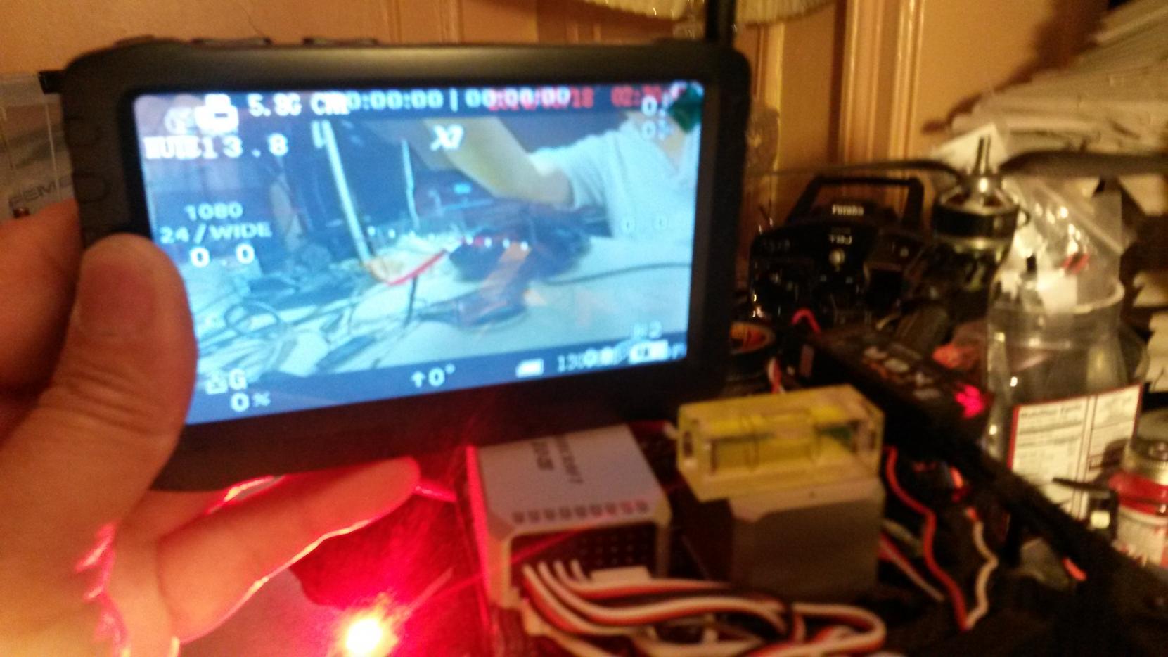

Can any one no the reason why my copter with super x is drifting toward the left it feel like the motor 1 & 4 is spinning more thus the drift i try soft ware delete and re installed but no luck any help here.

Yup it's at 0 I have to put the trim too the Wright too male it stay in one place. Any other suggestions Kloner. The osd.middle level line give me a slight slant to Wright I think gyro I must show you after putting in wave 400 it started to the Wright than I put back to 650 pro it did the same.

your motors are not straight, #3 is off alot#1 is pushing back just a little but will need a new log looked at to verify all them lines stay together better on motor output.... two of the four will oppose the other two as it fights or yaws, but they should intersect and look like a rainbow line...

Yes thank Kloner but how t fix this problem i just bought the kit esc (650 pro kit) and the motor is close to the kit it's 3110 780 kv it new and if you see that picture the copter was level but on osd is not.

Check all the motors with a level - or Kloner has a video somewhere how to get it close using a straight edge. Then once the tyre all level, you'll have a better understanding of which motor is doing what. You can use an app that has a level if you have to. Make sure they're all level relative to the center/FC position.

Thanks Motorpreserve i just did that and alsways do that still goes to left i even bought a new v2 controller change receiver to another one this is my 3rd superx first time it's doing this. Is trhis a run away or pilot error i put it on gps it went backward i quickly throttle down
this was yesterday 650 is code Update i just reinstaled thecf folder the gui too now it working better just little going to the left but that maybe level need to be adjust more.

So far in my experience you really need to have the motors perfectly level for the superx - and also the CoG spot on. It really doesn't want anything out of whack. All FCs probably want this - but it seems to me the superx is more sensitive, certainly more so than multiwii.
I didn't understand your post - did it do the same drifting with the New SuperX? So it does it with multiple versions of the same FC?
Motopreserve, I'm presently running SX with motors turned out 5 degrees for added yaw authority on an asymmetrical spider quad set to Standard X. It handles extremely well with proper battery/motor/esc combo. It does drift left after takeoff but once it "finds" it's spot the rest of the flight is normal. I just let it do it's thing then begin the flight - takes about 5 seconds. It's always done this, even brand new with "normal" frames. I just chalk it up to another one of those idiosyncrasies all fc's seem to have. To me it's the best, least time consuming, flight controller out there at the moment so happy to put up with it.
Motopreserve
I would imagine if your motors are equally angled it may negate the issue. It seems to me that would eliminate 1 (or more) motors working harder than the others to keep equal level. I think the superx has a hard time with motors out of "sync" with each other by a certain amount. See Kloners vibration issues a ways back with his motors only a small amount out of level. My experience has been similar.
Or maybe my version sucks and yours is fine running on 3 rusted motors and broken props. :)
