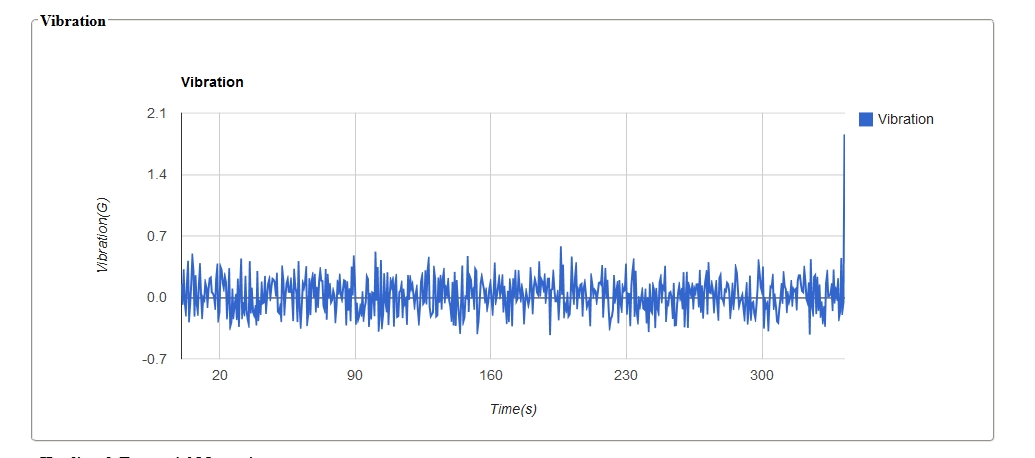

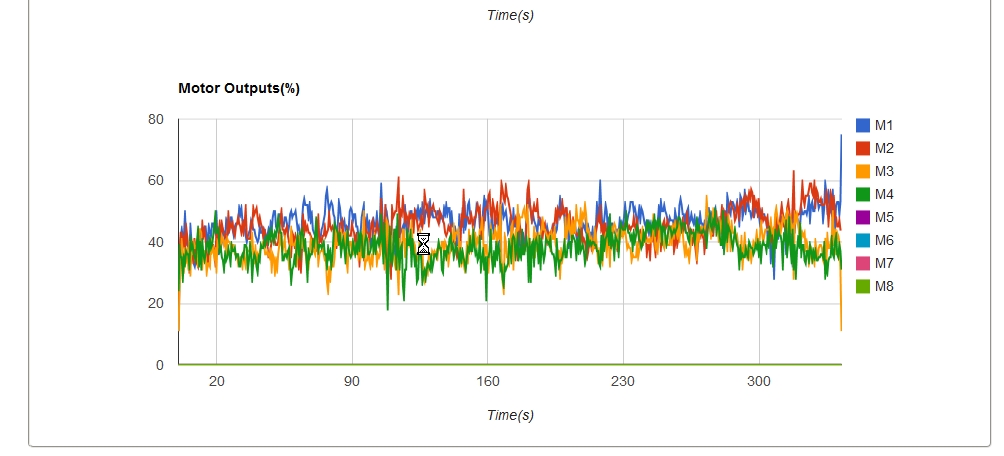

I would imagine if your motors are equally angled it may negate the issue. It seems to me that would eliminate 1 (or more) motors working harder than the others to keep equal level. I think the superx has a hard time with motors out of "sync" with each other by a certain amount. See Kloners vibration issues a ways back with his motors only a small amount out of level. My experience has been similar.
Or maybe my version sucks and yours is fine running on 3 rusted motors and broken props. :)
Ain't that the truth. Seems like our junk copters always seem to do fine. This one isn't quite junk but plush 20's, t-motor 2216-10 and apc 10x3.8 sure isn't clavier.

I hear you. First quad I had superx on was a symmetrical motor mount H-frame with awkward CoG, turnigy f-30a and sunnysky 1250 that had vibes .5 or less. Now on a nicer (or I hoped) Tarot hex with expensive HobbyWing Platinum and more expensive motors the vibes are peaking up at 1.7. Good grief! :)

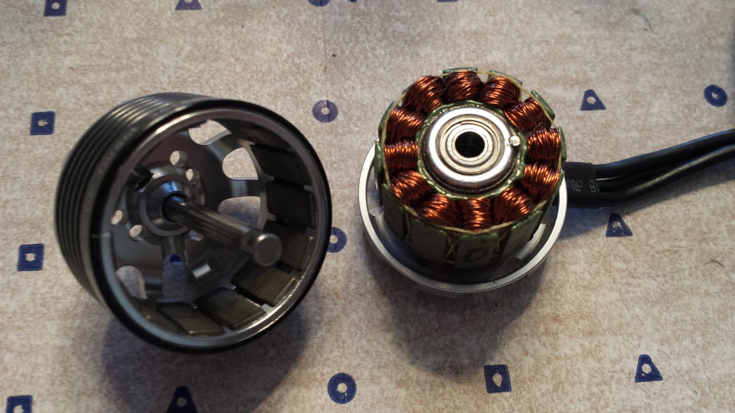

I wish i had the magic answer:) I'm still experimenting, but so far, the bigger props amplify any bearing or shaft play issues i was having made the biggest difference when going bigger props. Kloner was having issues, and then he posted his low vib log, and i was blown away at the progress he made. That's the reason i gave up on the tiger motors. It was either new bearings for me or better motors. Now i know that everything has to be perfect with the motors and props to achieve those super low vibs. I only had 10 hours on the tigers and was already feeling play in the prop shaft.

me to! no more tigers for me, and i assumed they were pretty good:) I'm a KDE believer now, will never go back. Once you hold one in your hand you will understand!

Seems like Sunnysky is best bang for the buck today. The Tigers I use are hobby grade, about same price as the Sunnysky. I think those two come out of the same factory because all parts on their 2216s are interchangeable! One thing to check for is a loose shaft setscrew. That alone will triple vibration as shown on the XAircraft log.

Absolute truth. 10" props and short arms are worth fighting for in a design. I went from 12" to 10" and all sorts of issues went away. Also, it is worth the trouble to track down and eliminate prop and motor vibration, even with 10" props. This vid is from today - same flight as graphs I posted above. Gotta love Blackbox - great tool for finding the issues.
