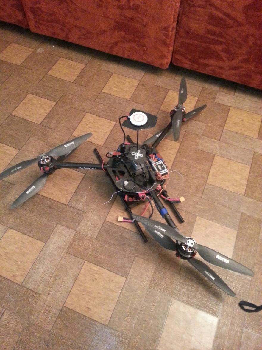

Ok bad luck today perhaps it's Friday the 13 , 2013 i CRASH my new 650PRO that i gave tender care to build it nicely. It started withy cold day sunny i did the compas dance and the trhottle and middle stick procedure from xairamerica video works but did it 3 time cause i was doing it wrong but i got 10 gps signal on oisd i lift off i notice vibration on the landing skid it must be gain is to low but i unplug iyt for my gimbaltilt so i decided use 1 battery and fix that later on gps it hold position nicely windy day around 5 to 10 mph not bad . So i decided use att mode and just get use to the 650 went to far lost orientation that was the first mistake not to look at my video screen just head back but i decided to put to gps flick it to top like i do with dji phantom but on the 650 it was manual so i lost control and crash broke 2 arms and all 4 props lost my anntenna for fpv i try to look for it some where in grass i will go back tomorrow my arris 2000 v5 gimbal is so strong it fine i love that gimbal, Any way pilot error here's the black box report. http://log.xaircraft.com/#2013_12_13_153405.604_21.1.07.43 HERE IS THE VIDEO IT'S SHAKY CAUSE GAIN TO LOW I HOPE CAUSE IT DID NOT HAVE ANY VIBRATION WHEN I WAS INDOOR FLYING. http://youtu.be/tze2XN6ndzQ

A sad day indeed, never nice to crash, rips one's heart out but all a part of the learning process, I have not crashed my X650 YET! but every flight it is in my mind, my previous quad was rebuilt 5 times fully! so I know the feeling.
Chin up! old saying: " what doesn't kill you only makes you stronger" you will get it back in the air and I'm sure you will remember where Manual, Attitude and GPS are on the switches.
When I loose orientation I hit RTH until the vehicle is back in sight then move to Attitude or GPS and continue flying.

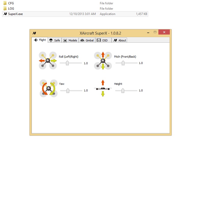

Dhardjono
So it hi not low gains than i did hear a weird picth sound that i did not hear in my living room. Can i check the number thru the gui?
VIQuad
(Ok that's twice now he's asked :livid: )
Can you take a screen shot of your gains so he can see where you have them set?
Or maybe just post them here
Electro 2
So it's high, not low, gains
I don't absolutely know that, it's just a guess. We need to see the numbers.
I did hear a weird pitch sound that I did not hear in my living room.
It's the shakeyness in the pitch that is the issue. The EFC is trying to change the speed of the motors in a too rapid fashion. Not good.
Can I check the number through the GUI ?
Certainly, this is the normal fashion. Do realize any changes made with the "radio" gain, i.e. the knob, *won't* show in the GUI, only the basic gains. (I asked this very question earlier in this thread.) This is the reason I never leave any radio gain adjustments dialed-in between flights. It's not a repeatable, hard referenced, thing. The basic gains shown in the config app very much are.
Dhardjono
Electro 2
View attachment 18903is this what you want to see VIQUAD OR IS IT THIS http://log.xaircraft.com/#2013_12_13_153405.604_21.1.07.43 It look like -43 on the G IF G IS GAIN
Valid point "VIQuad", thank you. And there we go, gains are nominal, with settings at 1.0 across the board. Not a high-gain issue, possibly a low gain issue. The wavy motors thing has me bugged, I'm still thinking wind. Any idea of what they actually were in your waterside Bronx park today ? In the video I see wind. You simply can't fly a 650 class bird in anything over about 15 mph peak. XAircraft says 17, and I'd agree with that. I flew 3 times today and had to get down once because of a gust of 20 or so. Aircraft became too unstable to handle. Landed, waited until it passed, took off again, and was OK for the rest of the pack. This was a with a 635 at 4.2 lbs. If it had been the 1000 at 11 lbs, I probably would have been OK.
