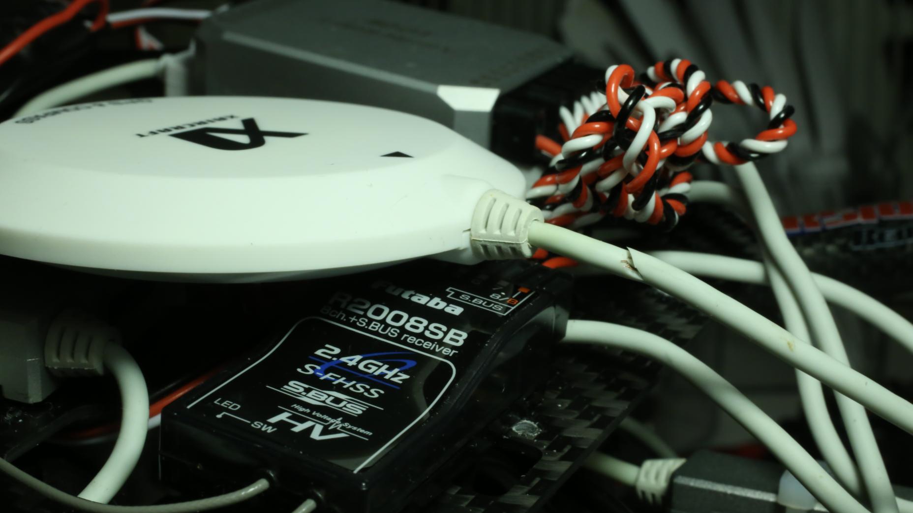

advise :nevreness: It snowing in newy york so can't fly any way here pictures of the damage View attachment 15126View attachment 15127View attachment 15128View attachment 15129View attachment 15130View attachment 15132 Look like the gps has a cut on the cable i wonder if it working all motor are working but i notice the 2 esc that the arms are not damage get a little more warm than the other two. My tx antenna is gone could not fine the circular antenna i wonder if the tx is fixable.
Will this level work for the motor mount View attachment 15131
