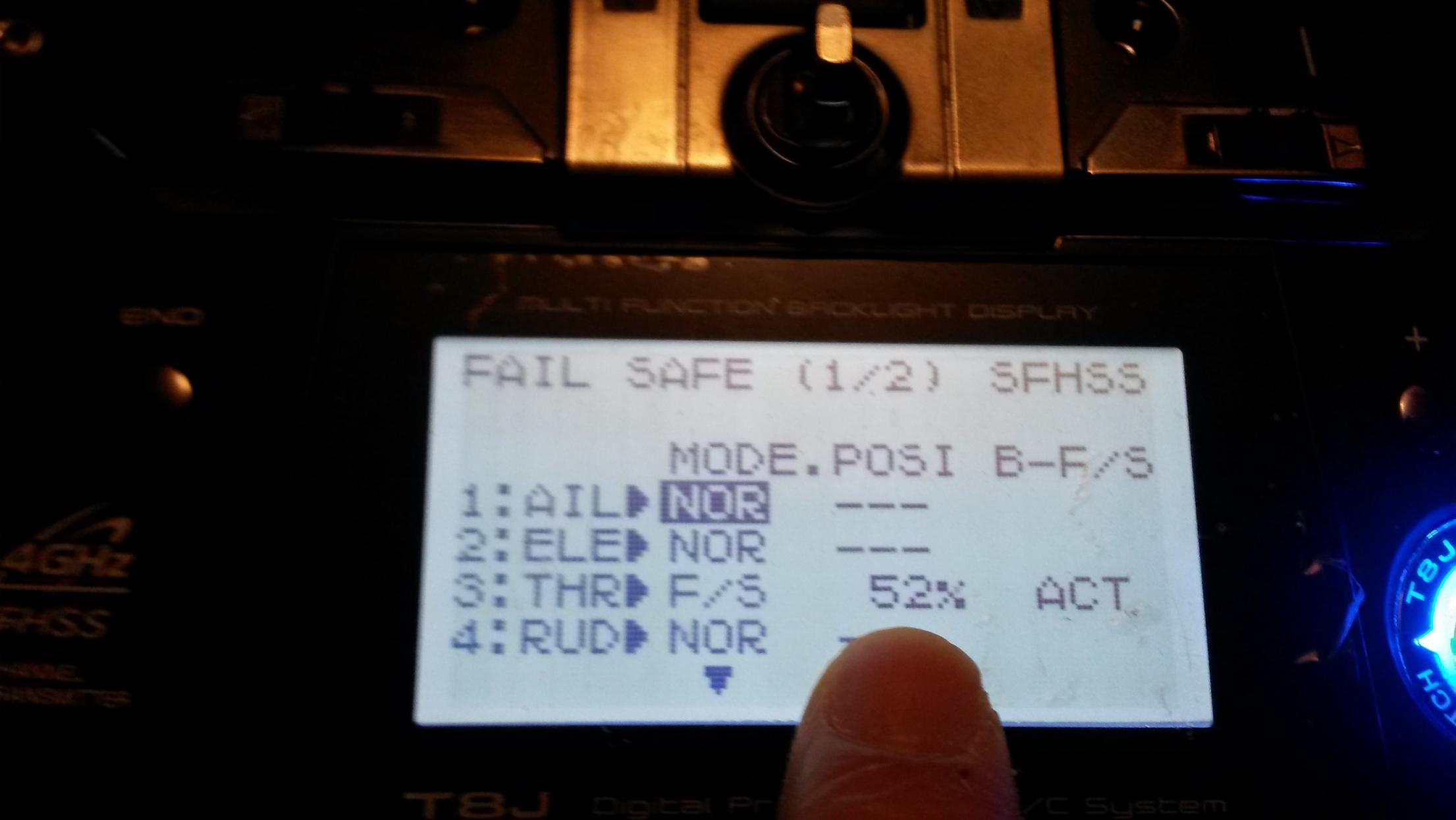

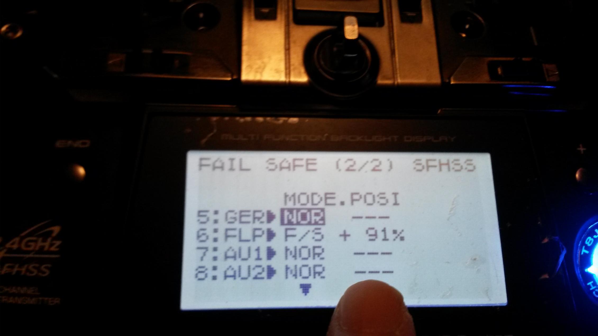

Glad you got it working. It is fine if it is at 91%. Since it is a 2 postion switch it doesn't care whether it is -1% or -110%. It is either on or off.
Explain what you did on your throttle channel again? You should have full range in your servo menu from -100% to +100%. If your throttle channel does not get all the way down you will not be able to arm the motors. Just because you do something on the Phantom don't assume you do it on the SuperX. It can get you in trouble. Be sure to fully read the manual as well and that you have the appropriate channels reversed.
This is what i did i have pictures,View attachment 15095View attachment 15096View attachment 15097 About the gimbal by using the sbus for futaba radio i usually put chan 5 for tilt and chan 8 for roll for the gimbal with the naza but could not do it or there is a way but i don't know how so i try channel 7 for the tilt it works with the VR KNOB but the gain is still on so both working together. So i decided to wire fly it no sbus and now i got the tilt to work with channel 7 and the roll Chanel 8 but i still can not use some of the switch like the g & h switch to make it tilt go down or half way to get those fast shots. I can only use the vr middle knob switch to tilt but i will try again. Thank again for you help before i join this forum did not know there was a XAIRCRAFT AMERICA i thought only china.

This is what i did i have pictures,View attachment 18874View attachment 18875View attachment 18876 About the gimbal by using the sbus for futaba radio i usually put chan 5 for tilt and chan 8 for roll for the gimbal with the naza but could not do it or there is a way but i don't know how so i try channel 7 for the tilt it works with the VR KNOB but the gain is still on so both working together. So i decided to wire fly it no sbus and now i got the tilt to work with channel 7 and the roll Chanel 8 but i still can not use some of the switch like the g & h switch to make it tilt go down or half way to get those fast shots. I can only use the vr middle knob switch to tilt but i will try again. Thank again for you help before i join this forum did not know there was a XAIRCRAFT AMERICA i thought only china.
OK now I understand. It doesn't matter because once you enable the fail safe and go into safe mode the throttle input doesn't do anything. The SuperX will fly back home regardless of the inputs from the controls.

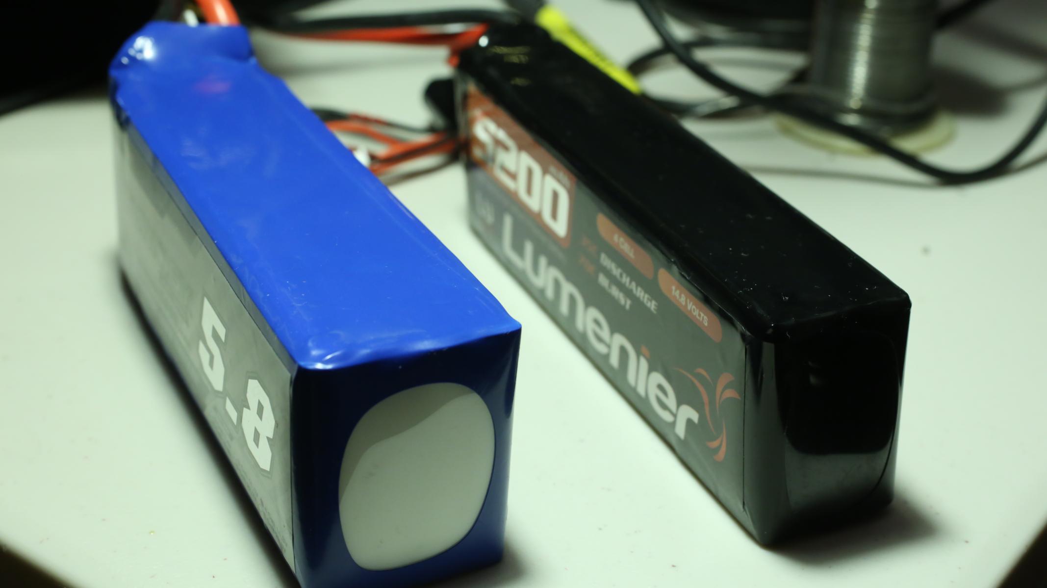

I have one more question can i use my 3 s battery and leave the setting as is i still have some 5000mah 3s ? thanks again
