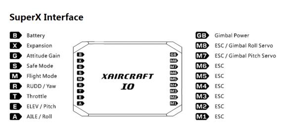

Ok so hoping I can understand the setup needs. Since I'm using SBUS, channels 1-8 are already setup and the SBUS cable is connected between the 8XR and the X channel of the I/O. I have I/O V2. The manual shows the standard inputs for the I/O, but does not specify what number they are in SBUS.
So does #1 start at the bottom at A AILE/Roll or at G Attitude Gain? What is a proper setup for the Taranis-->SBUS-->SuperX?

Just for clarification: sbus doesn't change anything channel assignment wise other than using 1 cable to carry all data for channels 1-8. Once the Tx channels are assigned correctly it's the same as if you were plugging in individual servo cables to the I/O, but it's done internally.
So if you find the page of the manual that describes how to set up the Tx channel assignments, you can follow the Futaba section (it's the top one). I didn't need to reverse (or invert in taranis speak) the sticks. Just set up the assignments as laid out in that section of the superx manual (should be page 10).
I found it easiest to swap the channels around in companion 9x to make it match the superx manual, which is the AETR (ail, elevator, throttle and rudder) standard. But it can be done inside the Tx too.
