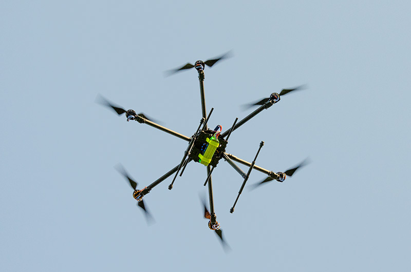

For your enjoyment! I did a "real" flight today. Went out to a big empty field and did some basic, conservative flying. This bird is smooooooth and powerful. Takeoff and landing is SO easy!
View attachment 18998View attachment 18999
