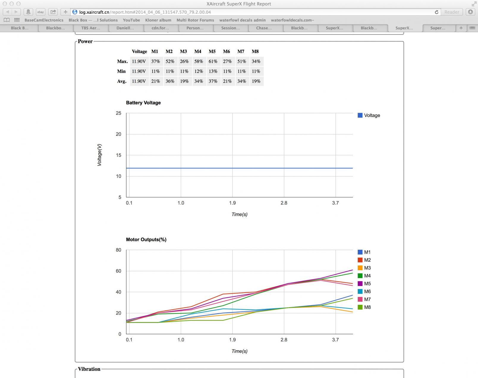

I looked through the flight log to see if I could have reversed the attitude gain setting, but I couldn't find anything in the flight log that seemed to show the attitude or secondary gain setting. I'm assuming that the positive setting on the transmitter is the plus gain. Wondering if I could have the gain reversed, I tried to reverse the setting on that control and tried a quick lift off, but it just wanted to tip over.
the last flights when you barely powered up then back down still shows octo, you have to change it in the gui to quad.....
for sure your motors on the octo are not level, nothing to watch, see the varying motor outputs, 90-50-90-50-90-50-90-50

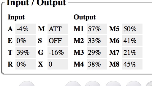

Thanks Kloner. I think this flight log was from an octo flight. It looks like positive gain on my radio (Spektrum DX8) is not positive gain on the SuperX. Good to know. Curious why the motors seem out of level - the level says they're level. I'll keep trying...
I was having the same issues with wrapping my head around how the gains worked. Like you, I assumed that the software was "tuning" and the rotary knob was "fine tuning." But as Kloner describes is the more appropriate way to think of it (and how it actually effects the craft).
Also, just a heads up: in trying to figure out all this, Anthony from Xaircraft (very quick responses and helpful) mentioned that Taranis (could be other brands too) often don't equate what superx thinks of as zero and maximum additive/reduction to the atti gain. So for instance on a rotary knob, center might be -6, full left might be -30, full right might be +106. You can adjust this within the Tx with sub-trims to get the throw correct, and that it lines up with what the SuperX wants to see. My Futaba is definitely off, and needs to be calibrated with the aux channel send.
Out of interest - are you possibly flying with a Taranis radio? Another customer was having issues with his remote gains always starting at -18% and it ended up being a slight glitch within the remote. Basically the Taranis' idea of centre was different to SuperX and he had to add slight sub-trim (4.5 I think) to get it to start at zero.
You should be able to check this by powering up and running the gamut on the rotary knob, and then checking it against the G channel section of the log. To make life easier, you can delete the last log you ave in your SuperX when mounted as a hard drive from the log folder - that way the next round of tests will only show your latest flights/take-offs. Makes life easier. And you can rename the file as well for backup (black box will still recognize it).... makes life MUCH easier. :)
