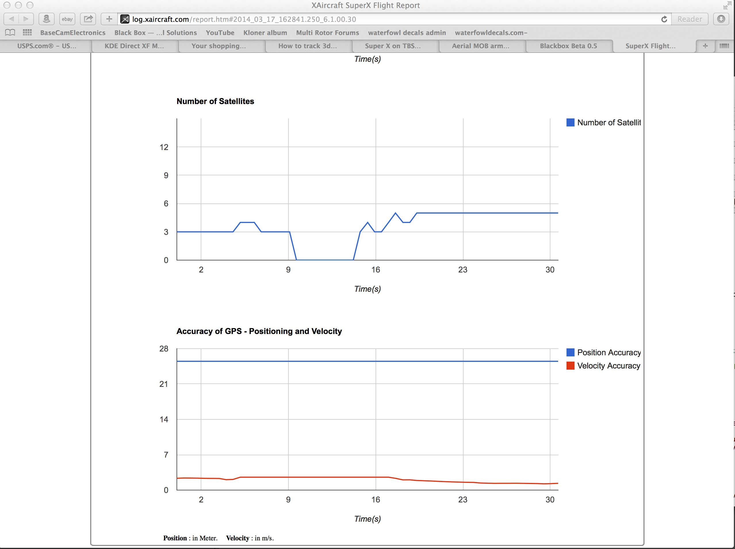

you need to upload the file x.log to http://log.xaircraft.com then copy the url at the top of your screen and post it here so we can see it, we want the last log you flew, set to that log in the upper right corner before getting the url copied so we see the right file....
Musky78
GPS error is probably because this was just a test hover in my basement at about 2-3ft off the ground. I don't yet have your Carbon arms, I'm still on the DJI arms
see this part, that's crooked motors....

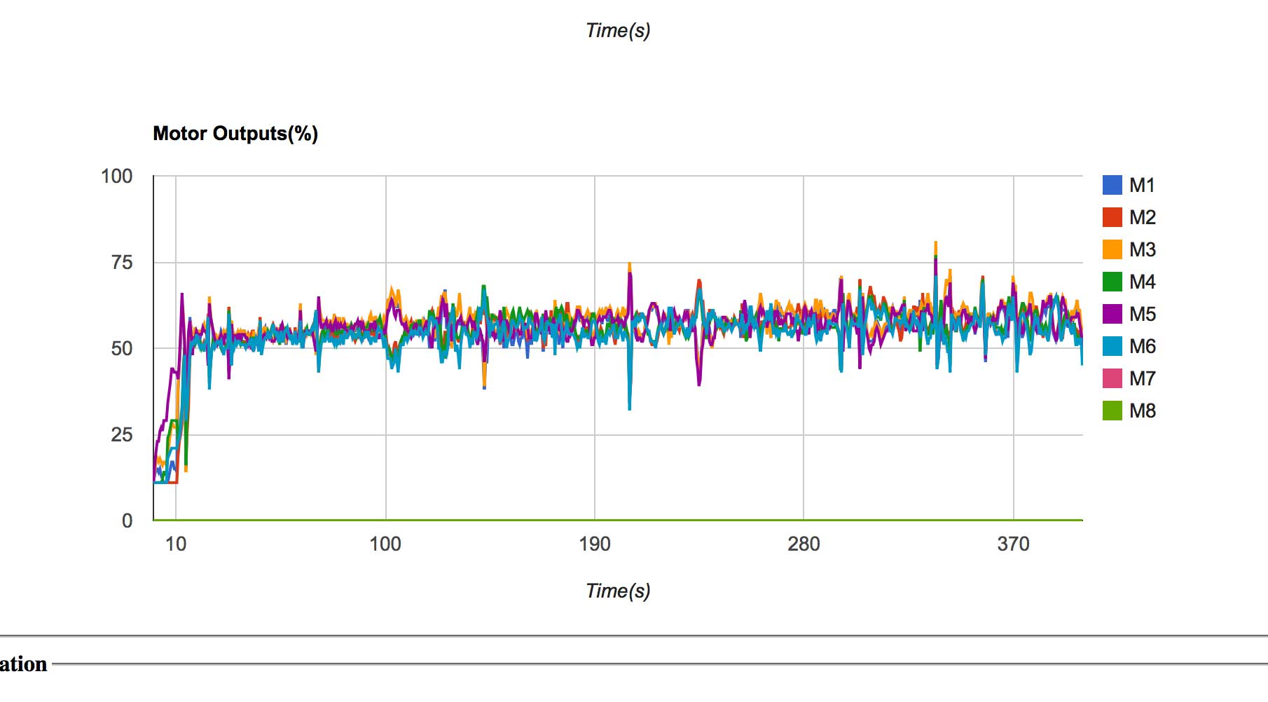

see the voltage sag there, where you fire it up and the battery goes down then stop and rises, wow, is that a known bad pack? need a higher c rated pack

I'm the one doing the cinetank. Should have it together by tomorrow. I'm sure I'll have some tuning to do. My first shot at round booms.
Nice work nailing the unlevel motors. If you have been able to tune it out so that it flies decent now, making sure the motors are square will fly a dream.
