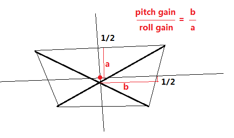

I tried it on my XY8 and that was the one rig the SuperX did not like.
Seems like it did not like the squished configuration. It flew but had oscillations.
Drew sent me the following diagram to try, but I had to use the system on another rig, so i put my HFP back on teh XY8 so i could just fly it.
He also said the Xaircraft engineers recommended the following: They recommend having a smaller pitch gain than roll gain in the software using the formula in the photo.

I'm sure an X8 is not a problem, as it's equal distance between booms. The XY8 is a squished version of the X8, where the front and back booms are 50% closer than the right and left booms.
