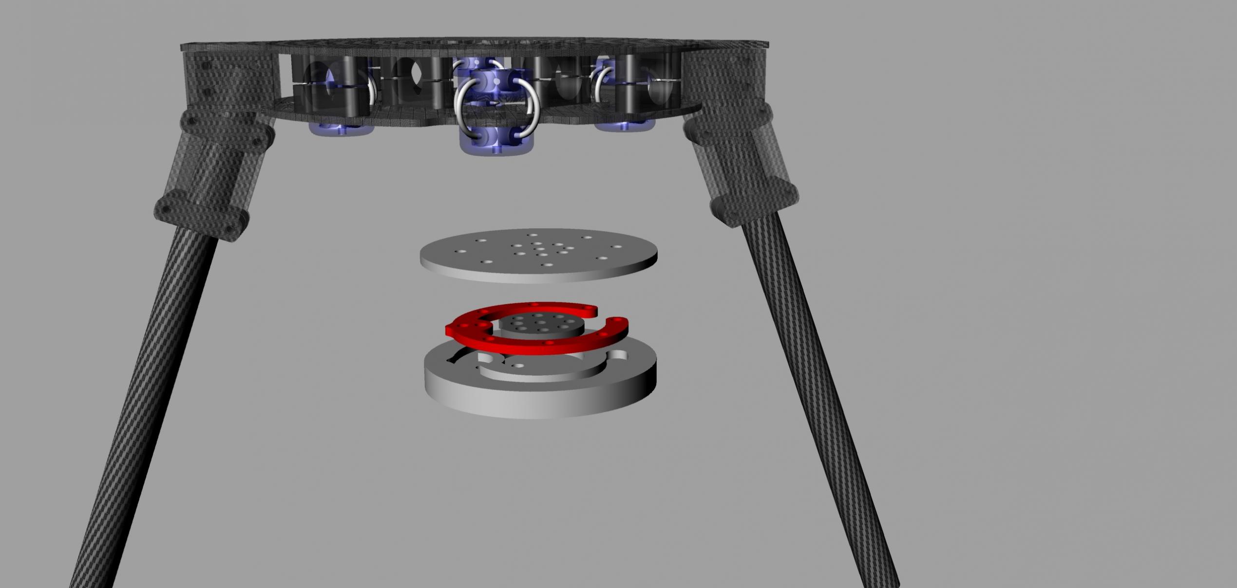

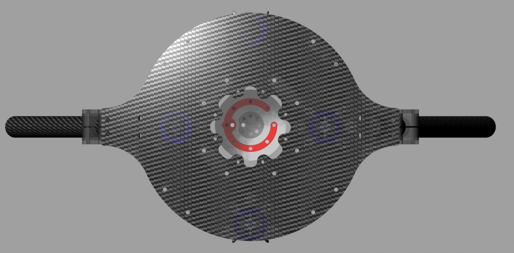

hmm think about watter cutting two copper rings as distribution and enclosing them with some 3d printed parts. Additional parts not drawn yet, cable fixtures and holder to mount BECs direct to the case of the distribution.
Any thanks should work or ? anyone have any reliable calculator which copper mm3 can take this or that amount of A ? Although i think a 5mm x 3mm ring should be more than enough ?

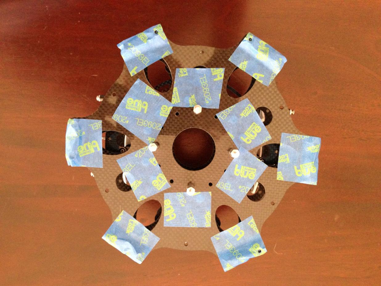

Hi Breezemont,
yeah thanks for the tip !!! I already had my troubles getting parts of :) Up to now i an only printing in PLA didnt install the heated bed yet ! I have akward behavior often. Knowing when the first few lines are drawn if the print it going to be good or not. So sometimes the PLA just doesnt stick, than on the same settings nothing changed quickly start the same print again and it works perfectly. Little strange.
Boris if you rub the blue tape on the acrylic bed with kitchen paper and rubbing alcohol the first layer sticks every time. Sometimes it even sticks too well needing new tape after a print.
Thanks red I will try that. Which belt tightening mod do you use ?

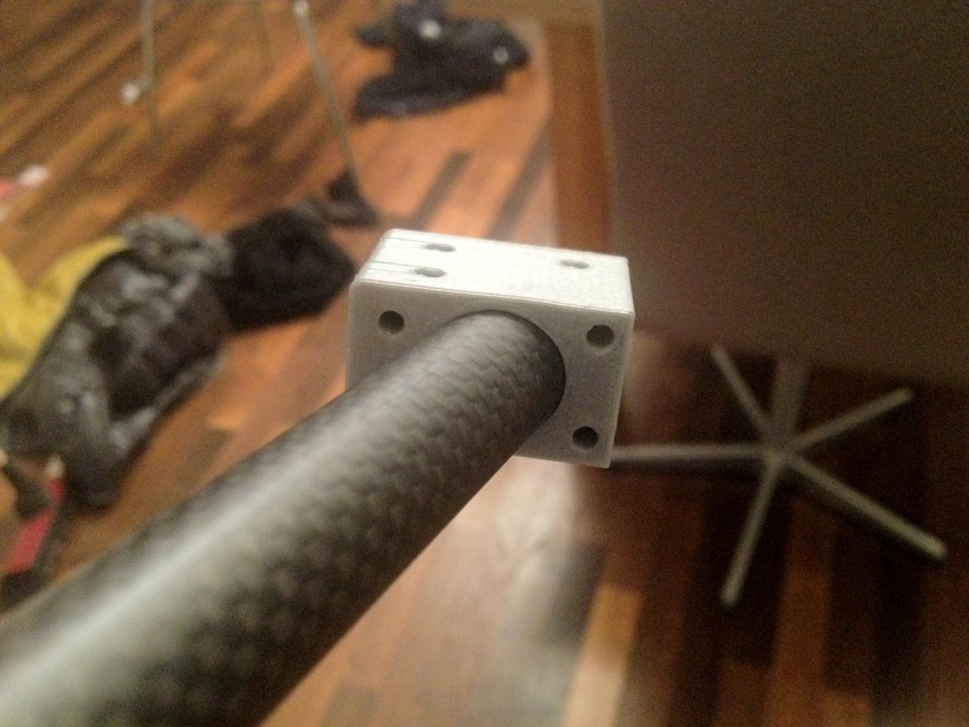

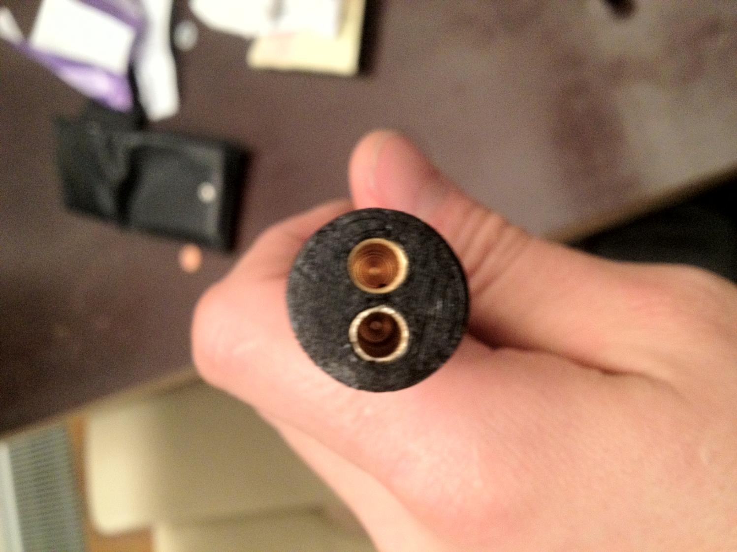

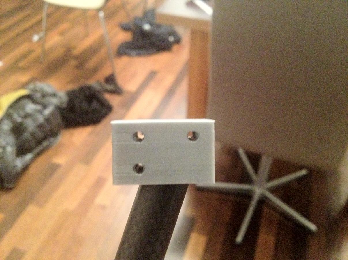

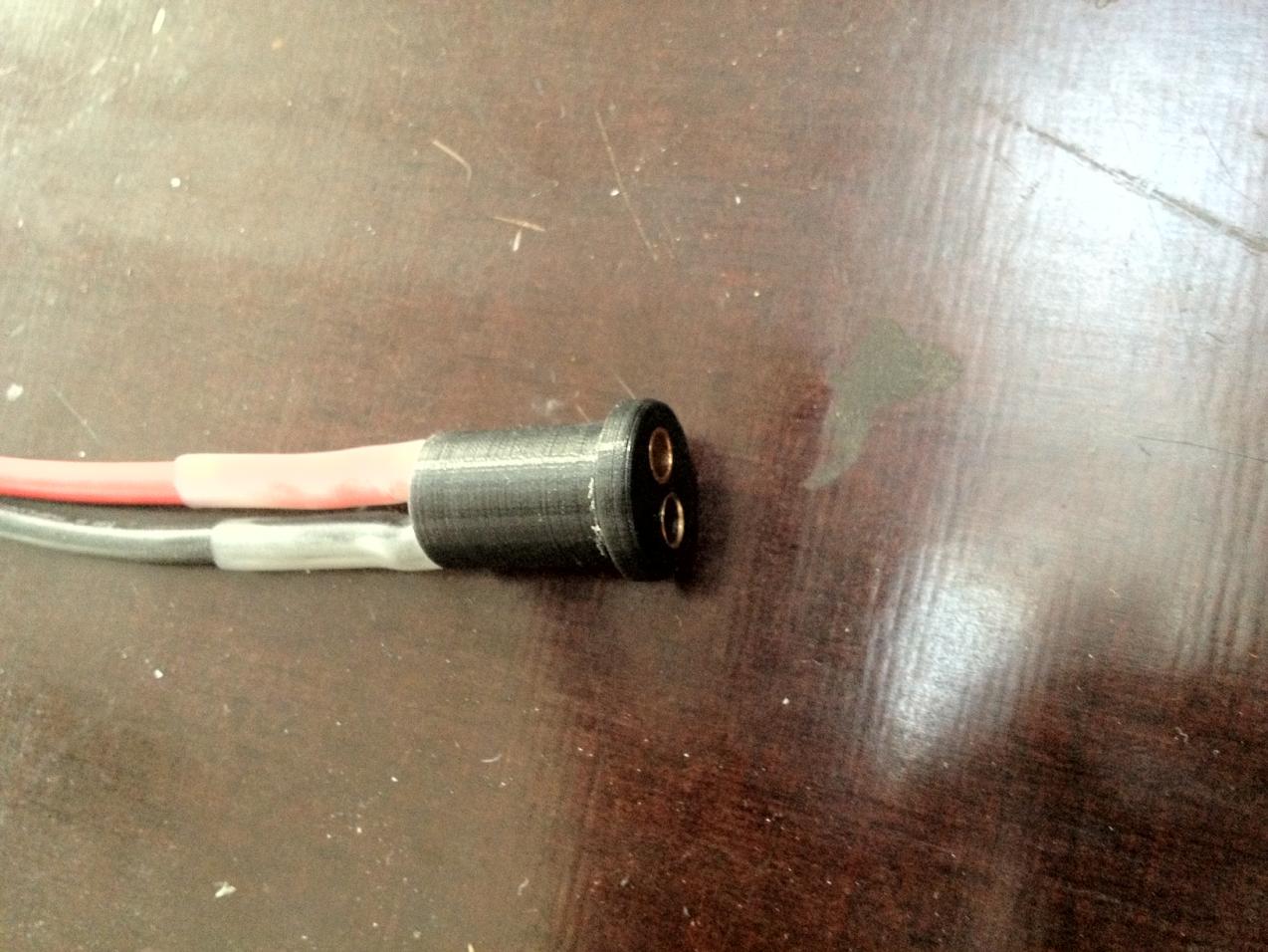

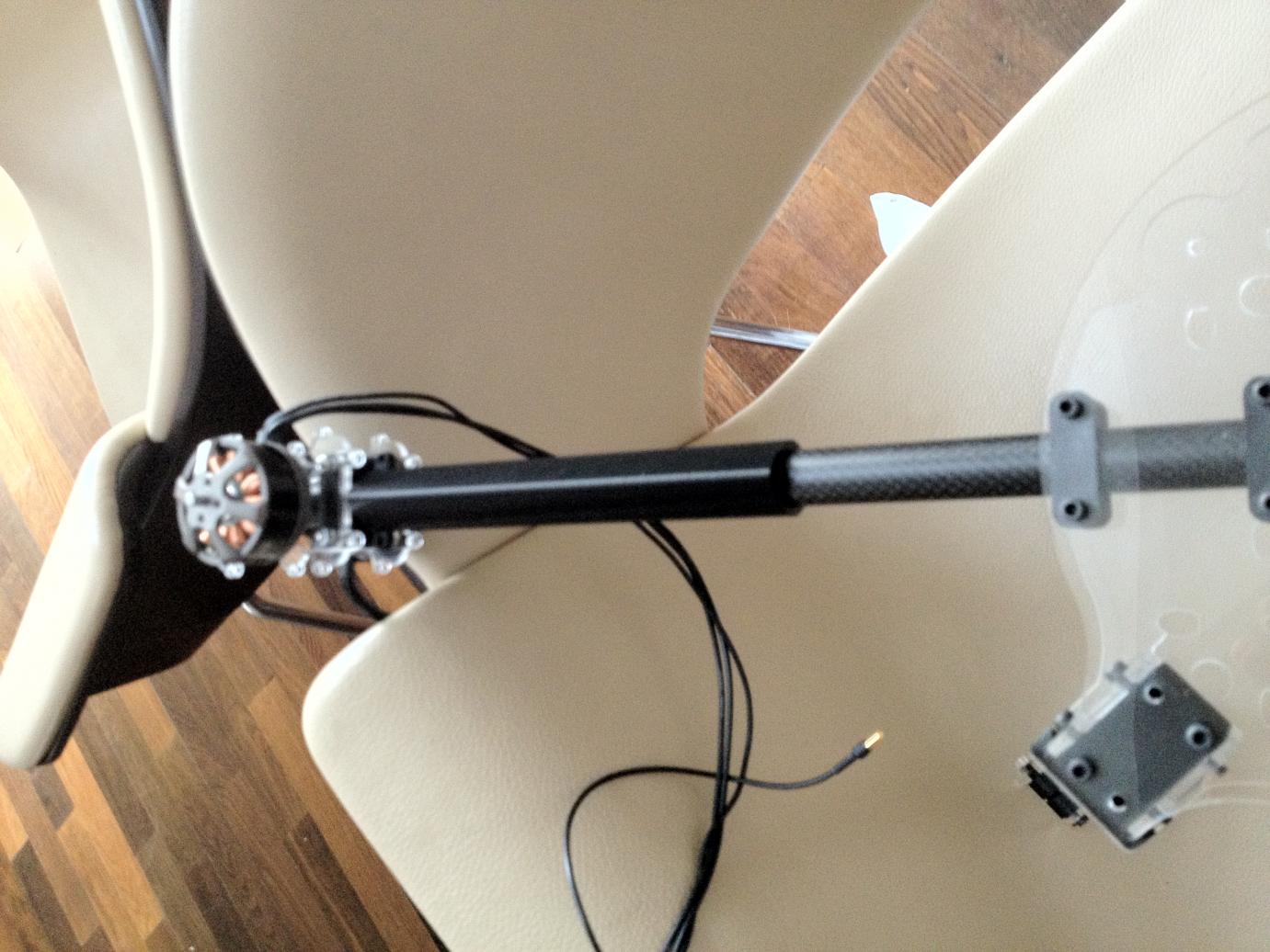

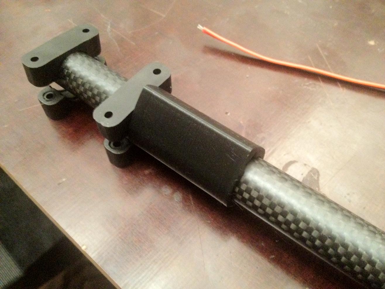

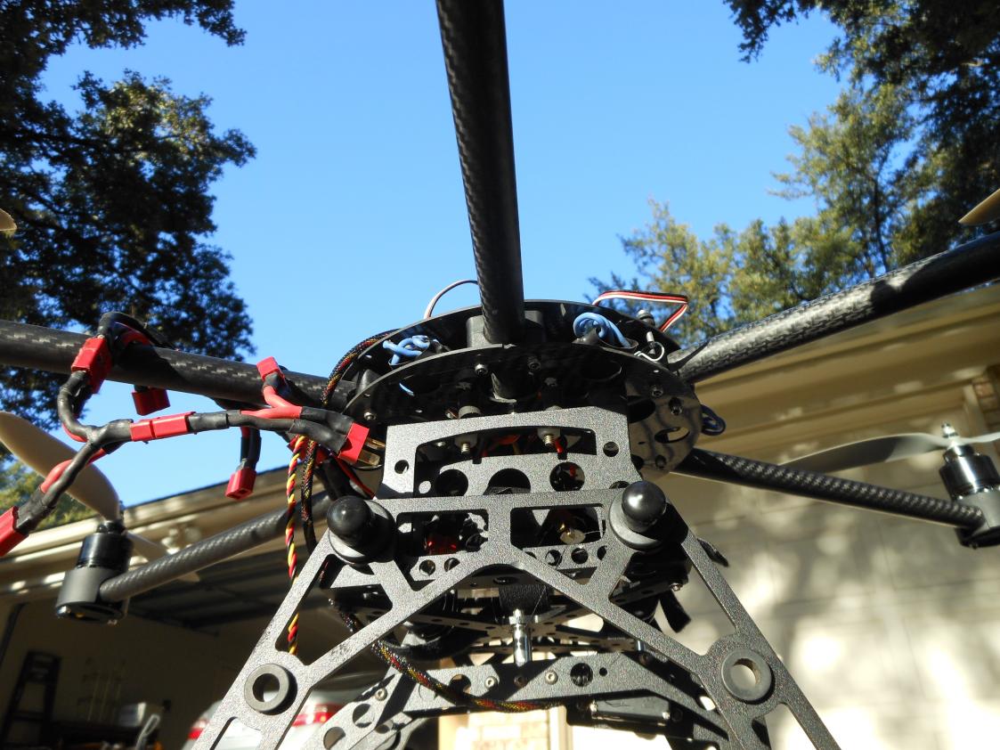

I think the plug n play arms are genius and hoping become the defacto standard.
lets see how it goes there is a reason why there aren't to many systems using swaddle arms, risky if it doesn't really work !

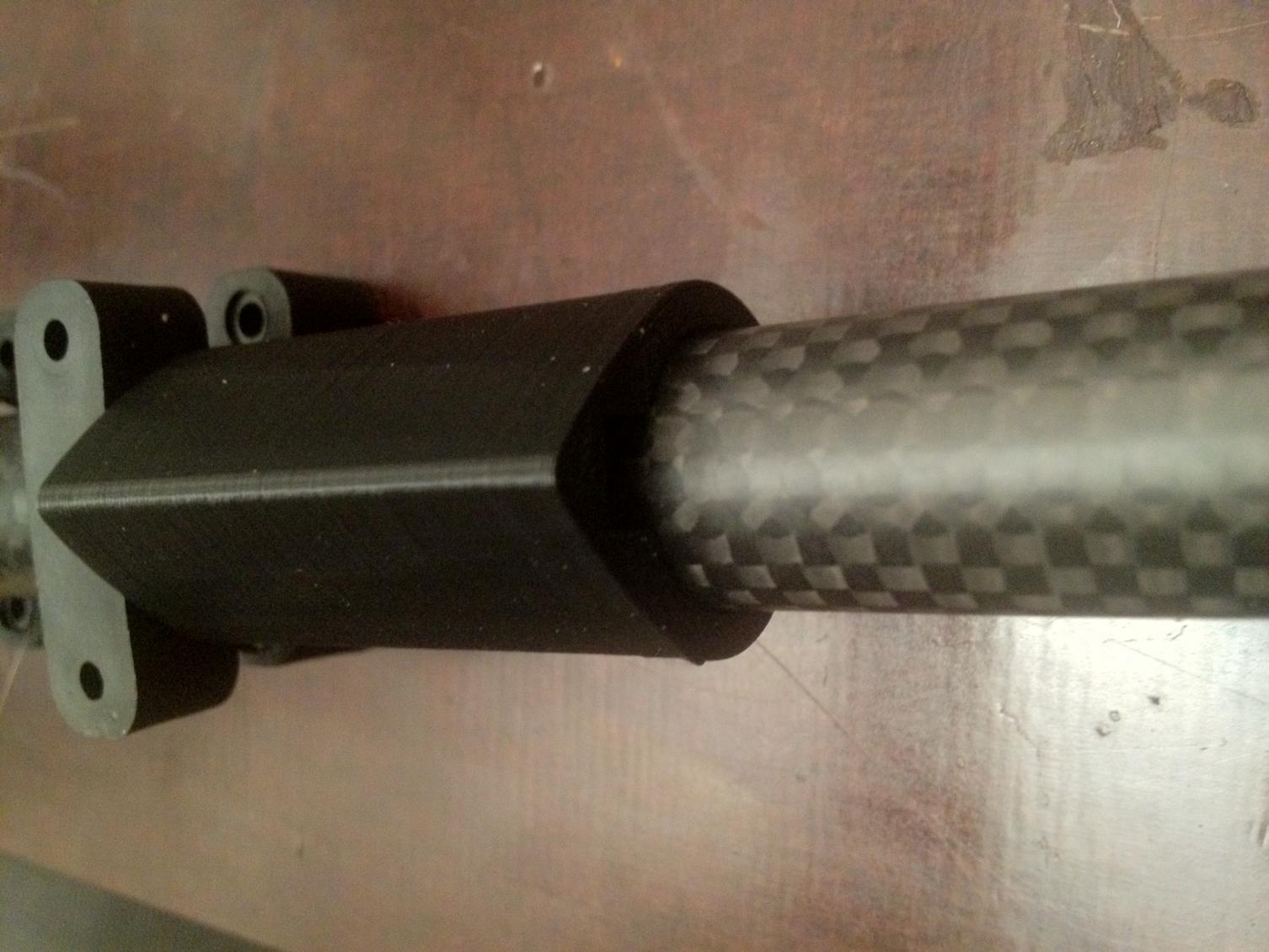

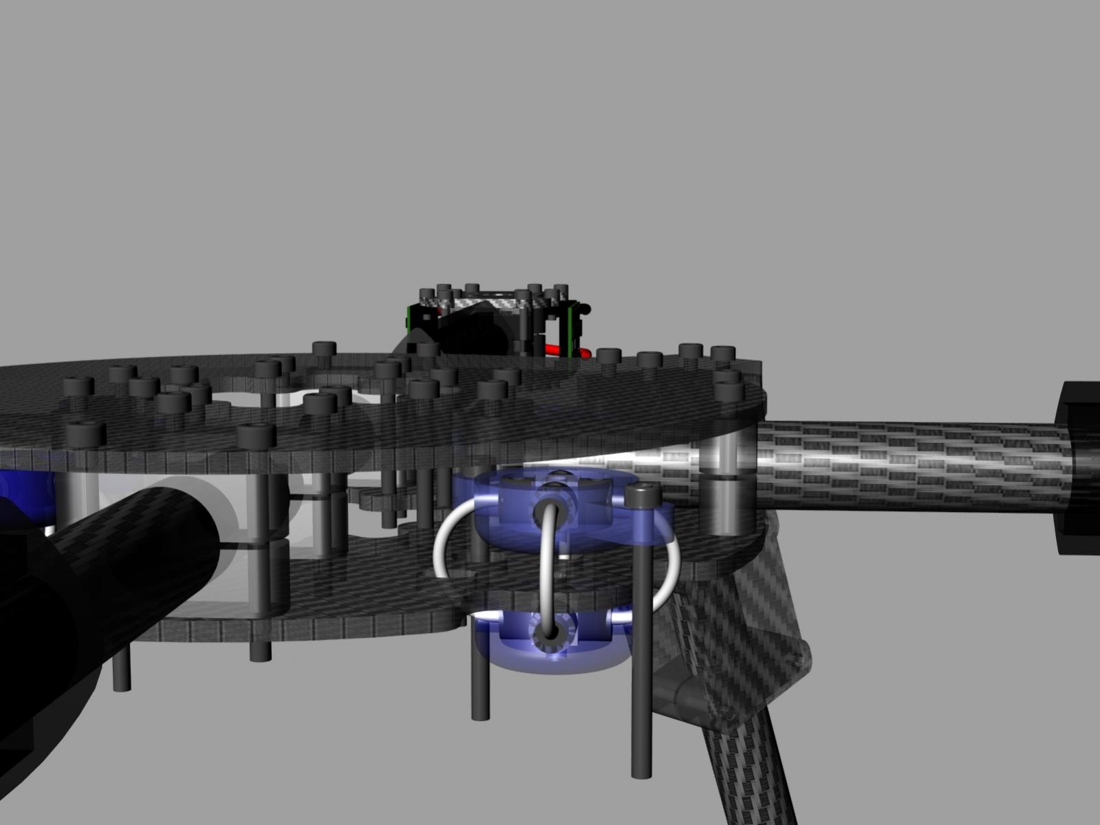

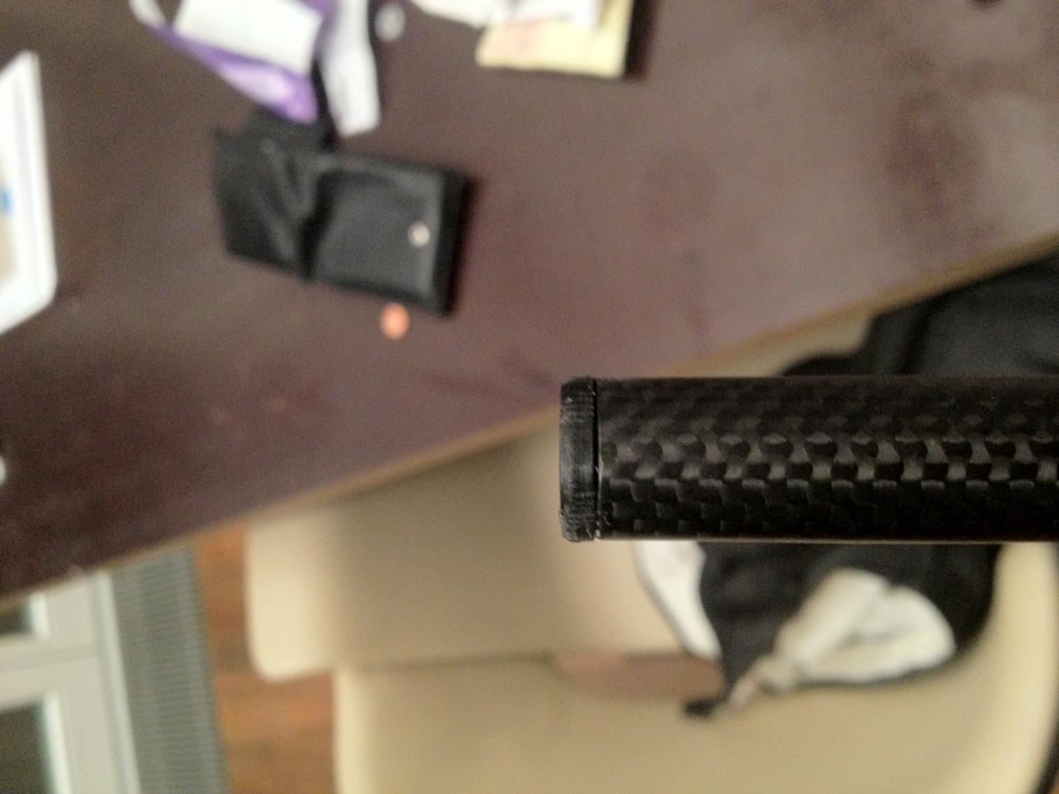

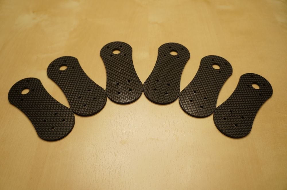

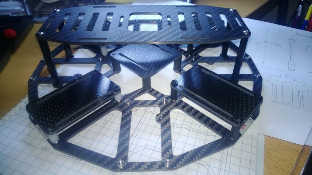

Designed some Nacelles which will also hold the Wires for the ESCs. ESCs will be mounted on the side of the motors with flexible PLA. Still have to think of a plugs system of the end of the Nacelles for the servo wires to the FC. Probably i am going to use a AQ FC anyways. So directly soldering to ESC and to the AQ FC of the servos wires for the ESCs and only pug step at the nacelles to remove the arms.
Nacelles are super light like the fact on none structural important parts that the destiny of the internal structure of the parts can be put down to have the prat become super light !

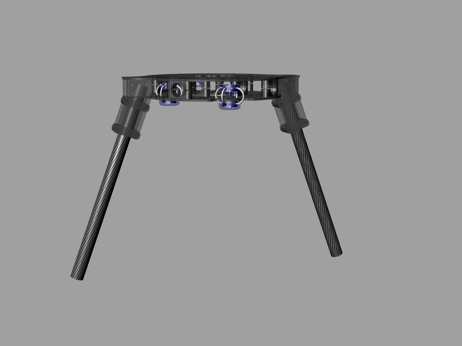

Secon render finished piece for the end caps of the Landding gear ! Actuall end caps and structural part in one to hold the landdingear and the plates to further hold the landdingear
View attachment 9791View attachment 9792View attachment 9793View attachment 9794

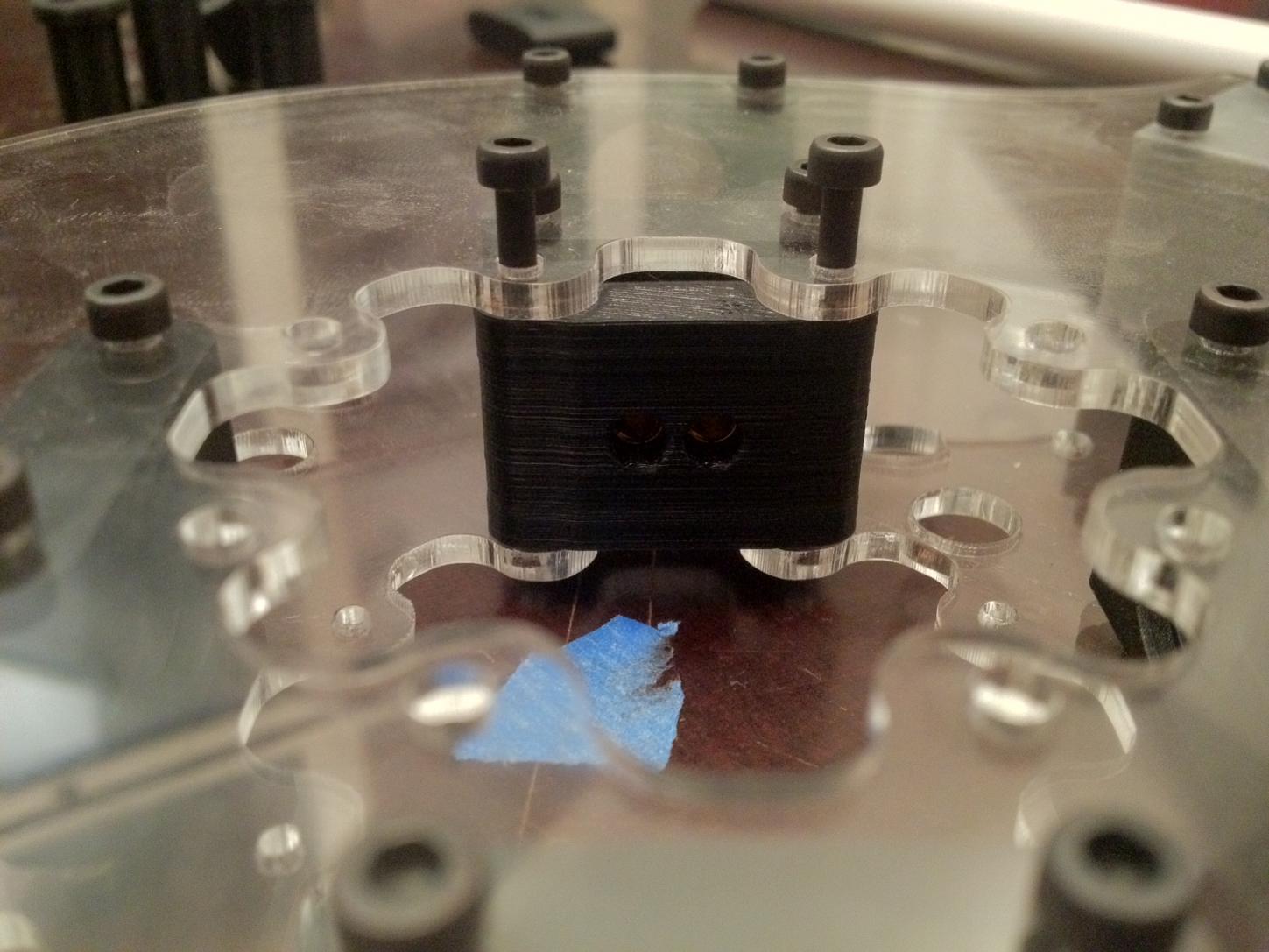

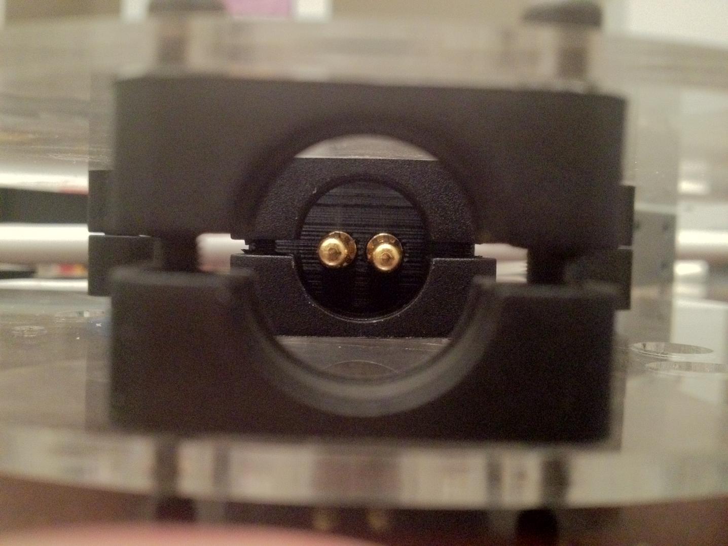

progressing a little.
ESC mounts to the motors mounts. Going to wait until the Ultra ESC 35 A version is available, the layout and size already resembles the Ultra ESC though. 8x Tiger Motors MN 3510 360kv ordered. Nacelles also get mount to the motors mounts.
Vibration mounts seem to work.
View attachment 10011View attachment 10010View attachment 10009
