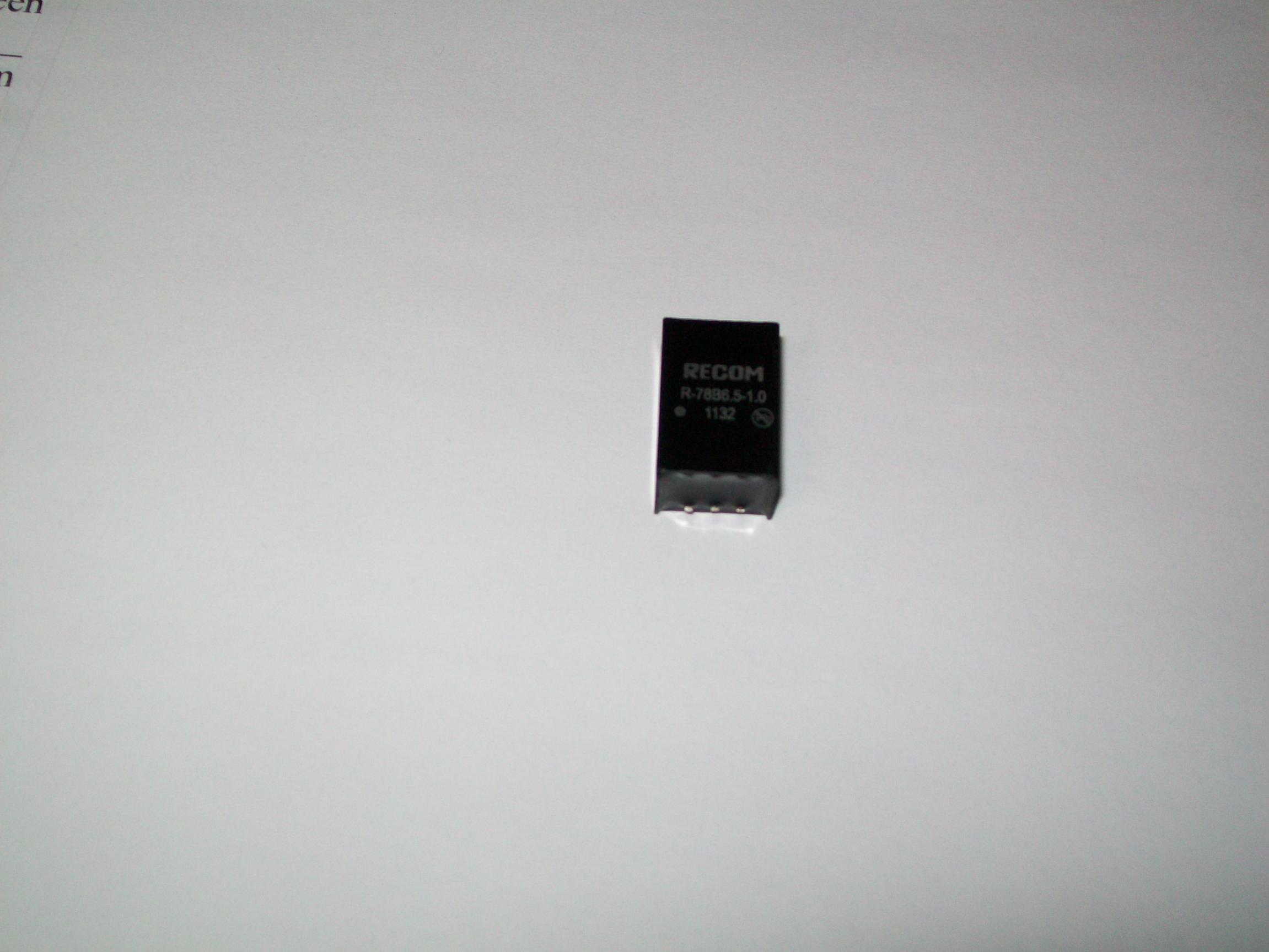

A 24 volt to 6 volt BEC, 5 amp with ferrite ring weighs 24 grams....we just happen to have one.....The installed retracts......

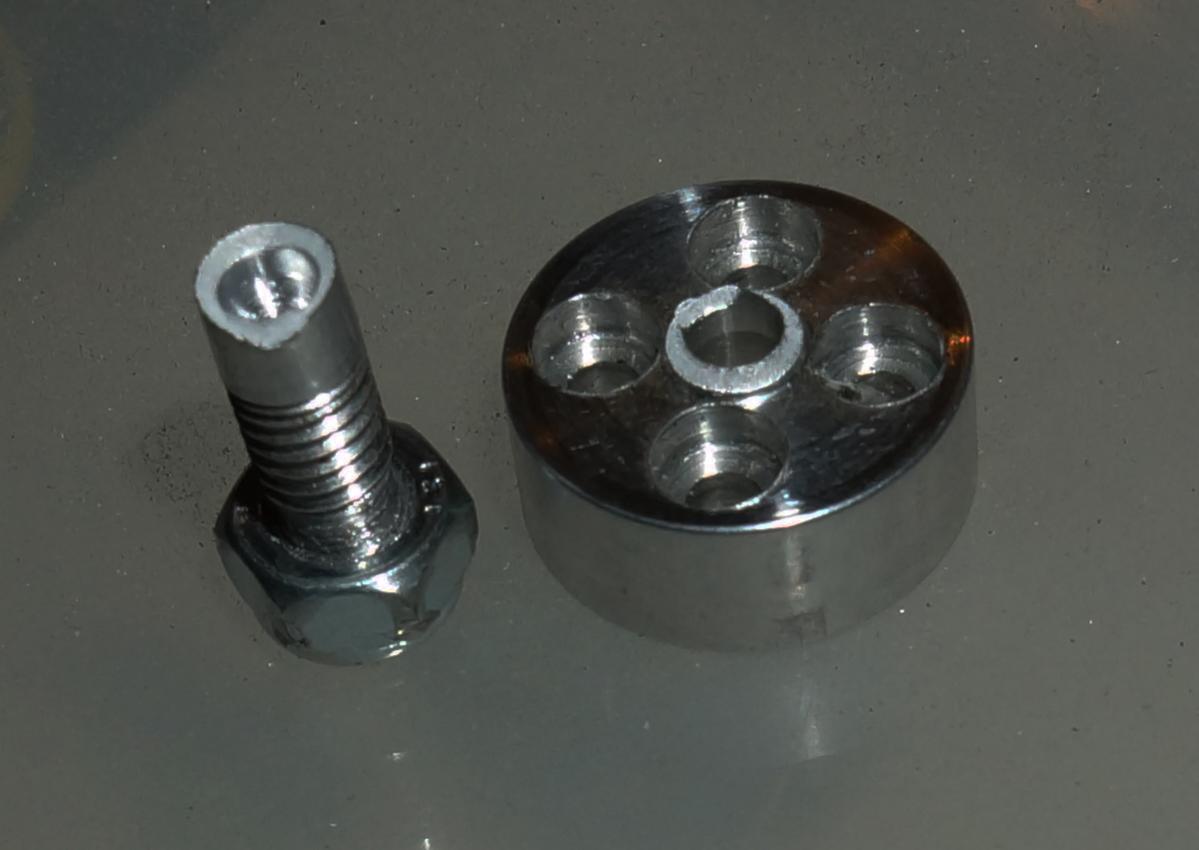

View attachment 7983 The machined spacers 9eight) are used on each attachment point. When you are mounting these, please take note that you will be loosening the brackets that hold the top on and this alignment is critical so before removing the scres, mark the location with a piece of tape so that you can get it back. Aligning the turnbuckles is a bit tedious and requires a pretty good amount of time to get it right.
