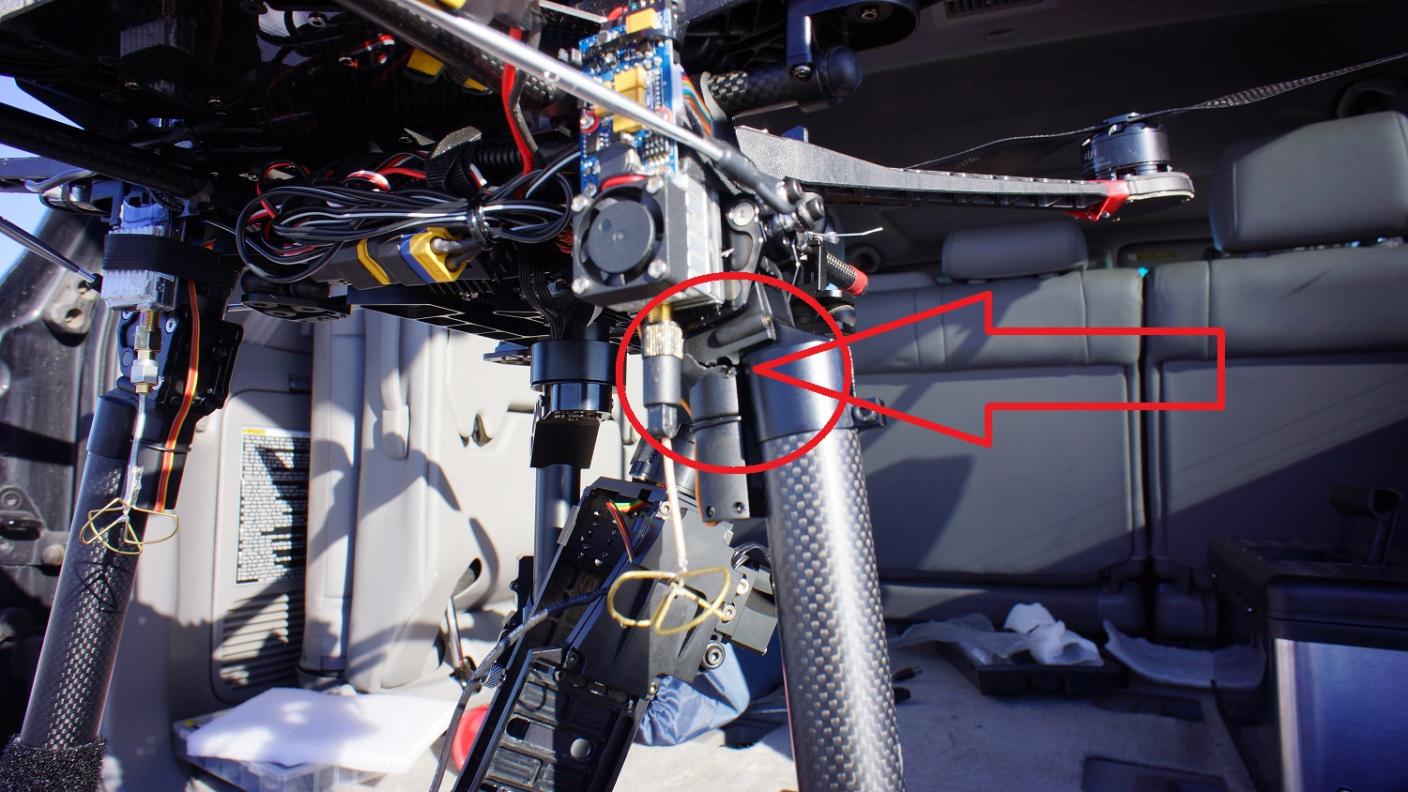

MombasaFlash, I agree the wobbling did concern me on working, but mine did not have any issues retracting and extended. Instead, I flew in a 28 Degree F and after a few retracts and extending, my plastic housing on the servo cracked. I notice it was wobbly, but did know how much more, till I watch it closer and closer and notice one leg was all the way cracked.. though it continued to work.. "wondered how".
This is the results in cooler weather flying.. my suspicion.. I did not have any hard landing..
I did get a fast response from Sang, that is something still worth alot. He was quick and responsive and ask me to wait for the V3. He also was quick to agree with my diagnostic, which was far from my experience on trouble shooting with other vendors.
Only thing, is that since I purchase 2 units, only one was tested in cold weather flight and crack, Sang will replace that unit. But my other unit sits on the desk after I made the video above to show Sang.
And was told that he cannot take that unit back for a V3 replacement. I am stuck with a Secraft V2 that I cannot use in my environment. Only thing :(.. Maybe I will chat with Sang again since I really cannot use this in this weather.

KS,
In your picture of the cracked actuator....Is the turnbuckle shaft bent, where it goes around your Vtx...? I have my turnbuckles adjusted pretty tight and I do not get that "Bounce" that you are getting. It appears that you had to bend it for clearance....of course it can be an optical illusion, from the angle of the photo.
