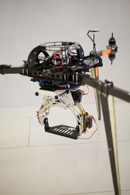

Picture # 1 is the way it was packed. We ordered these on Tuesday and they arrived on Saturday,to late for that day's delivery. They were packed very well and the shipping time from Korea to the states was phenominal.....
Picture #2 is of the box they werei in inside of the bigger box. Everything was packed very well.
Picture #3 is of one of the retracts itself. They look to be made very well and the machining looks as good as anything that we have ever received from them. The quality appears to be there.
Picture #4 is the back side of the retract
Picture #5 is of the group of items that come with the retract order.

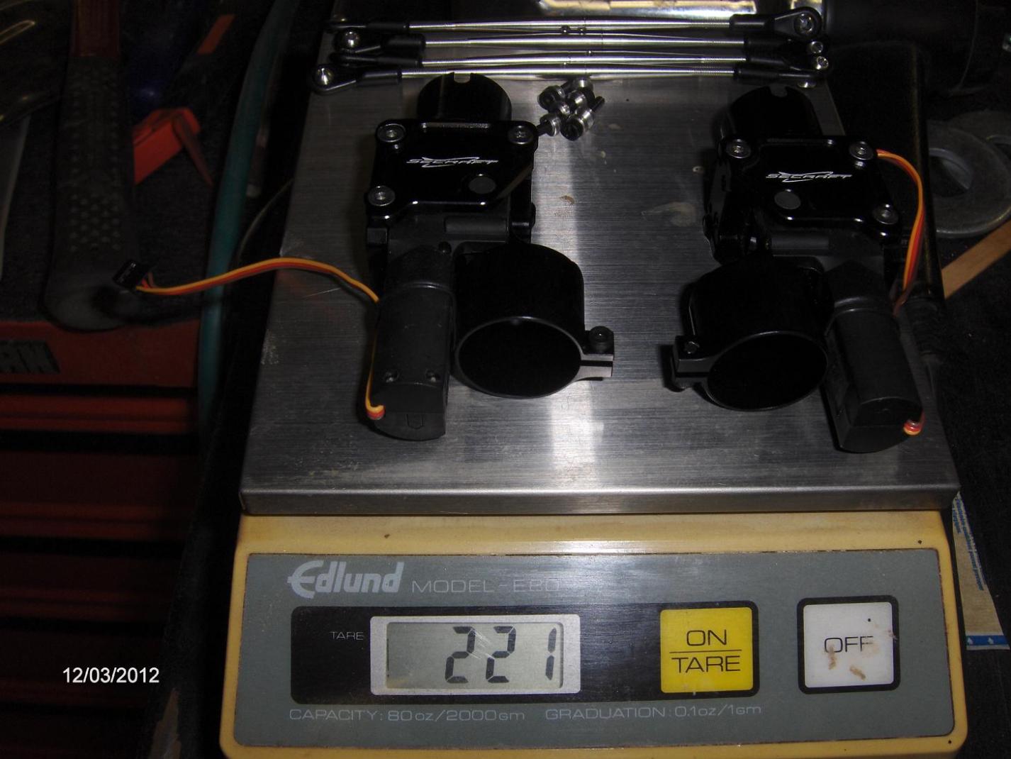

Picture #6 is fo the weight for one retract, which is 98 grams or 3.5 ounces.
We will install these today and will do detailed pictures of the installation. For those of you worrying about the quality, by first impression....I am IMPRESSED and that is not that easy to do. When we get these operating,wil be the true test of how smoothly the operate. Iam actually IMPRESSED that I got the pictures to post on the first try......as I can usually screw uploading something up pretty good....!

The all up weight of everything for the retracts is 221 grams, including all rods, turnbuckles and screws, but this does not take into account the four suspension rods that will be removed from the S800 gear. I will weigh those when I remove them........... So 208 grams sounds about right for the total of additional weight. I am looking forward to getting them installed if I can tear myself away from this computer........

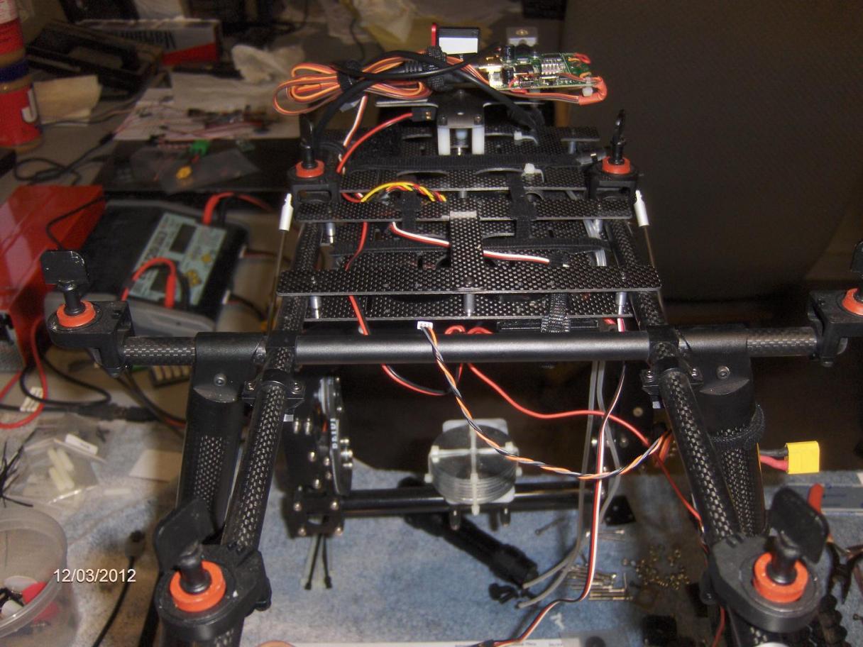

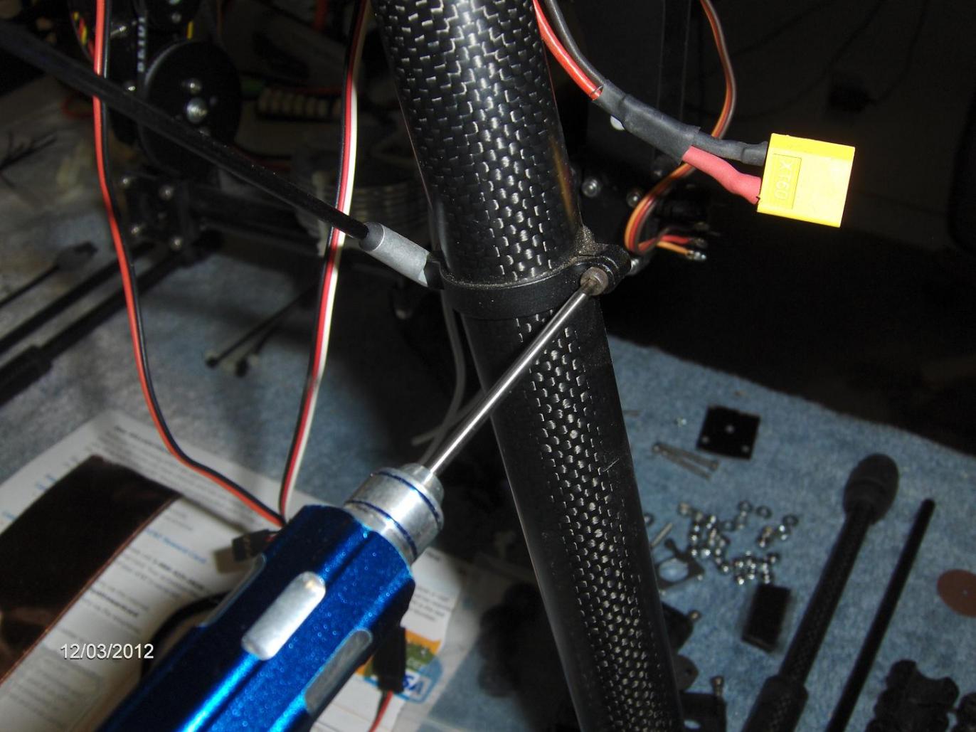

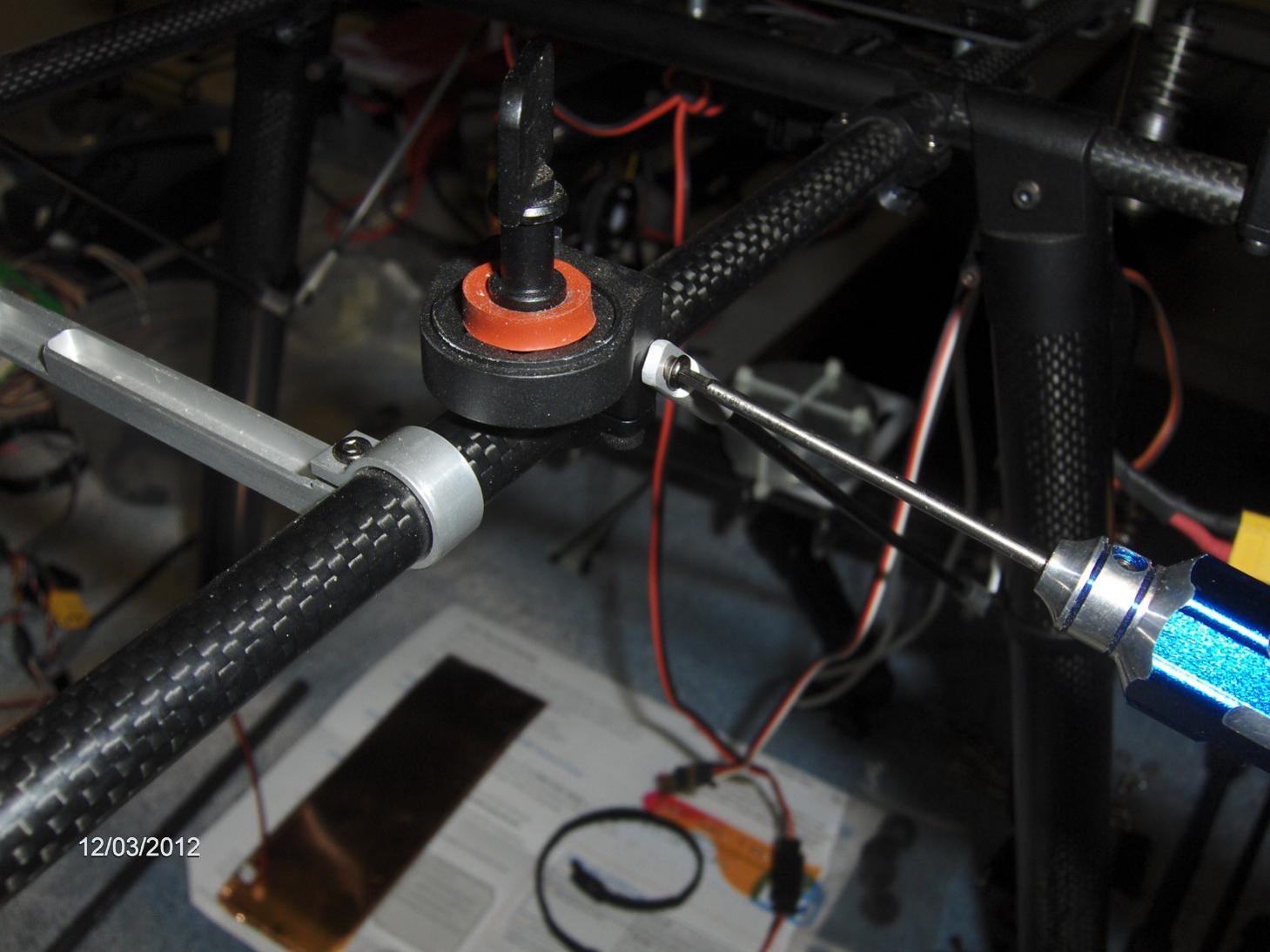

OK....HERE WE GO.........................! I will try to explain all of the pictures as we go......Please ask and I have not tightened anything so i can pull apart, weigh and put it back together.....First let me state there are NO directions with the retracts...so this is a learning experience for all of us........REMEMBER this: the turnbuckels are right and left hand threads. The right hand end is signified by a line etched around the turnbuckle...this is very important and i wanted to get it out of the way first........
heli001
Triple Tree Aerodrome
We have access to certified scales...I know it looks like hell but they are accurate and certified as they are used to weigh Pigment. Anyway, the first two pictures are of the retract system with the turnbuckles...AUW 220 grams......View attachment 7971View attachment 7972

The weight of the stock supporting brackets which is 21 grams....(I feel comfortable with the accuracy of the smaller scales we have in the shop as they agree with the certified ones.
