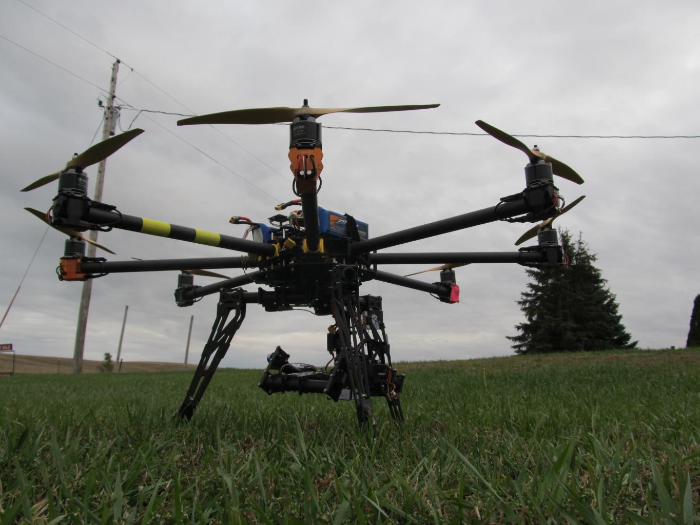

Lost 800 mm Hexa on the second flight. Equipment setup; Spektrum DX8 TX, Spektrum 8000X with TM1000 Telemetery unit, battery sensor, altitude sensor, motor temp sensor; Naza-M V1, GPS add-on.
After waiting for the GPS to lock and getting confirmation with the four green LED flashes my friend launched the new HEXA all seemed normal, in the GPS mode he commented that it was drifting back to him a bit, but continued the flight as it is not uncommon for the Naza to take some time to settled down and really hold position. He flex the Hexa gently as the goal of the flight was to test the run time of the two 4S 4000mHa batteries with the new configuration. NOTE: The config was completely checked and verified twice using the Assistant program, compass was calibrated as well.
About two to three minutes into the flight my friend hollered that he was having an issue. He told me he had lost control of the Hexa, and had thrown the Fail-Safe and it was not responding. He handed me the TX to see if I could do any thing. All the time the Hexa continued to fly like it was being flown, making turns, flying away from us in north east direction when it reached about 1/4 mile at estimated 100ft altitude, it started to make gentle circles, all the while I was trying to cancel the fail safe which never kicked in. After about a minute the Hexa was headed back to our location at a fast rate, and appeared it may be RTH finally. Well it didn't but after returning in the south-west direction it banked again heading this time to the north east and flew into the distance out of sight.
We gave chase and caught sight of it again about two miles from the take off location, this time traveling east, once again we lost sight of it, never to be seen again. Over 1400.00 USD gone....
Everyone I talk to can't understand whether the radio failed, but then again how is that the thing continued to fly. After reading some of the accounts in this thread I believe there is a bug or two in the DJI firmware.
Wouldn't be nice if they came forward acknowledging the program and told us it has been corrected in V2 of the Naza firmware. IMO I don't look to them to do that.
My friend I are now looking from a backup fail safe system. Maybe motor cutoff with parachute deployment via separate radio system.
Anyone else have a tested secondary backup fail safe system.:dread:
